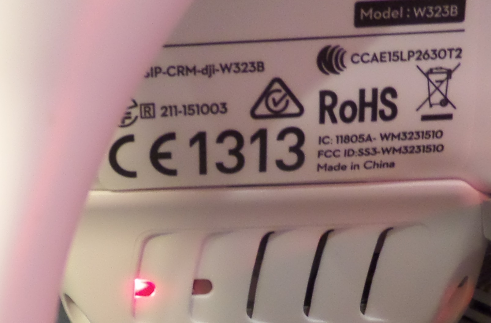

I'm a P3P flyer and have recently acquired a P3P drone needing repair. My goal is to get this drone operating again and use it as a backup should something happen to my primary drone. The appearance of the drone is near perfect ..... but the camera is missing. The plan is to get the drone operating ( verify it will fly) then pick up and add a used camera down the line to complete it as a backup. Problem is, I can't get my current P3P controller to link with the new (cameraless) drone. I've tried the DJI GO app linking option, the C1 + C2 + Record button option to no avail. Is there a way to update the firmware in the drone (to match that in my primary drone) without a camera being added ? Any other ideas on linking options will also be appreciated.

Does the linking light illuminate on the second drone when trying to link it?
Thank you KD and 3rdof5 for trying to help. Yes, the linking light is illuminated red when just the drone is powered on. The landing lights are solid red in front and blinking fast yellow in the rear. When I turn on the transmitter the linking light on it is also solid red. If I watch the linking light on the drone carefully it stays mostly solid red but does blink green briefly every few seconds.
I've looked carefully at the camera connections on the working drone .... and it doesn't look like a difficult job to swap it over for a trial .....unless it is obviously another issue.

Yes, the linking light changing color briefly shows that it wants to link but doesn’t.
