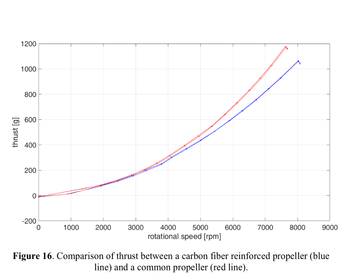

Whatever the aftermarket props are simple fact is that the max horizontal speed of your phantom is governed by tilt angle which is limited by the flight controller. To the extent the aftermarket props were producing greater thrust the flight controller would simply feed less power into the motors.
Reality is your aftermarket props are inferior to OEM. Below is actual thrust measurements of DJI OEM vs aftermarket 9450 style props on a test rig at various static RMP intervals.
