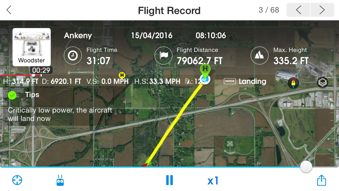

Heres a good example on my last run cause I landed at my feet @1%. So you see what kinda distance you can do! Its stressful & you have to steady up on the ascend stick bout half way to maintain altitude but you can usually pull off a mile. In your case my first thought was "he coulda made it" but it was in the dark and its harder to guide in on autoland in the dark even when youre used to it[emoji41]
When its completely clear that there is no way your gonna make it to your feet, you have to make a emergency landing, most the time if you would just be realistic and sensible instead of being frantic,
you will be able to land it in a clear safe place , camera facing down, a nice smooth slow autoland[emoji41]

No effin way!:eek: A mile! wow, yea im a tool. :confused: i could've def made it then.
I've read about people landing at 1%. just not to clear about that 10% to 1% a/c behavior.
When i got to 10%, in my head it was a 50/50 decision.
a part of me thought- go for it. there is a baseball field next to my house. can land there.
the other part- dont do it, play it safe. its my first time coming in 1,700' short at 10%, im 130' high, and there are a bunch of houses & roads coming up, what if i cant maintain altitude long enough to clear them.. she gonna start descending and will def clip a roof or two...
so i stopped, backed up a little and let her autoland herself. i pointed the camera down but it was pitch black and i couldn't see a thing.
thanks for sharing the screenshot, now i have a better idea of what i can expect.

Both critical and warning are as low as it can be set. You can keep the stick up to keep from landing but it chews on battery power thats why its best to be already up above 300 ft when critical hits. Then it can coast down a little on its own.
You did the right thing this time NJ, if your gut has ANY doubt at all then ALWAYS play it safe and fly again later. Plus I was goin 33 mph you was goin under 20[emoji41] big diff!
