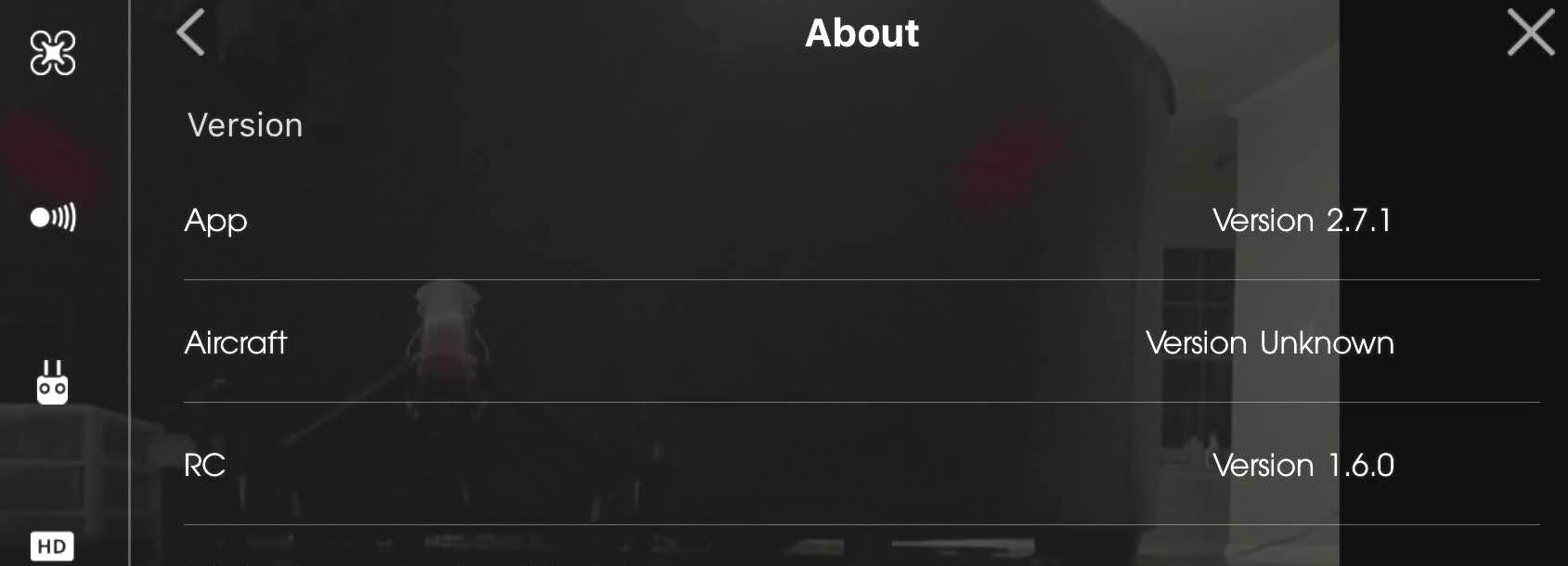

Updated firmware, and all seems to be working fine, but I noticed this in the app. It shows up fine in the assistant sw. Is anyone else seeing the same?
