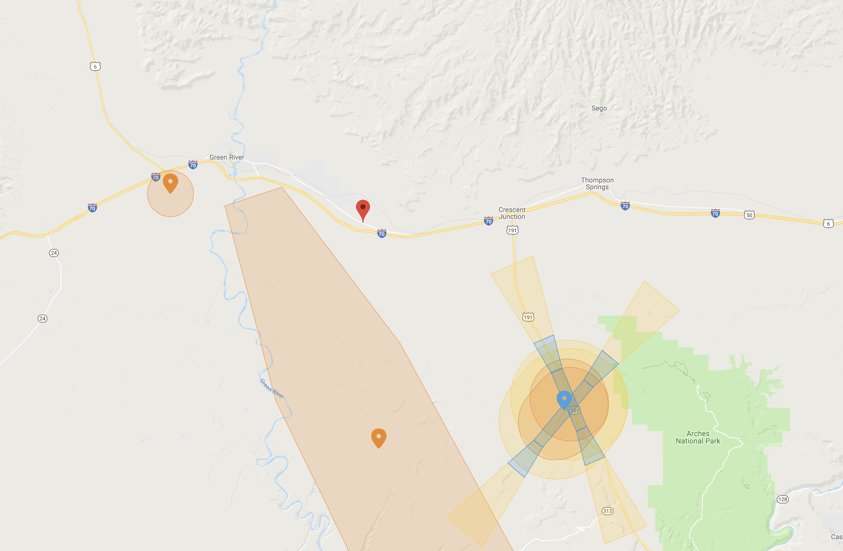

I've not tested it but I'd guess there's no way the DJI geofencing would permit you to fly within the Lat/Lon box no matter what the altitude restrictions are. Many controlled airspace regions are not rectangles or circles and have more complex shapes but the DJI geofencing seems to create either a circular or rectangular no-fly zone based on the furthest NW and furthest SE extremes of the airspace. I wanted to fly east of Green River Utah to catch the Amtrak Zephyr train but the DJI Go app said I was in the R6413 special use airspace even though I was more than three miles east of it. Turns out the R6413 region is maybe 11 miles further east at its southern end so even though I was outside the region the Go app apparently doesn't store that info at the detail level of the region and instead just creates a rectangle based on the furthest extremes N/S and E/W.
I can guess it makes the data more compact and testing a current location against a simplified rectangle or circle is less CPU taxing than doing so using more accurate coordinates for the region.
In case anyone is interested bring up AirMap and go to Green River Utah and you'll notice the R6413 region that extends just south of Green River and you can see how the shape is neither a circle nor a rectangle. Where I was trying to launch was at: 38.9364, -109.9919 and this is more than 3 miles from the closest boundary to the R6413 region. If you notice the furthest extremes of the R6413 extend further north and east than my location so that's why I think the DJI geofencing simplifies all such regions into the most inclusive circle or rectangle as that requires the least data and makes it easier to test. It does, however, produce many false violations.

Are you using the latest firmware and DJI GO 4 app? The new DJI geo system resolves restricted areas much better, and that location is outside R6413.
I have the latest firmware update, but when I tried this it was last March so it was probably with the firmware just prior to the current version.
One problem, perhaps, is that DJI's approach to updates is kind of potluck where somethings are updated one way but other things another way. My last trip in early January of this year I had verified the firmware was up to date before leaving because I knew I would not be in cell coverage for most of the trip, but when I fired up the drone and app I got a message about updating the database (not sure the language used) but I was not in cell coverage so I had to blow that off.
Do you know if the update is the firmware or the geofencing database or both?
It would be nice if the update handles restricted areas better, but I think you can see from the map you linked that my launch location was outside R6413 by more than 3 miles, but within a larger rectangle defined by the extremes of N/S and E/W.
