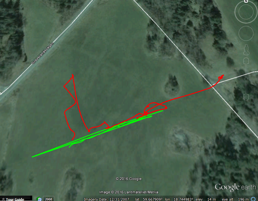

Does this look like the right flight? The red is the location of the P3. The green is what the P3 thinks is the location of the RC.
I've attached the .kml with .txt extension. I.e.change FLY075.kml.txt to FLY075.kml and view it with Google Earth.
Lemme know if this is the right flight. I'll want to look some more at it when I know it's the right one.

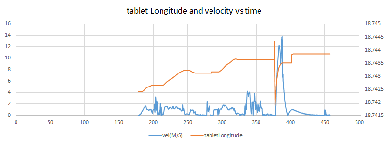

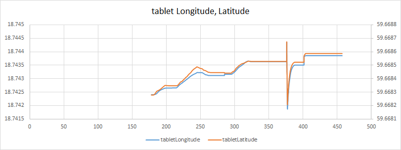

Viewing the tablet location in Google Earth doesn't convey the abrupt, unrealistic change in location of the RC. Plotting the tablet longitude and latitude each against time looks like
Clearly, this abrupt change is an error.
For fun, I plotted the tabletLongitude and velocity
This shows the P3 racing off as a result of the RC location error.
Reactions: AndersGB
Looks like you have confirmed this wasn't a Phantom error but a tablet GPS location hiccup. The Phantom was dutifully tracking the reported tablet location as requested. I assume the Phantom's data file records the RC location & that's how you were able to plot it on the graph?

Yes, the RC location is recorded in the P3's .DAT file. But, only during a Follow Me mission. If the DJI Go App is being used the RC location gets recorded in the binary part of the .DAT. If, instead, a third party app is being used for the Follow Me mission the RC location gets recorded in the eventLog which is in the text part of the .DAT file.
Now that is pretty cool. I have to say the P3 has some sophisticated & impressive data logging features! Worthy of Boeing!
Sorry, I've been sleeping, I'm in a different time zone. :)
Yes, it is the right flight. The green RC location lines to the left of my starting point (below the red starting point to the left) are incorrect.
Many thanks, very informative graphs!
So the P3 recorded an RC location far to the west (incorrectly) when I initiated Follow Me, and then it got a correct RC location when the mission had started and thought it was far off and should go to to the east. And crashed into the tree.
So the probable cause is that the P3 got an incorrect GPS location from the tablet for the Follow Me mode in the exact moment as the Follow Me mode was initiated.

However, the strange thing is that when I look at the flight in my iPad (I click the actual Flight Record in my iPad and then I can watch the whole flight mapped on Google Earth, with the P3 and the RC) the RC is mapped in its correct position the whole time, it doesn't go away to the west suddenly. I don't know how often this information is sampled but this information indicates that there is a probable P3 error when recording the RC position when initiating Follow Me. What do you think?
If the P3 got an incorrect tablet location to the west, why would it shoot off to the east. I am wondering if the false location was to the east way off the map. If you zoom out of the map are there any green dots to the east?
