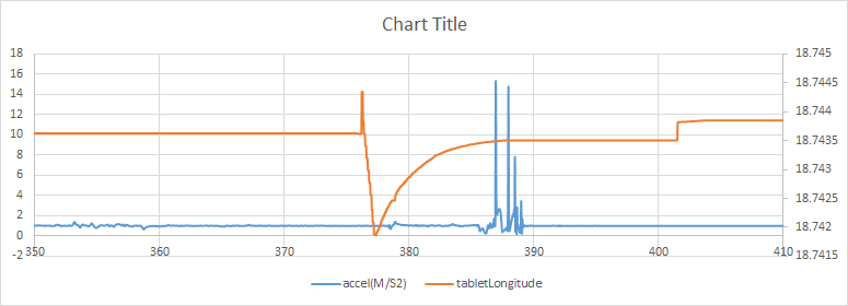

If the P3 got an incorrect tablet location to the west, why would it shoot off to the east. I am wondering if the false location was to the east way off the map. If you zoom out of the map are there any green dots to the east?
If it got an incorrect reading far to the west, when I initiated Follow Me, and then suddenly it got the correct reading, to the east compared to the starting point, the P3 assumes the RC has moved to the east and goes away to the east to accomplish the Follow Me mission.

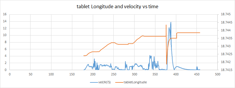

Viewing the tablet location in Google Earth doesn't convey the abrupt, unrealistic change in location of the RC. Plotting the tablet longitude and latitude each against time looks like
Clearly, this abrupt change is an error.
For fun, I plotted the tabletLongitude and velocity
This shows the P3 racing off as a result of the RC location error.
I've been studying your great graphs some more. The time scale, is it in seconds? It looks like that, it took about 10 seconds from initiating Follow Me until it crashed into the tree.
I think it is odd that the latitude and longitud is changing so slowly after the glitch at the start of Follow Me, it takes about 10 seconds before they are close to the correct values. But ok, it might be the tablet's GPS values that takes some time to establish. Do you have any thoughts about that?

The time scale is in seconds. The RC location is a 15 HZ signal. This plot shows the RC longitude and the total acceleration. So, yes it's about 10 seconds from the glitch to the crash
It's hard to say why it takes so long for the RC gps signal to return to correct values. One possibility is that it is being "smoothed".
I would guess that it's not possible to retrieve the RC gps signal from the .txt produced by the Go App. @msinger and @ferraript are both working on .txt converters. You might ask them.
