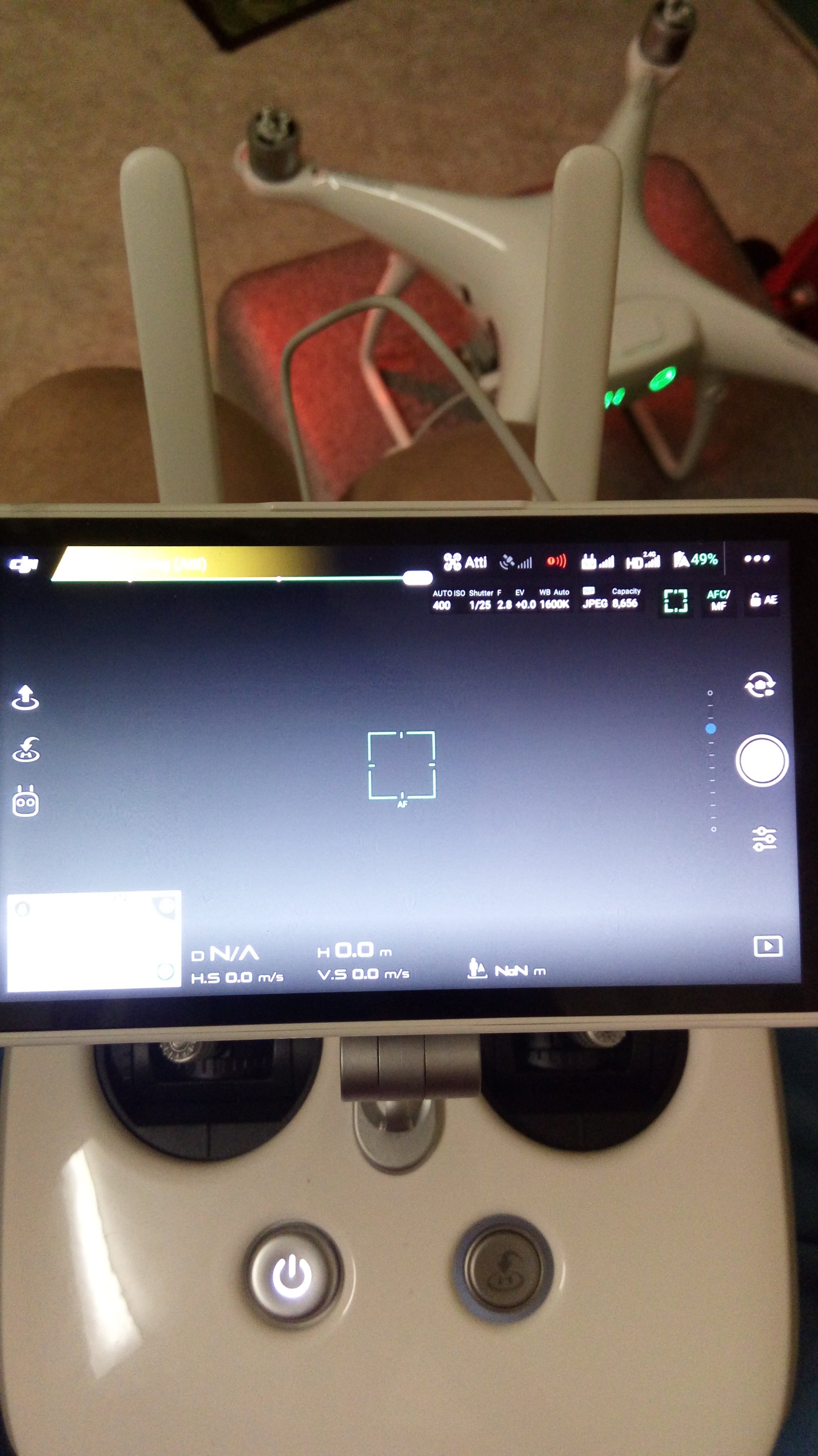

Hi guys. Just wondering if anyone could give me an insight. I’m unable to swap between the video and photo ability on my P4P+. I’m tapping the icon on the remote but with out success of swapping between the two functions.
Pls help if your able too.
