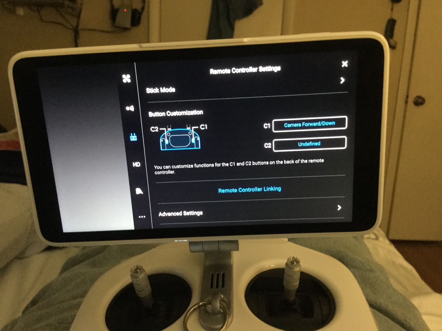

here you find what is my problems with this f*** drone...

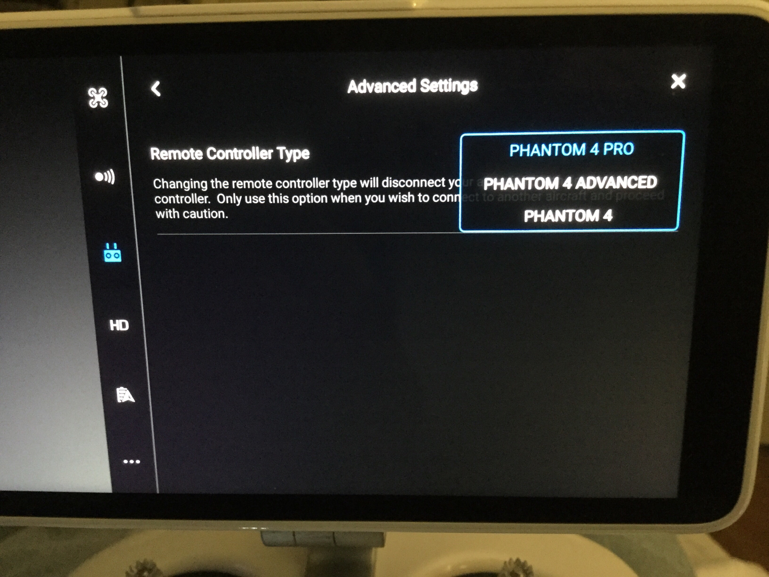

You are not linked! Relink rc to drone. Go into advanced settings, on screen RC, you might be trying to link to wrong model. Pick the correct model pro, adv, p4 the shut down restart and link.
