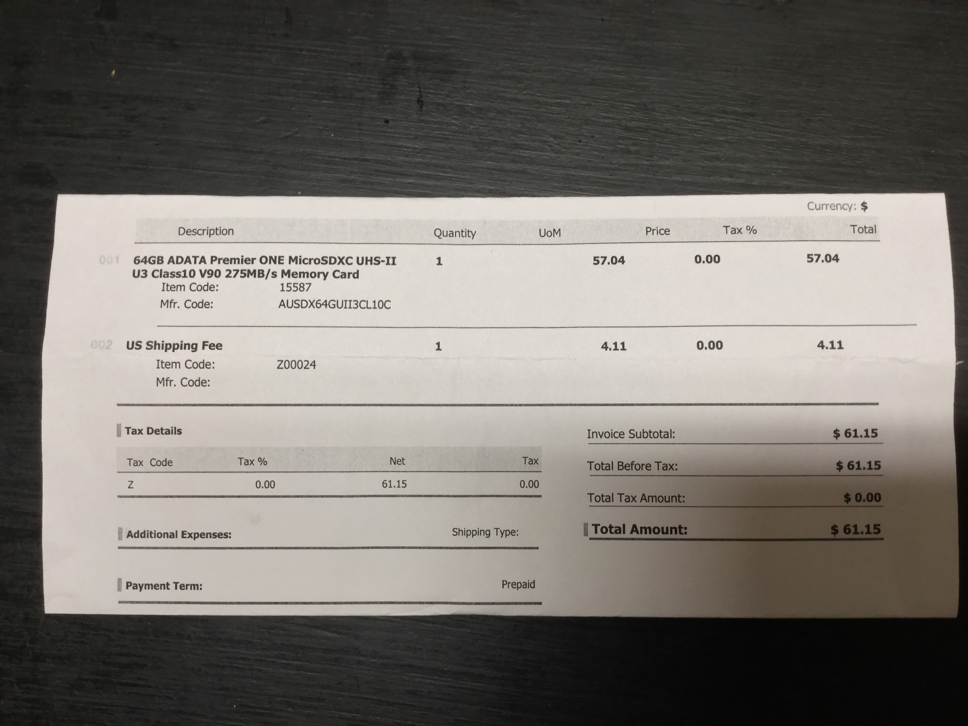

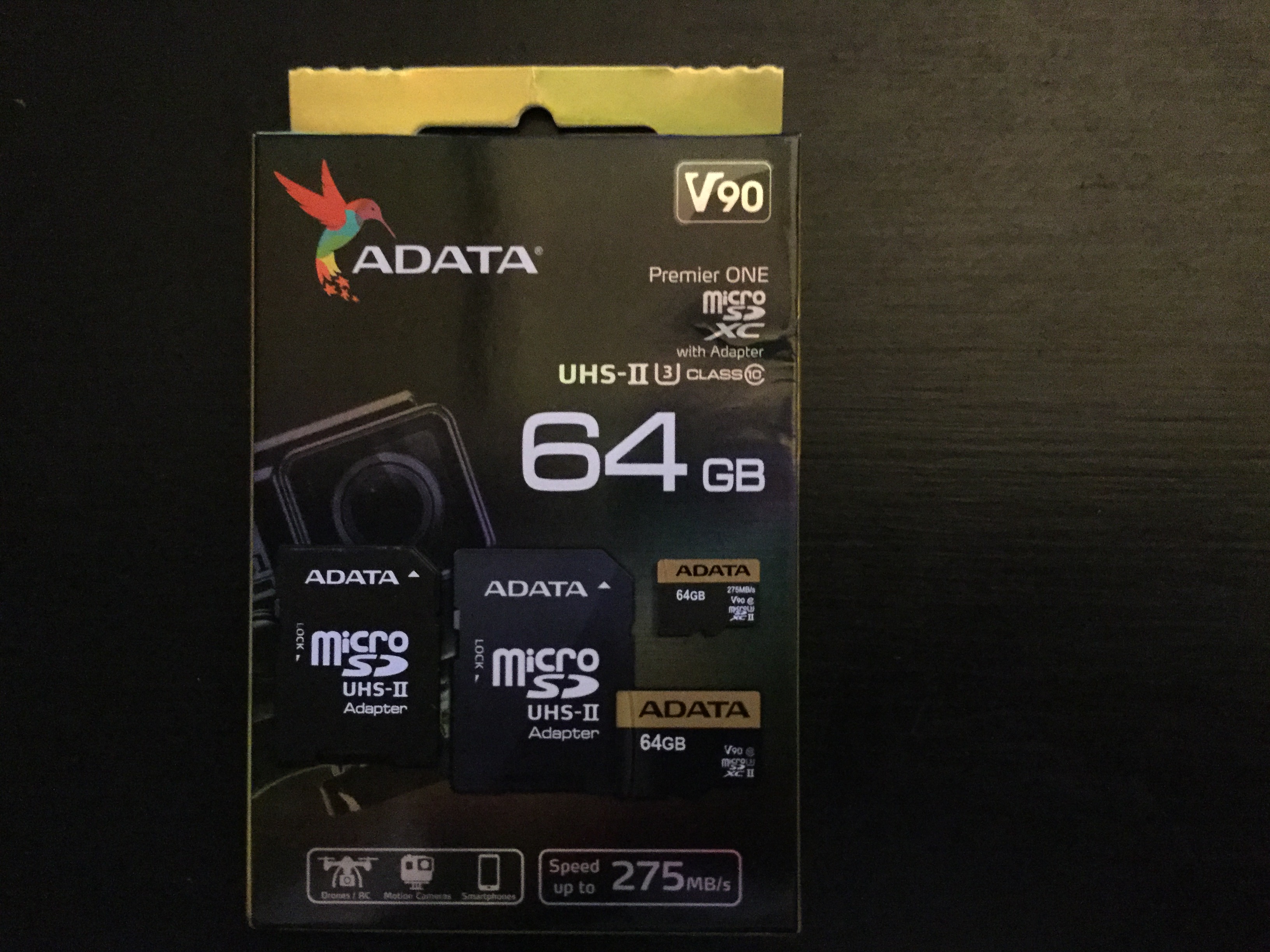

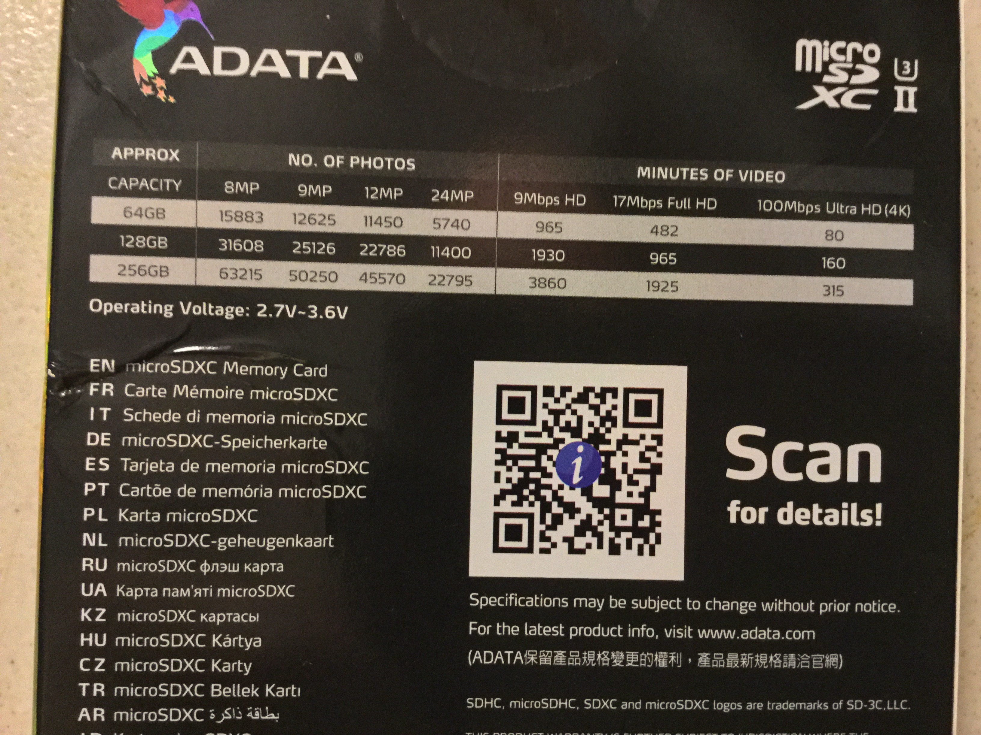

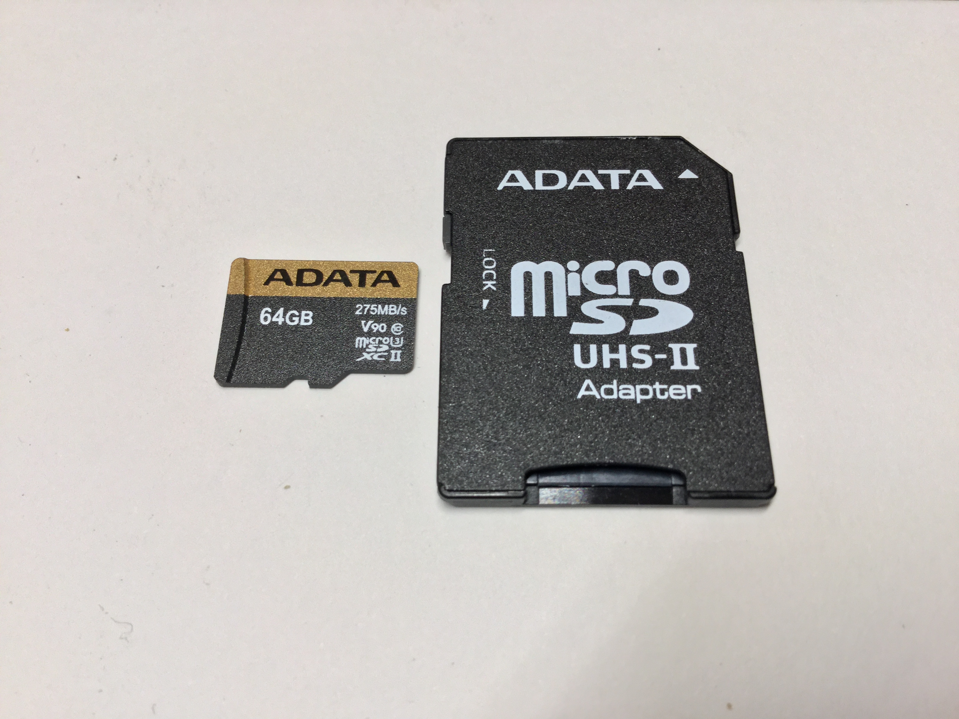

Really..Really Fast SD card..check out the specs..Premier ONE microSDXC UHS-II U3 Class 10 | ADATA Consumer

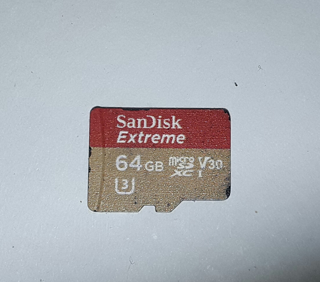

Yes I like the price too,got this while back $$100 NZ dollars, gave me a fright some were more expensive but this card works hard,never let me down,lost it once , refound it,phew,good to see Packet got drone on it so must be good,View attachment 104115
We’ve been using the SanDisk Extreme micro SDXC 64GB U3 V30 - A1 app performance up to 100MB/s (which is only slightly different to ianzone’s photo above) - since we started. It’s worked great. Currently £20.99 on amazon.co.uk.
Yes, it's fast.
But does that matter and will it even work in a Phantom?
The speed the Phantom's camera will write a file to the card is what matters, not the speed of the card.

Read the specs..not answering any inquiries about compatability..It works fine on my Mavic Air and both of my Phantom 3 Standard aircraft..
Yes, compatibility was addressed in the post after mine.
But it's the fairly slow speed that the camera in the Phantom writes files that will determine the speed when you use it in a Phantom.
You've paid for speed that you won't get..
The objective is to allow each aircraft to Maximize the write or read to and from the card at its own speed without any hinderance from the card..Remember that I also use this card on my Mavic Air which reads and writes much faster than the Phantom 3 Standard..ONE CARD DOES THEM ALL..Worth the money to me..One card does them all..

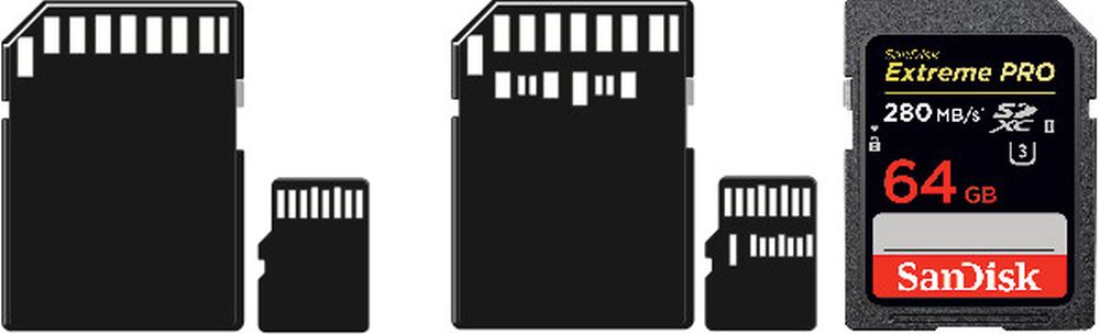

The quoted spec on SD cards is getting quite complicated and the claimed read/write are usually for the maximum sustained speeds in an ideal situation. However, the card in the OP is shown as a UHS II, but you will need a UHS II host bus to take advantage of any super fast speed, as the SD card contact points are completely different.
The following image shows the different contact on a UHS I bus card and a UHS II bus card. There is an additional row of contacts which allows for more data lanes and therefore a faster transfer speed.
The maximum read speed with a UHS I bus is 104 MB/s, while the UHS II is 312 MB/s, and the latest UHS III bus is 624 MB/s. All these cards are backward compatible, so the UHS II card in the OP image can be used in a UHS I host bus, but only at a maximum read speed of 104 MB/s.
The Phantom certainly doesn't have a UHS II bus and there aren't many laptops/PC in the consumer range that have a UHS II bus controller, so I don't see much benefit at present for a UHS II card. I have a GH5 camera which takes a UHS II card, but both my laptops only have a UHS I bus, so I can't get anywhere near the transfer rate on my laptops that I can achieve in the GH5.
