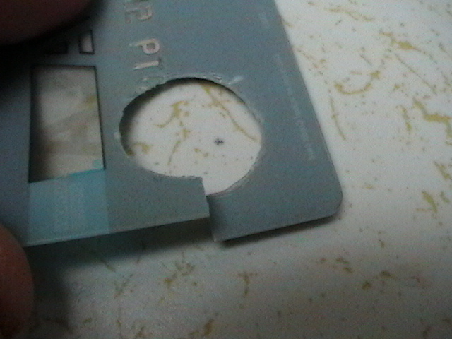

The chip in the rim of the drum is OK IF, it is in the back area of the drum's "working" range. In other words, if the chip is not in the front zone where the ribbon cable bracket is located on the front of the drum. I have an old credit card I cut a hole in that I use to fit in between the bottom edge of the drum and the space left over above the 2 tiny black sensors. I use it as a protective shield to keep from chipping the drum magnet when separating the 2 parts. I ruined several good drums before making up this simple tool. I used a hole punch a diameter slightly smaller than the drum, just enough to fit around the motor poles. It's not needed reassembling the 2 parts.
