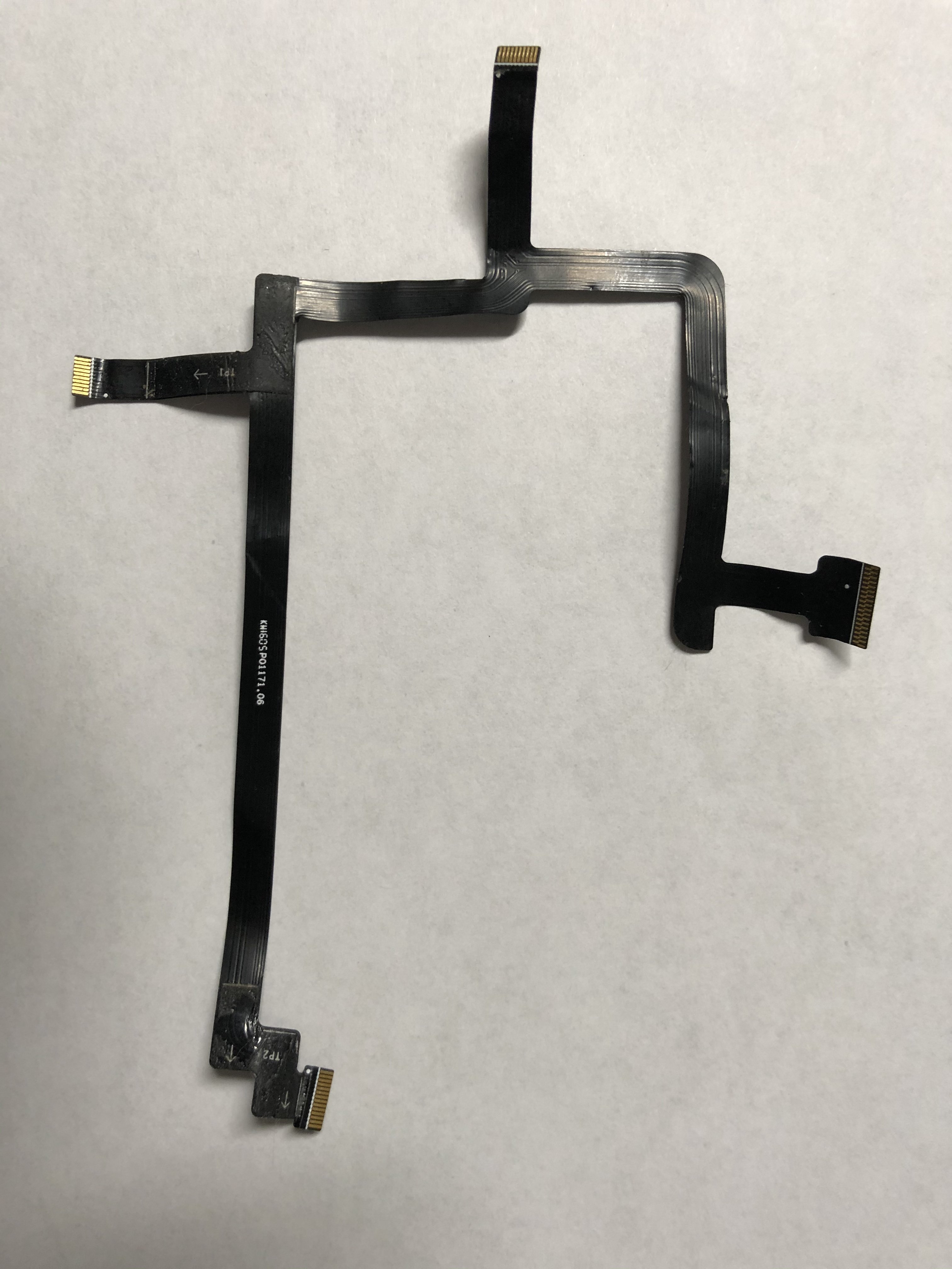

Well I replaced the flex cable and the camera is still limp but I do have video. In fact it’s worse than before. With the original cable if I shook the AC gently the camera usually started working. With the new cable I get a gyroscope error.
Looks like I’ll be returning this cable back to Amazon. Not sure if I should try another cable or just put my original one back on.

Hard to tell if it was an original part - there was no DJI packaging or logo, just a reuseable static bag and a sticker saying the seller was an original DJI vendor.

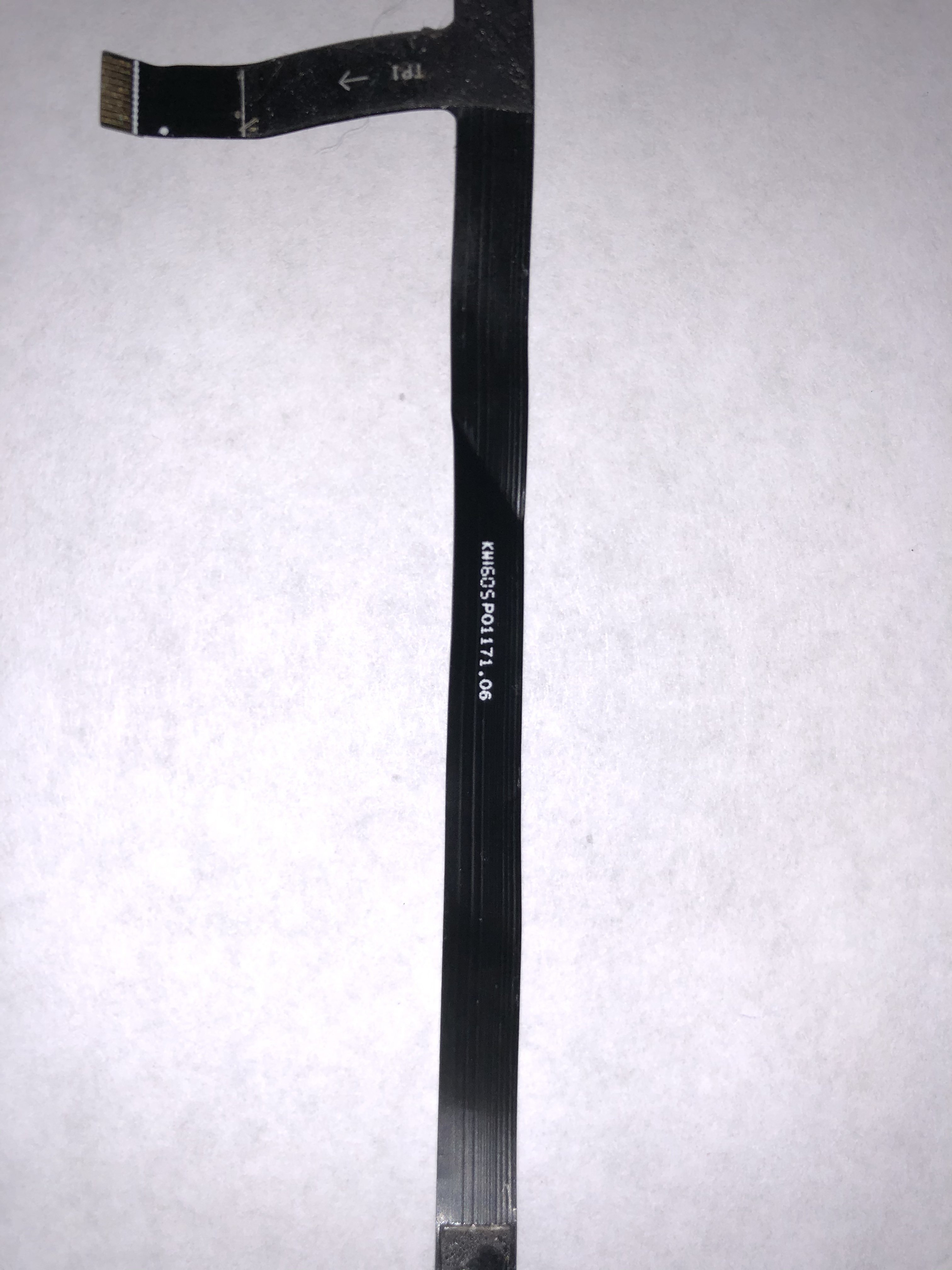

Here are pictures of an original DJI cable from a phantom 3 standard. B533F24F-1DEA-4FB3-B10D-61C788778C8F.jpeg

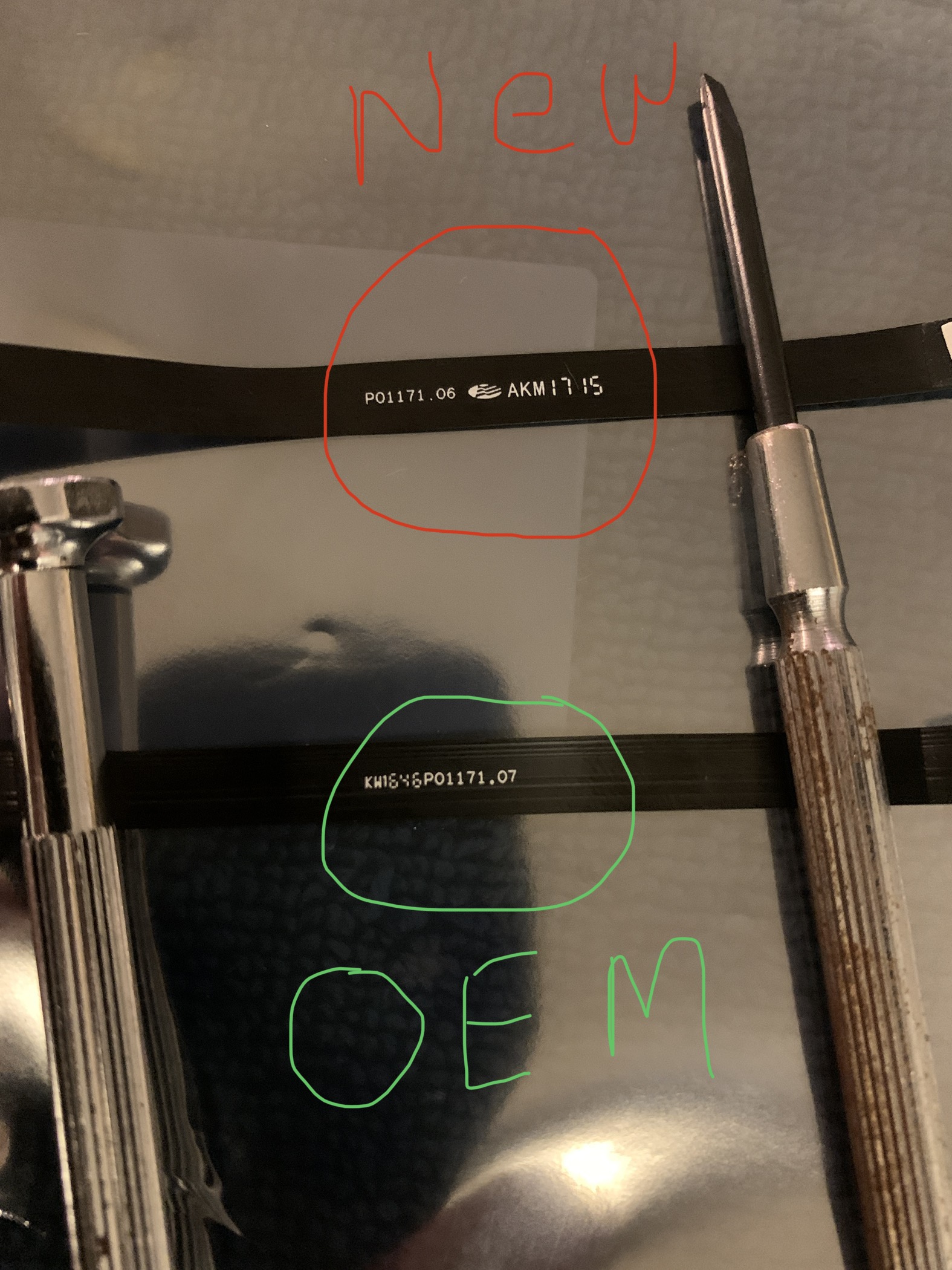

I had purchased a cheap cable from Amazon to replace this one which didn’t work. The first 6 digits were not on the cheap cable. The replacement DJI cable that I got has identical numbers on it to the original one.

I compared the numbers on both cables and to me it seems that the new one is not an original cable. See image below.
Yep, looks like the replacement was not DJI.
