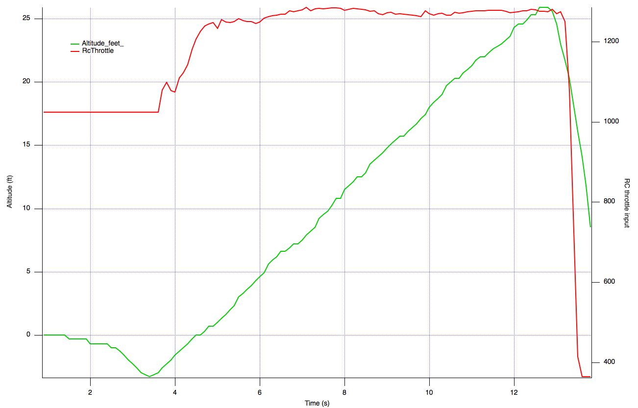

The first graph below shows altitude and throttle position as a function of time. You will notice that it climbed until 12.7 seconds and then began an uncontrolled descent. At 13.1 seconds you applied full down on the throttle, but that was after the event.

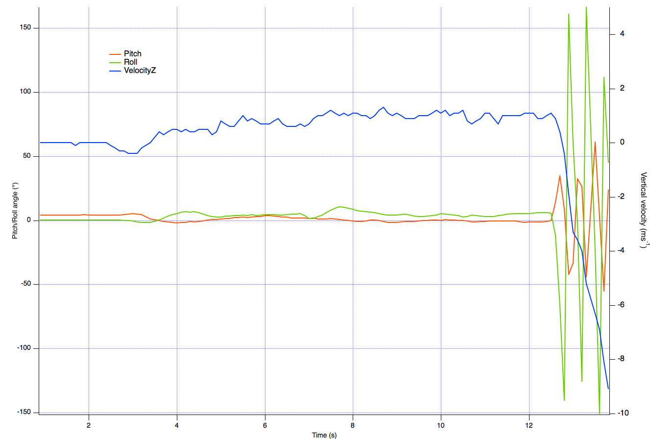

Looking at the pitch, roll and vertical speed data (below), it appears that at 12.5 seconds it went into uncontrolled oscillation with a period of 0.4 seconds. That's typical of losing a prop, so are you sure that the motors stopped?
One more thing to add here is that the AC began to rotate CCW which is consistent with a leftBack or rtightFront propulsion problem.
Your plot shows an initial pitch up and roll left which is consistent with a leftBack propulsion problem. Was the leftBack prop broken or missing?
