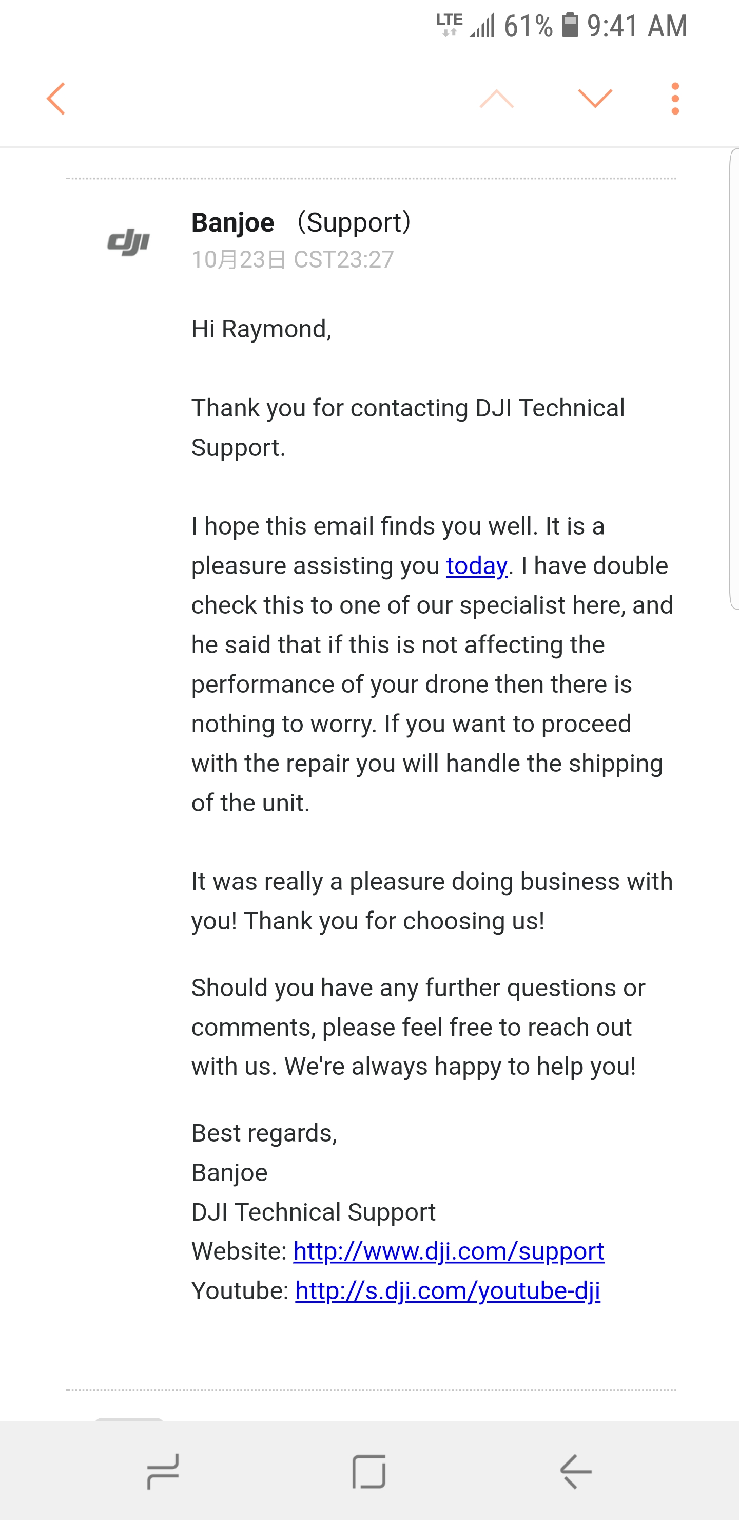

Basically saying, so what if something is loose inside, if its not affecting anything and you still want it fixed under warranty then you're paying the shipping. Great service!!!!

So clearly that's not going to happen. Next question, should i even worry about whatever it is rattling around inside? All the buttons and sticks are solid. Nothing feels like its letting go or has come loose from their internal mounts. Is it worth taking apart or could that just potentially break something else?
