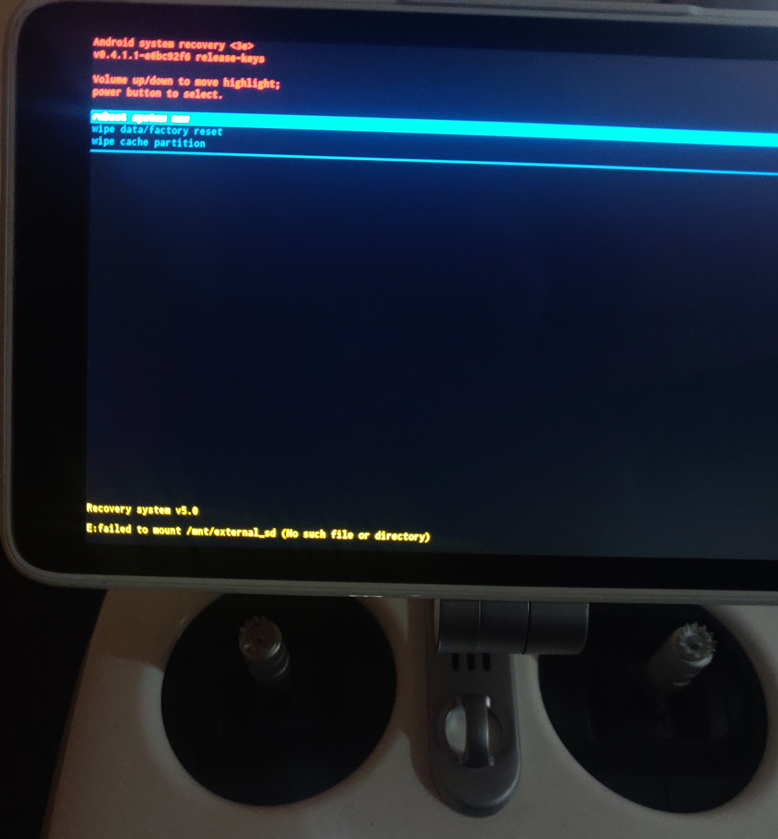

did you find the stock dji rom, mine stuck at the android recovery, i was updating the firmware but it got stuck

I was updating the rc firmware, it stopped in the middle and it started showing android recovery screen as attached. Can you send me the dji stock rom or the image so i can recover
