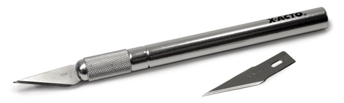

Rubber absorbers were already set up according to what you said. I do have a Dubro style prop balancer from when I used to fly toy grade Syma's but I noticed just now that the metal rod is slightly bent so it won't give any accurate results. Do you happen to know where I could buy just a simple metal rod with same girth/width?

I've used an x-acto knife handle a few times in a pinch. Maybe give that a try for now if you have one around the house somewhere until you get a new rod.
