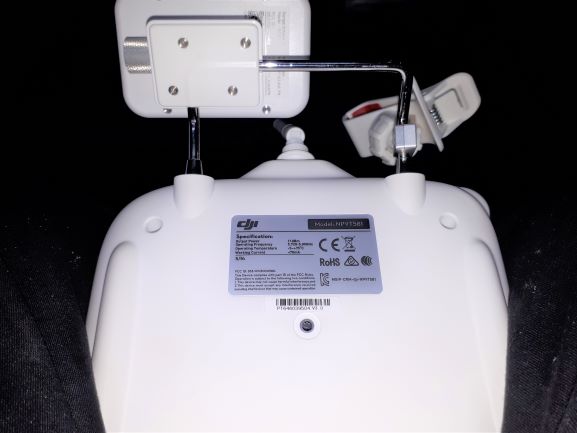

The biggest problem you may have is that the phantom RC’s don’t have a trainer port (where the 3.5mm plug would go)... I use the realflight SIM with spectrum and futaba remotes I have, they also supply a controller (dummy remote) to work with their software. It also good- Phoenix I have heard is likely equal or better however I’m not familiar with it.

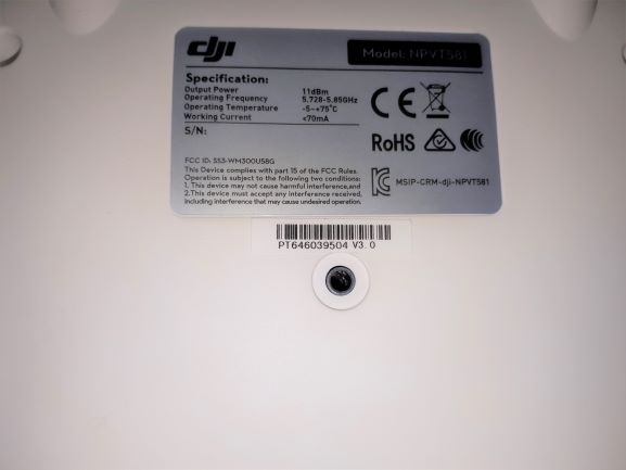

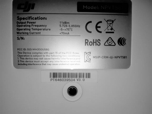

This is the underneath of my Phantom RC.
Aussie Paul. :)
While I see that the port might be able to carry the data I have my doubts that the DJI Tx will give the right protocol to work with the Sim. I hope I'm wrong because it would be awesome using your DJI remote with the Sim.
