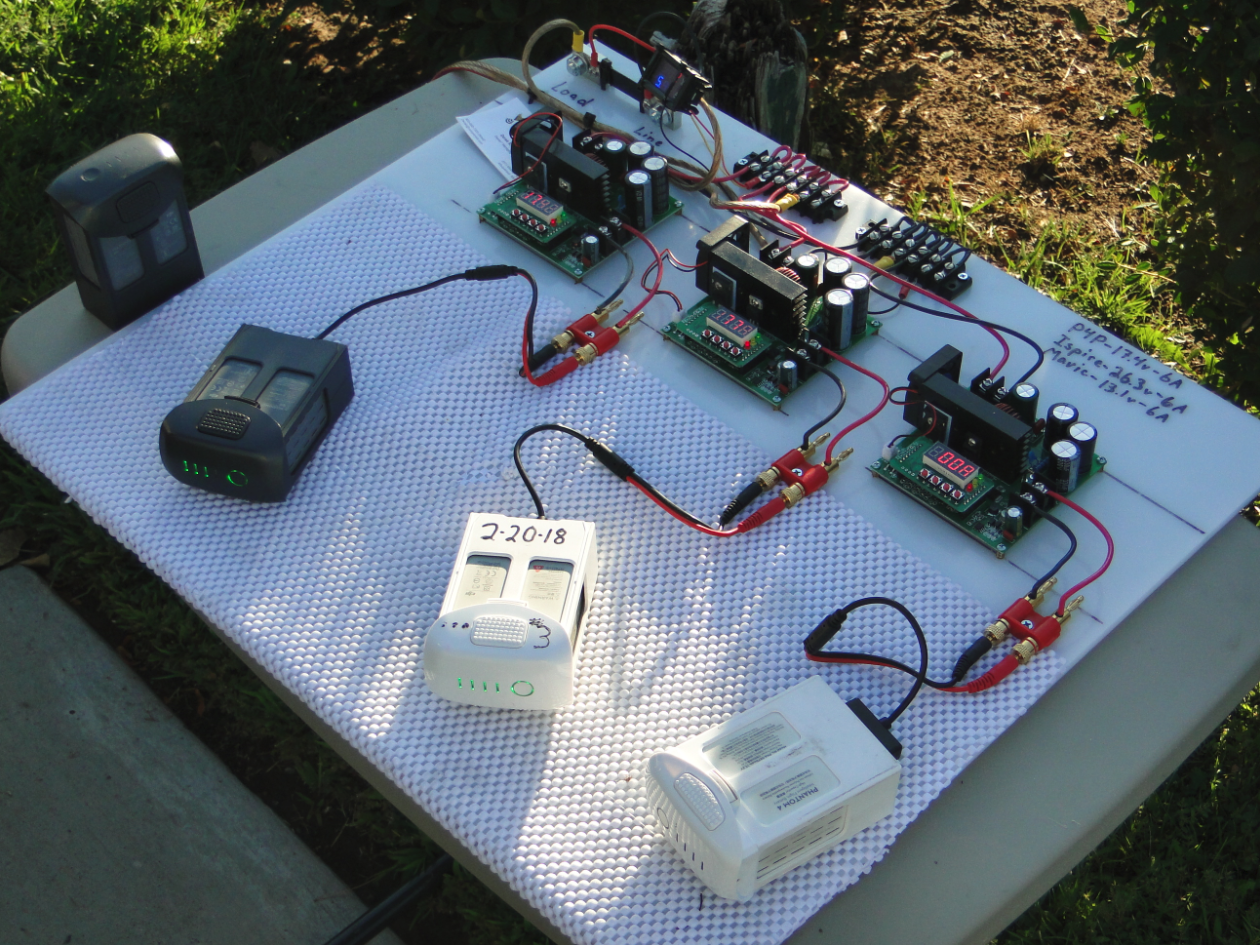

@Harleydude, That’s a sweet setup! May I ask about your setup for charging? I’ve got a 12V battery with a DJI car charger adapter, which will bring a flight battery to about 80%, and a li-po car battery jumper (“Trekpow” brand) which can charge one battery. It they take about 2 hours to charge (usually longer). This can make it difficult for keeping up with the demand.

Well...in the above photo we were using my business partner's truck. He has a 3,000 watt DC/AC converter. So we just plug normal high-speed chargers into it. When I'm flying on my own, I use a charger I built.
Each one of those step-up converters is rated @ 900 watts. To put this into perspective, I normally charge the batteries at 100 watts if I have all the time in the world. If I'm in a hurry (and I usually am), I charge them @ 180 watts. Because I can change out the pigtails and adjust the output voltage, I can charge Mavic batteries, Phantom batteries or Inspire 1 batteries in any combination. If you look in the upper-right corner of the charger base, you can see voltage settings for the different batteries I use. I can usually charge 2 or 3 batteries before I have to start my Civic so the car battery doesn't die.

Nice! That is impressive! I like the cleanliness, flexibility and efficiency of the design. Looks very easy to implement and save time in the field. Well done.
