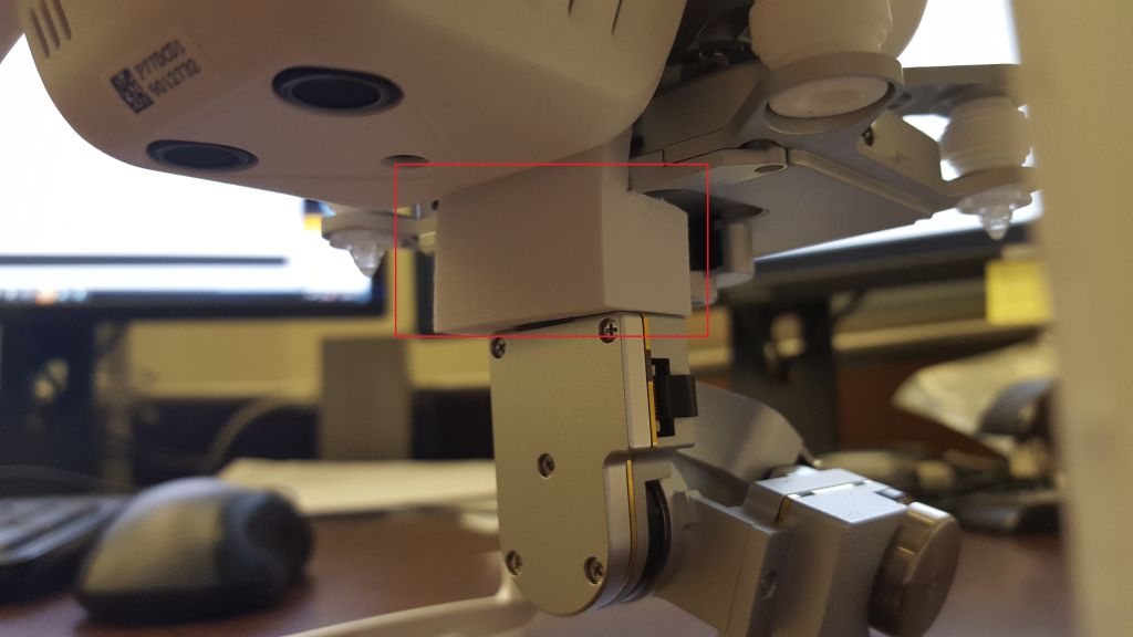

Nice area and music. Also, loved the wave at the end. Thanks for including that.
I have to be honest, to me it looks like the foam is still there. We had one guy recently who didn't see his piece of foam for a YEAR and had a year's worth of shaky / jittery video that could have been easily avoided. I'd say that at least 100 people have posted here about shaky video and too many of them didn't see the dreaded foam. I hope its the same for you since its an easy fix. I have my fingers crossed and am hoping that your foam is still there as well.

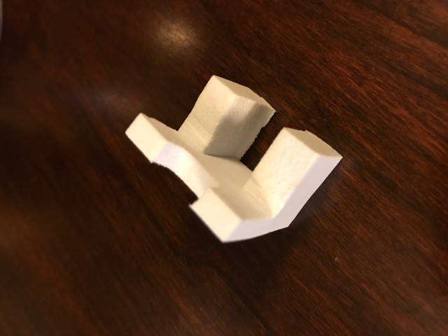

BLESS YOU!!! I've heard about this foam for the past few weeks that I've owned the P3P and looked for it more than once. Since it's a very similar color to the camera/gimbal, I never noticed it. Your picture did the trick. How did I miss the orange warning sticker??? Unbelievable. DJI!!! WTF? Really? You need to HIGHLIGHT this in your documentation. All I was really getting was a little yaw shakiness, and it wasn't really all that bad. I can't wait to get it up in the air again. I don't imagine this could harm the gimbal, but doubt it's a great idea to keep flying with it in there...
THANK YOU SO MUCH!!!

Oso: You are 100% right. It is white and looks exactly like part of the body of the bird and I would have never seen it. THANKS for pushing me to go further on this ...
by sending me the pic !!!
THIS is the value of this interchange of information on this website, for sure! Thanks again! Can't wait to do the next video and see how it looks.
