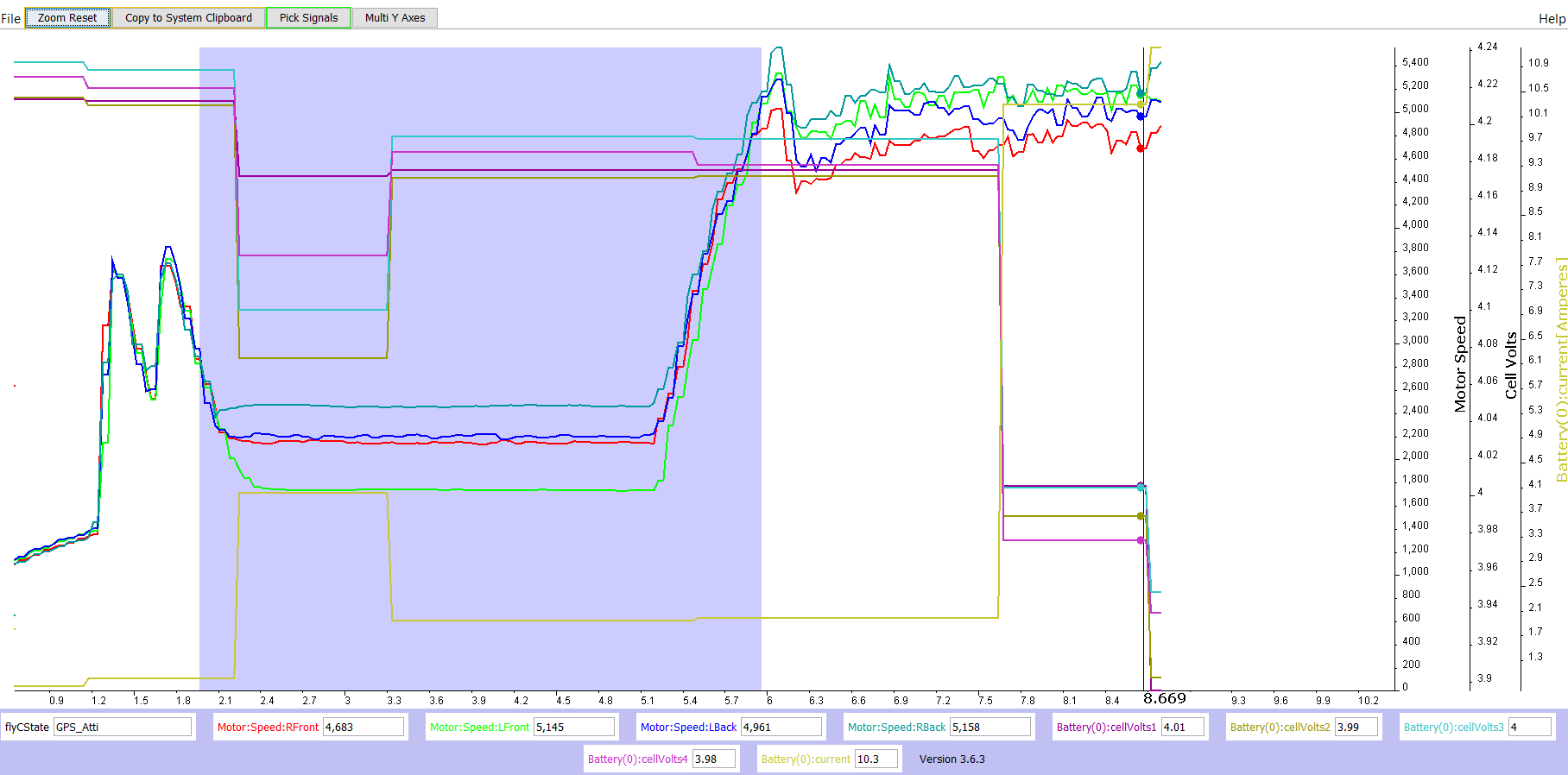

Looking at two of the files you mentioned, FLY83 and FLY84. These exhibit the issue you are seeing. As far as I can tell, everything looks completely normal and the data simply stops, which would be expected if the aircraft instantaneously shut down. I sincerely doubt that additional files will reveal the exact cause due to the instantaneous shut down. I can't tell if either of these, as you mentioned is one where the LED's remained on, but if one can be found that this was the case, there may or may not be a few more seconds of data. For the interim, it could be any number of issues that may be difficult to locate. I will look at a few more as time permits.
@gagrinho ....Update to the above. I have looked at 10 of the .dat files and they exhibit very similarly to the graph above. The data simply ends abruptly, as do the log files. This is most assuredly, IMO an aircraft issue and not a battery issue. What I mean by that is the battery itself seems fine in all files. It is a power connection issue of some sort and I have not heard of one directly related to the P3 battery connections. That does not mean that it is not possible, but I would suggest that the issue lies elsewhere as opposed to a direct battery connection. The aircraft appears to run just fine until you actually takeoff, which leads me to think that there is a stress crack ( Not a shell crack ) in a connection point some place. I will ask you this question which you didn't mention. When the aircraft shuts down, does the battery itself also shut down ( All LED's Go Off )? If so, then the issue may well be with the battery itself unless you have tried others. That said, this could be a simple fix or an impossible one to find, especially so if the only time this occurs is after takeoff. When you test next, let the aircraft idle for a minute or so and see if it shuts down. If not that will most likely confirm a stress point issue which could be anywhere in the aircraft.
