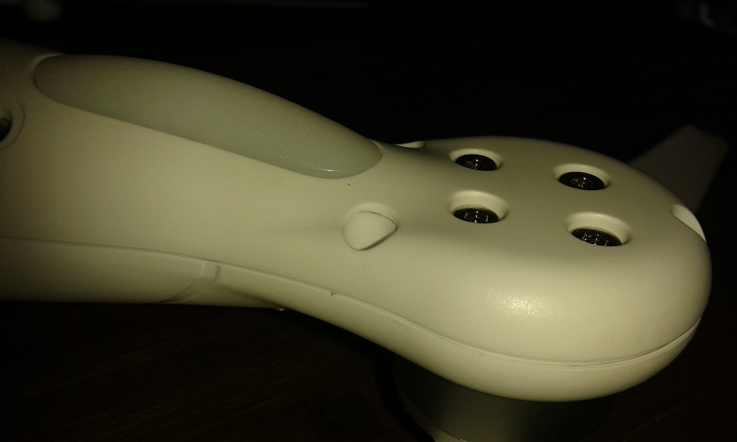

Screw inspection = very bad day
Others are so perfect in shape that they become far harder to notice. But they are there.
This pic is exactly representative of my hairline cracks in the screw holes that are starting to form. Although mine have not opened up yet, this is what I'm sure they will become in a few more flights.

All the pictures show the cracks in the screw pockets of the lower shell.
This is a injection molded part; so, if only some units have the problem I would be looking in to the injection process, if all have the problem it is a mold design problem.

It has to be torque on the assembly line, there is no way under normal flying conditions this can happen. I work with plastic all the time and this is not from normal wear and tear. I agree they could increase the thickness but this is excessive to say the least.

This should a no brainer for DJI to fix but unfortunately, they don't give a dam when it comes to after sale service. The cracks happened simply by the factory over tightening the shell during assembly. On the flip side side the cracks are not dangerous and will not compromise you're overall flight experience, you might also want to open the the unit and add a flexible silicone based glue around the edge screw mounts in order to avoid further damage. If you are good with your hands you might consider replace the top shell cover.

Then you doing something wrong.. Even with my pig p2 w/ h3-3d running lightbridge at 7000', I didn't developed these crack.(I was running lightbridge 3m before release, FYI) Now I have seen these cracks forum after people have disassembled their units and or applying liquid thread lock. Thread lock is the most common cause. Over tightening being a close second. This is why dji does not recommend users opening the craft.
The ops post is more than likely a manufacturing error with the torque being set too high on the assembly line. DJI is already in the process of getting this unit back for study.
I have both a P1 and P2 which have developed these hairline cracks on the ends of the arms. In the case of the P1 I blamed myself as I had indeed opened the casing to fit a gimbal. But the P2 has never been opened or crashed and only hand caught on landing. Two cracks (one on the upper case and one on the lower case right by the philips screw have appeared after fewer than 10 flights. So either a weakness in the plastic or indeed over tightening at the factory. In both cases it should be covered by the guarantee. I have never applied any Thread lock- although there is already dry blue thread lock on the fitted screws. Nor have I applied any glue as I have read that certain types of glue can also cause the plastic to become brittle. Even before I got my P1 in September 2013 I had already read and seem examples of these hairline cracks- so the problem has been know a long time now. And its not always the customers fault!!
