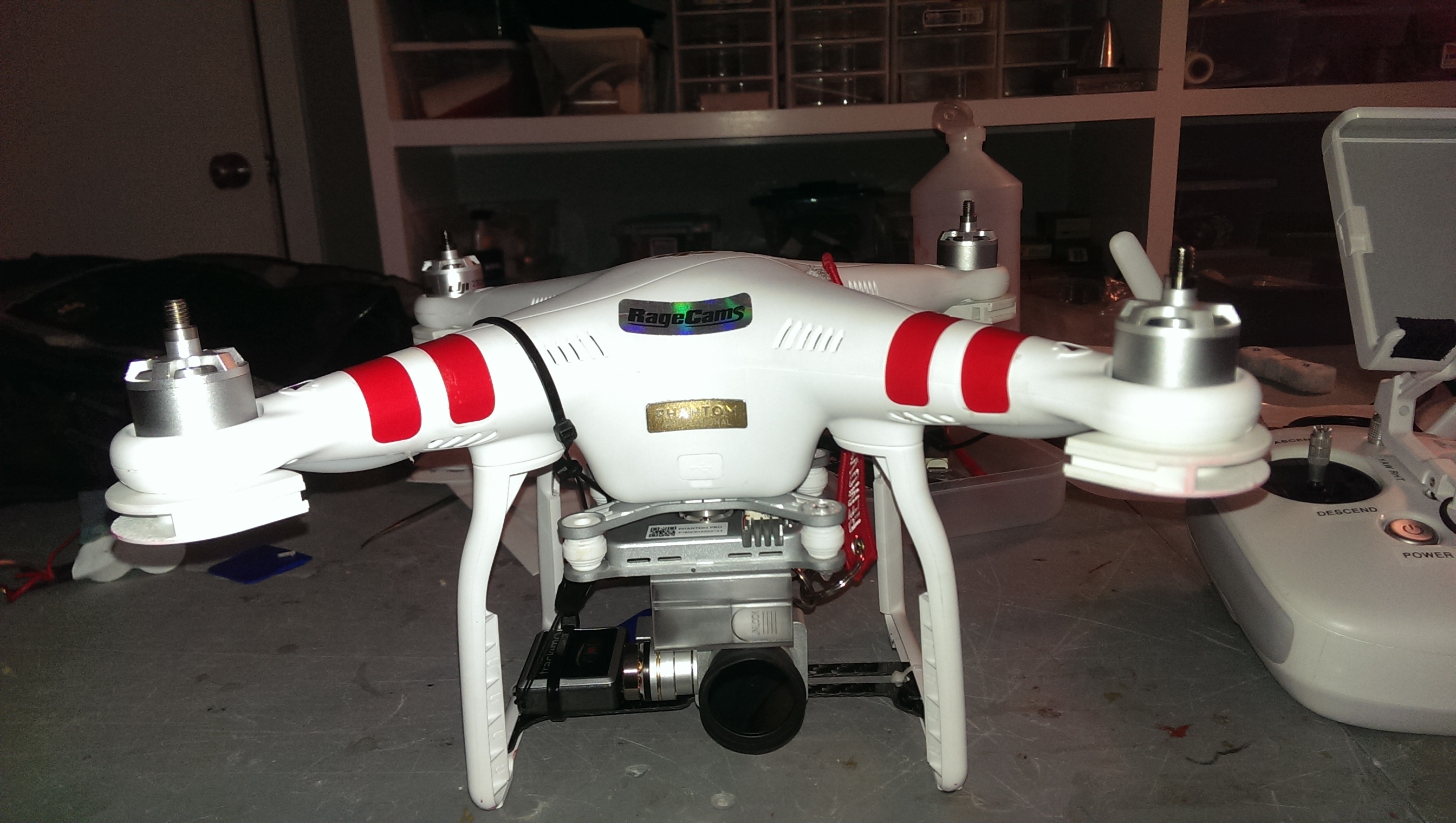

That's exactly how I felt when I saw them, there's no way that I could have done this. I should have inspected the screws when I first opened the box.
I also find it funny how the seller didn't hesitate to tell me that it would probably be just fine to fly and that there's nothing to worry about. Well, if you compare how securely mounted the motors are, the two with cracks move noticeably more in their mounts than the other two... Not very reassuring if you ask me.
The good news is that I bought it through Amazon and I have a feeling that has some influence on the matter. I have already completed the return process through my Amazon account and received an email saying that they will refund the money as soon as the seller receives the Phantom.

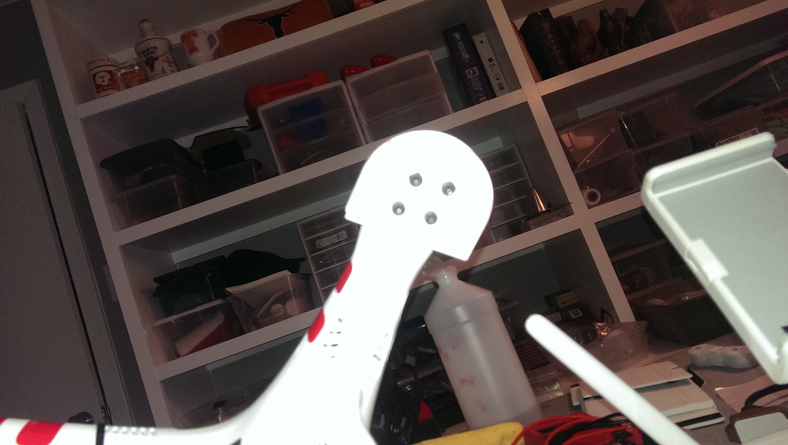

The difference between when just one screw isn't holding is quite substantial. Very visible. And something that visible will propagate to issues somewhere else in that shell. On mine, once I visibly saw how much twisting there was with just one screw hole failure on each arm, I figured that shell is pretty much done. After all these things are out there flying. Hence it's either re shell or glue. In my case the seams on each arm from screw region to screw region in the other side. Remember, a cracked shell is a cracked shell and what's the cost of an shell if a main board needs to be replaced? After gluing the flex at that arm was reduced dramatically. Day and night difference. So yes, it will fly. But shouldn't be done until something is rectified at the region of the crack. Especially if it's a screw hole which provides at least 25% of the structural integrity of that arm against twisting forces.
Well, my P3A has them. Last night no cracks on inspection. Today after 2 flights 3 of the 8 have cracks. I also noticed a never before "wobble" in the craft. Mine is 24 days old with less then 4 hours or so in the air. Its going to be replaced by Nexgen drones or DJI. I never had this issue with my other P2's. As far as i can see it will happen to all of them. Their is not alot of holding power in that thin of plastic where the cracks are occurring. If this is not fixed by DJI these crafts will wobble out of the sky. Its a matter of time before it happens.
I had that same wobble. It was very noticeable on mine once the cracks developed. After gluing the seams to restore the integrity the wobble is gone. These cracks aren't Micckey Mouse. This has to be solved. The patience we had, I had, during the P2 era is gone now with the P3 since they had every opportunity to fix this once and for all with the shell redesign. Besides, all of us here have craft that aren't even three months old. My cracks were there at about 4 hours total flight time. But then again, I had a P2 get a motor hole to seam crack at 30 minutes of flight time back in February. It was a new in box spare that I started flying due to the fact that my other P2 had too many cracks.

Sorry pal but do you see those two side by side screws that are completely away from your prop guard mounts? That's where the cracking is happening. Not, I repeat, not by the four motor mount screws. Once you have no holding power by those two screws, its only the tiny mini torx holding the arm together along with the other one at the arm base. Hence, a lot less resistance against the twisting on that arm. And while the guard mounts provide some strength to the four motor screw holes, those are completely independent of any top shell and bottom shell retention. So, no, those guard mounts are not the solution.
