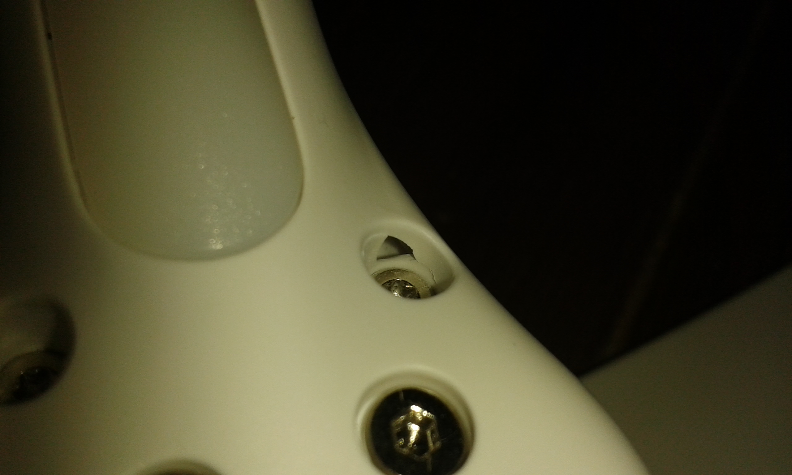

Screw inspection = very bad day
A few people reporting this is not "too many". In the grand scale of things is a VERY small number. I know this doesn't help if you're one of them..Have you tried contacting support? If not I would try there..
You understand that there are over 100,000 in the air now? If it was a wide spread problem you would be seeing it pop up all over. Yes there are a few cases of it. DJI is looking into, they are actually requesting for the ops craft back directly for study.
On no Blade Strike. It's a lot more than you think. I have had stress cracks on every phantom I've owned with the exception of one craft. So I know what to look for. They are not that visible to the untrained eye. But these new ones on the screw holes between the motor area and lights are a whole new bag. In fact I did not even see them until the first poster in this thread put up a picture with a circular hole perimeter crack. I wasn't looking for those but the old classic motor mount screw hole to the shell seam crack. Trust me, not everybody is looking. Especially first timers who have never seen a phantom crack. If they all looked there would be a lot more noise. I would make a YouTube video explaining what to look for in order to help DJI get more accurate failure figures but my shell is already glued together. As I explained, I'm not looking for a refund. I just want DJI to fix this once and for all even if the phantom cost me 2000 euros to buy.
Then you doing something wrong.. Even with my pig p2 w/ h3-3d running lightbridge at 7000', I didn't developed these crack.(I was running lightbridge 3m before release, FYI) Now I have seen these cracks forum after people have disassembled their units and or applying liquid thread lock. Thread lock is the most common cause. Over tightening being a close second. This is why dji does not recommend users opening the craft.
The ops post is more than likely a manufacturing error with the torque being set too high on the assembly line. DJI is already in the process of getting this unit back for study.
Doing something wrong? I have not had a single crash, rough landing, anything with any phantom. 1, 2 and now 3. In fact reading about crashes from idiocy, mostly at tree top level, is getting out of hand. I fly mostly at 100 meter altitude and between 500 and 800 meters distance in P2, 500 to 1500 meters on P3. No crazy control movements. But anyway, go and dig up my posts. Look in there for any BS complaints from me about gimbal wobble, fly away, or on not level horizon. Nah, I don't post about that crap. But cracks after a few hours of crashes flying and soft hand catch landings is not right. Now if you tell me not to fly a phantom at design speeds because they cannot handle it, let me know.

You never opened your craft or applied liquid thread lock? I can only go by what we see coming in and the reports that get logged. I'm telling you it's extremely rare compared to other things.
Liquid thread lock? Why? I opened P2s to get access to the motor screw hole cracks. Then put it all back together at less torque than when opened and with the same screws as they were since there was always plenty of that blue stuff DJI had on the screws to begin with. As for the P3, why open it at all? The thing is brand new! And for what purpose anyway since it's a single board in there with everything contained in that board. In fact DJI should just bond the things together anyway if they plan on keeping use of the same thin plastic from the light area of the arms on. It would spread the loads throughout the shell instead of focusing all the stresses on two locations. I've said it before in this thread that the construction of the P3 internals is not modular. Any change of ESC requires a board change. Same for IMU. Only the motors wouldn't require a board change. But those never go before the ESC. All the light bridge componentry is external under the battery. So, yeah, the top and bottom might as well be bonded to relieve stress points.

Are you using any type of cleaner information or solvents on the shell?
You're right about those clips. But ask yourself this question. Did they put them there because the stress cracks on the P2 were so rare? I see those clips this way. One, they knew there were issues. Or two, along with the torx screws, they figured there is no need to open this shell with the new integrated electronics. Which I truly like, BTW. A lot less wiring and potential for failure. Not to mention better cooling. I'm not planning on ever opening any of my P3s. Not the one I'm flying or the one I have in the box. Right now I'm convinced that the P3 needs more material thickness at the arms. It's so thin that any person assembling has to have the attention to detail that a knowledgeable and caring owner with good finger feel has in order to achieve reliable and lasting results. By comparison you could have a chimpanzee torquing the center section of a phantom and there will never be cracks in that area. As for me, until I see some more inherent strength in that area, I'm flying a bonded top to bottom P3. It's much stiffer now and I feel no movement when putting battery in or out. Two flights in today and no more problems. Until its addressed, I'm flying glued. The result is just about invisible. Sacrificial shell though for those that mind.

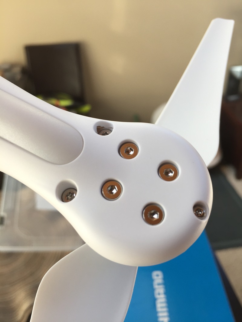

Crap. I just noticed that hairline cracks are starting to form on my screw holes as well. Exactly the same shape as the OP's. I can see that these are going to open up in a few more flights. WTF.
42 flights with 9.5 hours of flight time. I hand catch and baby landings when I rarely do land. Never crashed it either. This is disappointing to say the least.
OP- How many flight hours were on your P3 when you noticed? I'm guessing we are going to start hearing a lot more of this as people start putting more hours on their units.

PS: Checked my P3-Pro and my wife's P3-Pro. No fastener or shell crack issues for either P3. Also checked out our two old P2s and even the old P1. None of them had cracks either. Haven't had cause to remove any of the P3 fasteners. The P2s were each opened up a few times for various reasons, including curiosity. The P1 was opened countless times for maintenance and a series of modifications over the 16 months of its active use.

That is a far cry from hairline cracks. This is a complete failure. This unit was new by the way.

I noticed it on mine at much less time than you so I know how it feels. You go, fly carefully, don't crash, hand catch, everything done with the utmost care while others are posting every day how to go about replacing gimbals after hitting the neighbor's tree. Sucks. You've got two choices. One is to send it in. The other is to do what I did which is explained in my previous posts. Whatever you do do not leave it in its current state. For starters, if it's the hairline crack thing just below the surface of one of the two screw holes between the motor mount and one of the lights, you've now got a lot more flex in that arm. Look carefully at other holes. Sometimes they are very hard to see unless you notice the extra flex there which reveals what cannot be seen as the craft just sits. I had two that were obvious and two that were barely noticeable but there. They could almost pass for mold release flash.
Yup, one of my four looked exactly the same
It has to be torque on the assembly line, there is no way under normal flying conditions this can happen. I work with plastic all the time and this is not from normal wear and tear. I agree they could increase the thickness but this is excessive to say the least.
Are you guys using any kind of cleaners or solvents?
