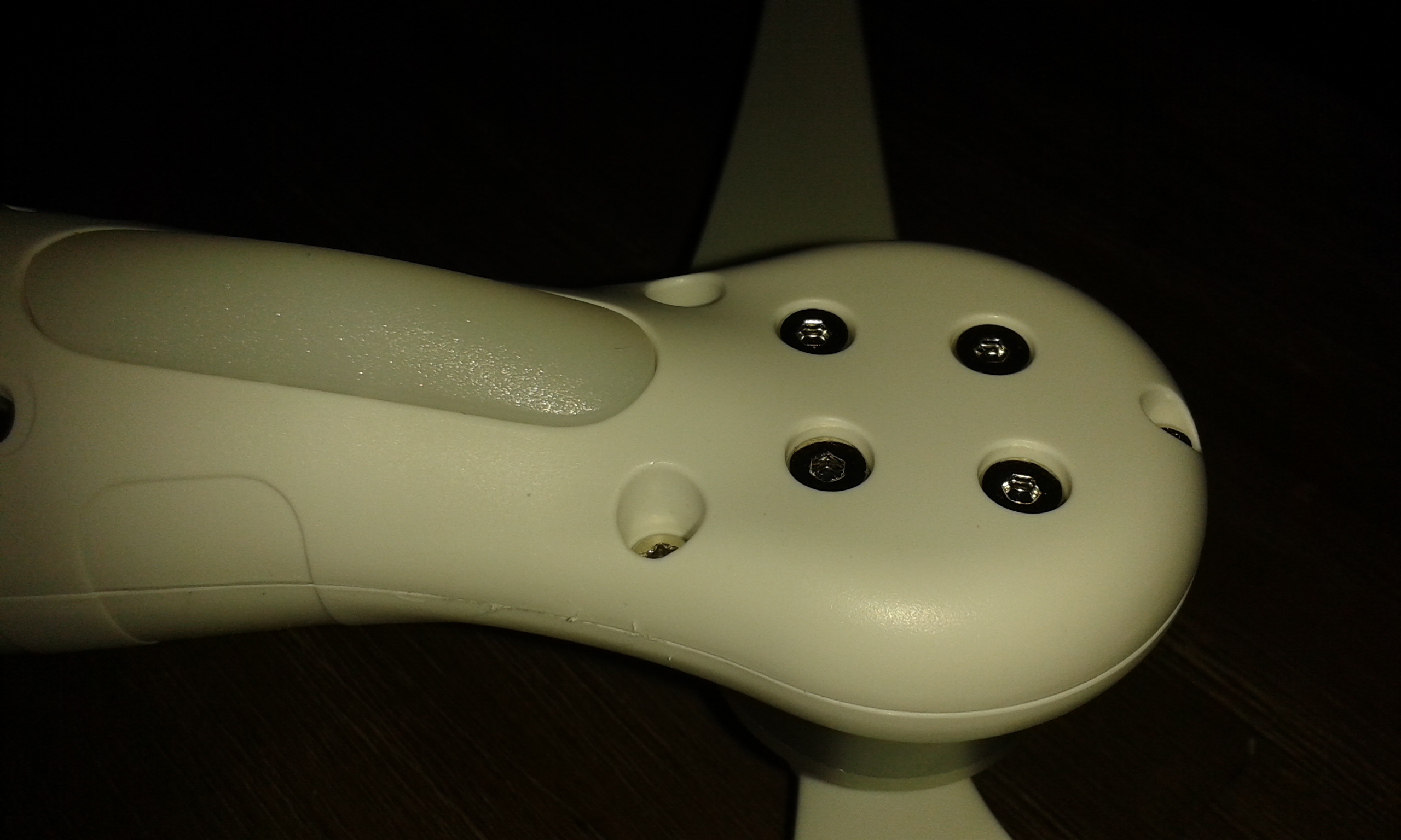

Well, I was going to head out to fly... But then I found some cracks during a preflight inspection. Then I call the seller expecting an exchange and they basically tell me that I have to contact DJI, because they have no spare parts. After asking for the manager, I finally worked out a way to exchange it... Assuming DJI approves it. Really??? Is this for real? There's not a scratch on it and it has never been involved in a rough landing, nothing... Does DJI honestly believe that they produce 100% defect free products??? I'm assuming that DJI will have no problem approving it and the seller was just giving me a lot of hassle.
Until I hear that DJI approved this for a DOA claim, I'm going to be pretty frustrated. I don't know what I'll do if they don't....
The cracks are in the recessed areas for the screws that hold the two shell halves together. Two have cracks on one arm, and the other arm has a crack on one of the recessed holes. I'm willing to bet it happened simply by the factory over tightening them during assembly.
Reactions: Mike Mauk
Definitely something that would have happened during or after assembly...
Can't see how a firm bump, or even a rough landing, would cause those.

That's exactly how I felt when I saw them, there's no way that I could have done this. I should have inspected the screws when I first opened the box.
I also find it funny how the seller didn't hesitate to tell me that it would probably be just fine to fly and that there's nothing to worry about. Well, if you compare how securely mounted the motors are, the two with cracks move noticeably more in their mounts than the other two... Not very reassuring if you ask me.

I had a couple of hair line cracks. I called DJI and was told that the shell/body is not a part of the warranty(wtf) but I çan still get an RMA or whatever they call it.
I was under the impression that if I sent it out, l would be charged and it would take forever to get back to me.
I decided the hair line cracks were not major. So I purchased Crazy glue and dabbed it on cracks. I will wait til the shell is for sale and make the change when its available.These shells are shitty and if the torq screws are tighten to much the end result is cracks.
Now, after ever flight I make sure to check the shell. I had this happened to my P2V+ and switched out the frame with no issues.

I feel your pain, but believe me when I tell you Crazy glue will seal the crack. I wasn't a believer until I did it on my p2v+ and flew in more then 100 flights and none of the cracks increased in size.
Bandaid...yes! But it will stop the bleeding!!
I've had cracks on every single phantom I've owned and I have never had a crash or rough landing. I always hand catch. And my two week old P3A is no different. I've got them already. Does it piss me off? Big time. It amazes me that very few here complain about this. DJI goes and designs an updated shell with every opportunity to address a problem they KNEW was there because they even added clips to the shells but still paper thin plastic on the most highly stressed part. I don't ever n stare at the motor mounting area for too long because that can start cracks. Joking aside I'm getting **** tired of fixing stress cracks. And now with the new shells it is a much more difficult process opening them. Maybe that's what the clips are for now. They know its going to crack so the clips keep it together for lack of paint to do the job. I love DJI's products but the shells are pieces of dog poop. They were dog crap on the P2 and are still dog poop on the 3. Just a hair thicker would have done wonders to keep $1300 product from cracking within a week but nah. I would be willing to pay 30 or 40% more for better structural integrity. Anyway, the p2 cracked from usually one of outer motor screw holes outwards to the meeting point to the upper shell. The P3 likes to crack inside one of the two upper lower shell retaining screw holes. Send it in? First DJI isn't going to offer warranty on what they know will happen to at least 40% of phantoms. Again, I had 2 visions, two vision pluses. They all cracked without one crash or rough landing. So forget warranty. If I paid for them to replace the shell I would literally have one at their repair center every month of the year. Not right. And while I became an expert at repairing phantom cracks, like silverstoned, I'm at a loss at how to repair complete missing plastic at the screening hole. Plastic, it seems, barely thicker in that area than a piece of paper. ******** for lack of a better word. I own two P3s now so I like their stuff. But this cracking is unacceptable. Check yours out folks and do chime in when you see the cracks.

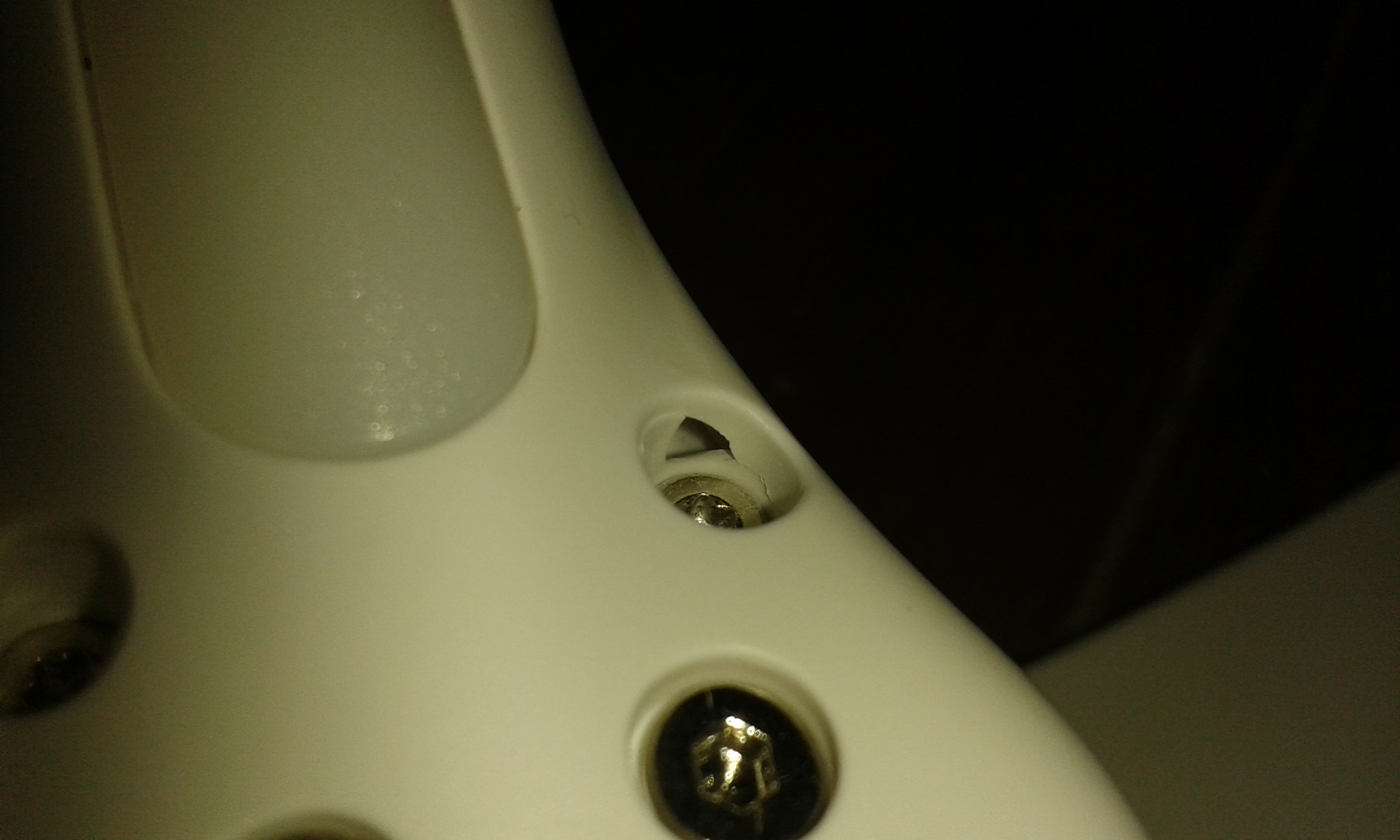

Here are my cracks. To hell with it, I'm gluing the fuselage together. Why? He cause this now is worse than the P2. The P2 cracks didn't affect the structural integrity that much because they were on a different location. These cracks do. You can physically see a lot more twisting movement from the arm ends once the cracks are there. And again folks, chances are you probably have them.
A dab of super glue should fix you up and last for the life of the quad. Not worth the hassle if it was mine :)
I agree with hairline cracks but look at the picture...You can't superglue a hole.
Here are my cracks. To hell with it, I'm gluing the fuselage together. Why? He cause this now is worse than the P2. The P2 cracks didn't affect the structural integrity that much because they were on a different location. These cracks do. You can physically see a lot more twisting movement from the arm ends once the cracks are there. And again folks, chances are you probably have them.View attachment 22829 View attachment 22831
Sorry to hear that you're suffering from the same issue. The pic with the chunk of plastic missing looks identical to mine. Looks like the cracks on the other arm are where the motor mount screws are, correct? If this issue really is so widespread, then DJI needs to make sure their dealers know what to do when they encounter it. I can't believe that this is how they do business when the issue is clearly not the customer's fault.
