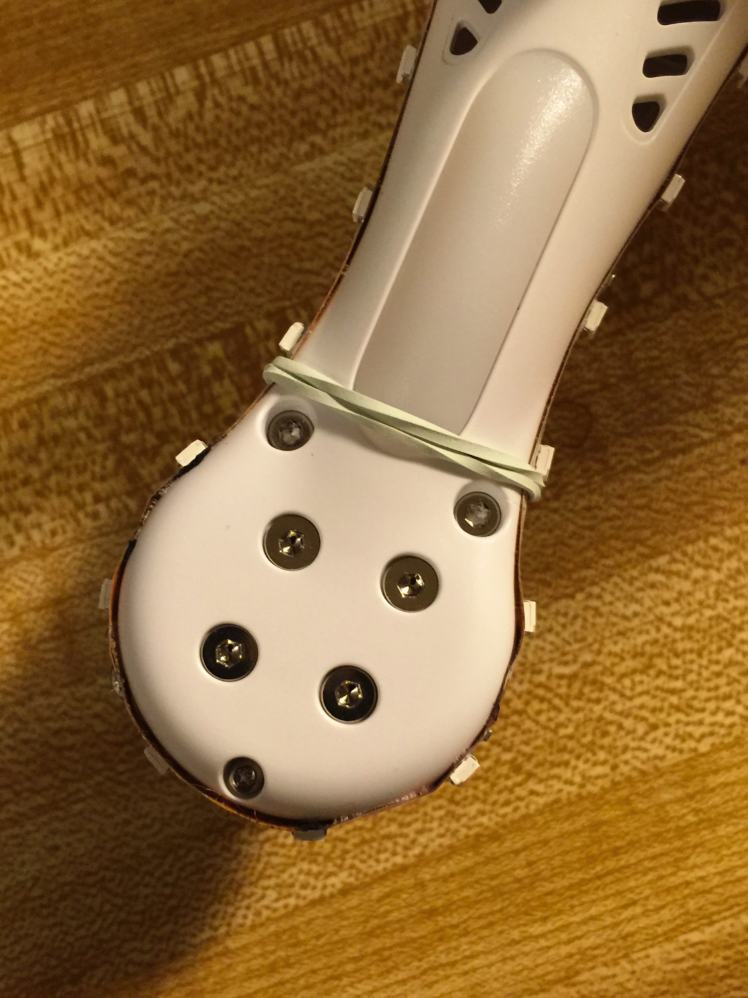

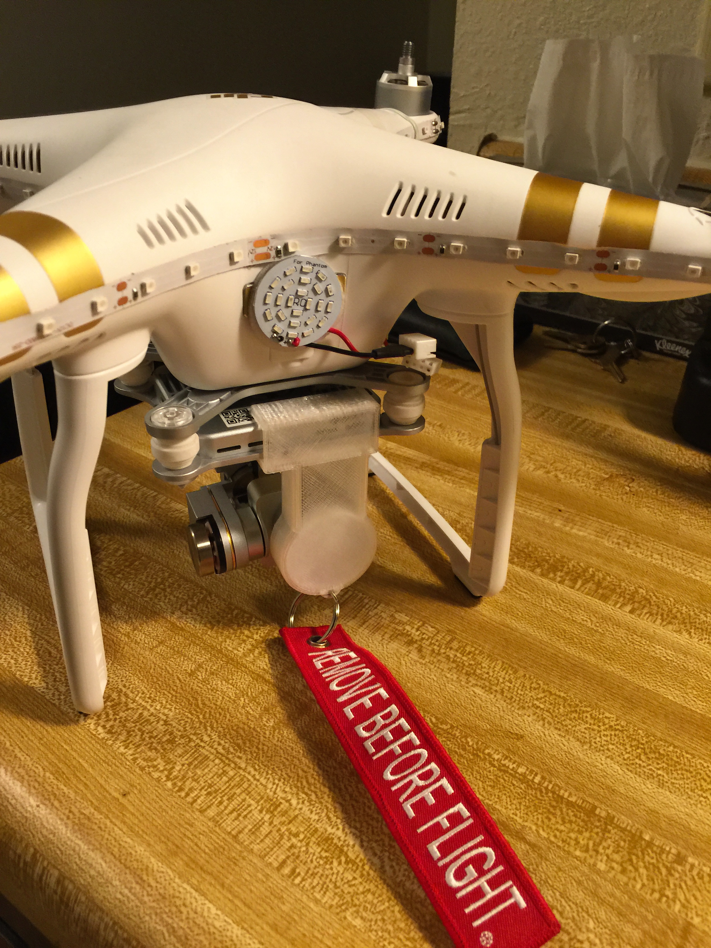

The light strip has adhesive and "sticks" to the shell, I tried to stay centered on the seam all the way around. 4 rubber bands were included as part of the installation. I don't know if they are helping in any way, but after tonight's 4 flights I now have 11 hours on my P3P without any cracks.
The rubber band rides just near the end of the LED light......................

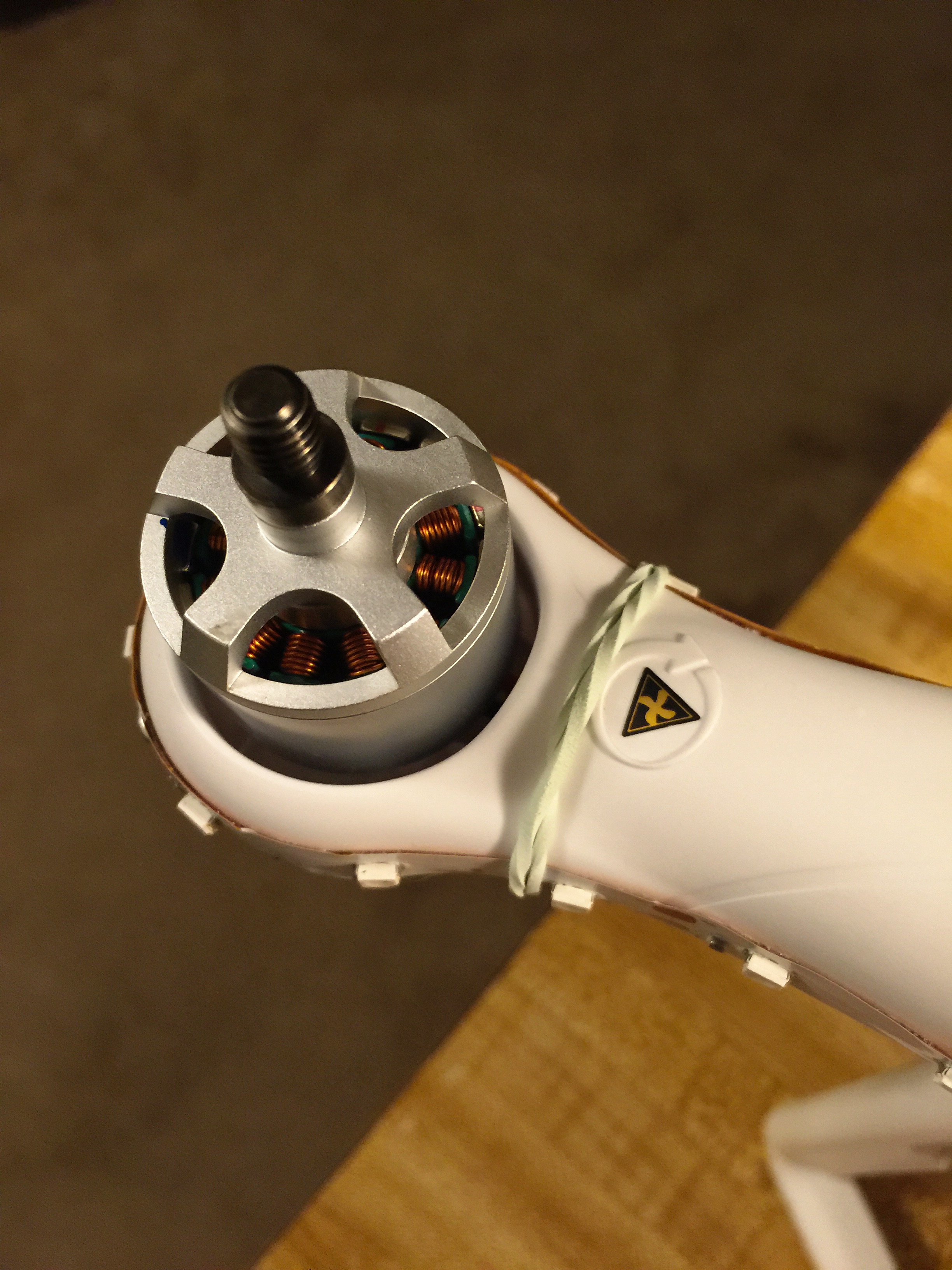

And the view of the rubber band from the top.......................

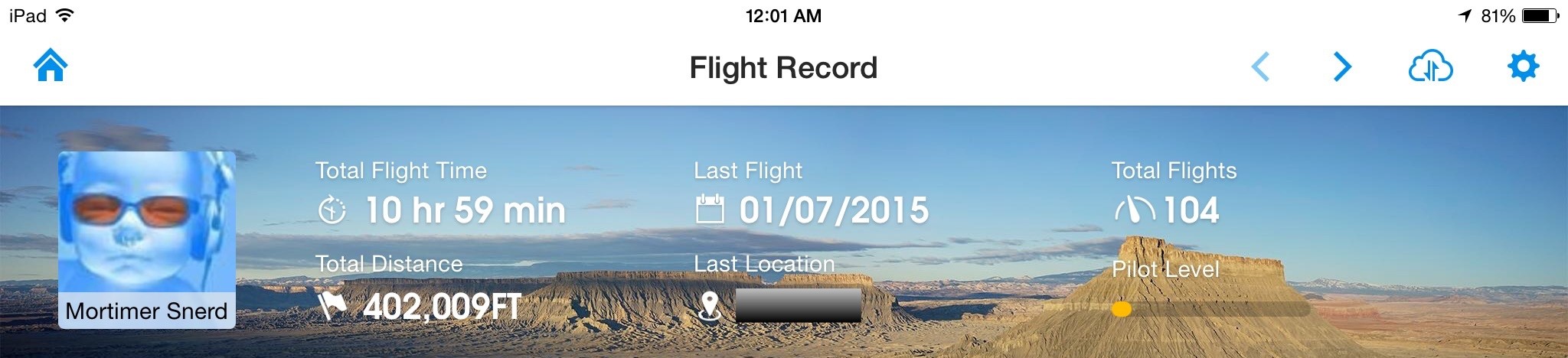

My Flight Record.................
So, I'm just taking an educated guess really. I doubt that the rubber bands bind the shell nearly as well as the Loctite. I'll keep inspecting daily, though.

It seems like you have a crack near the screw on the right near the rubberband. I hope not. Am I just seeing things?
Reactions: Bigdz
I envy you young-uns with your good eyesight. I went back and looked it over as well as my old eyes can. I just can't get a good enough view of it to be sure. It could "possibly" be the start of a crack, I just cannot tell for sure.
You have eyes like a hawk, that is the start of a crack.
