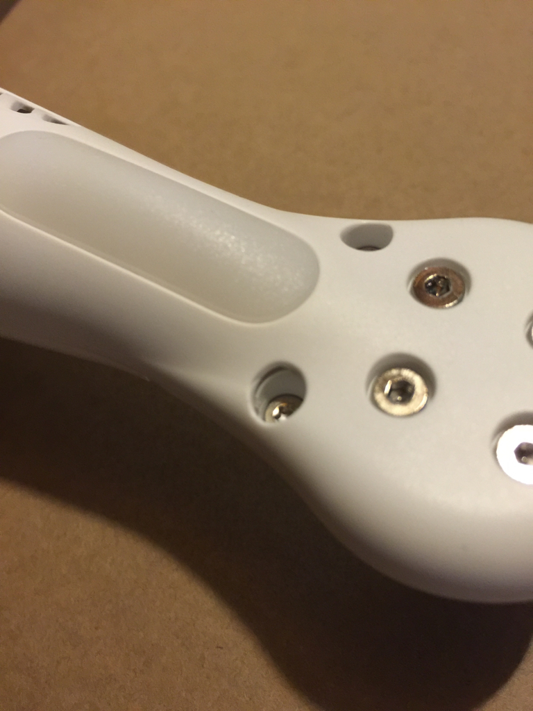

Anyone else see or have cracks in these locations? I'm going to check my P3 when I get home later.
Yes, I'm pissed. I have cracks on mine and its never seen a bump or crash. I've only babied. This is a problem for sure. I just noticed this.

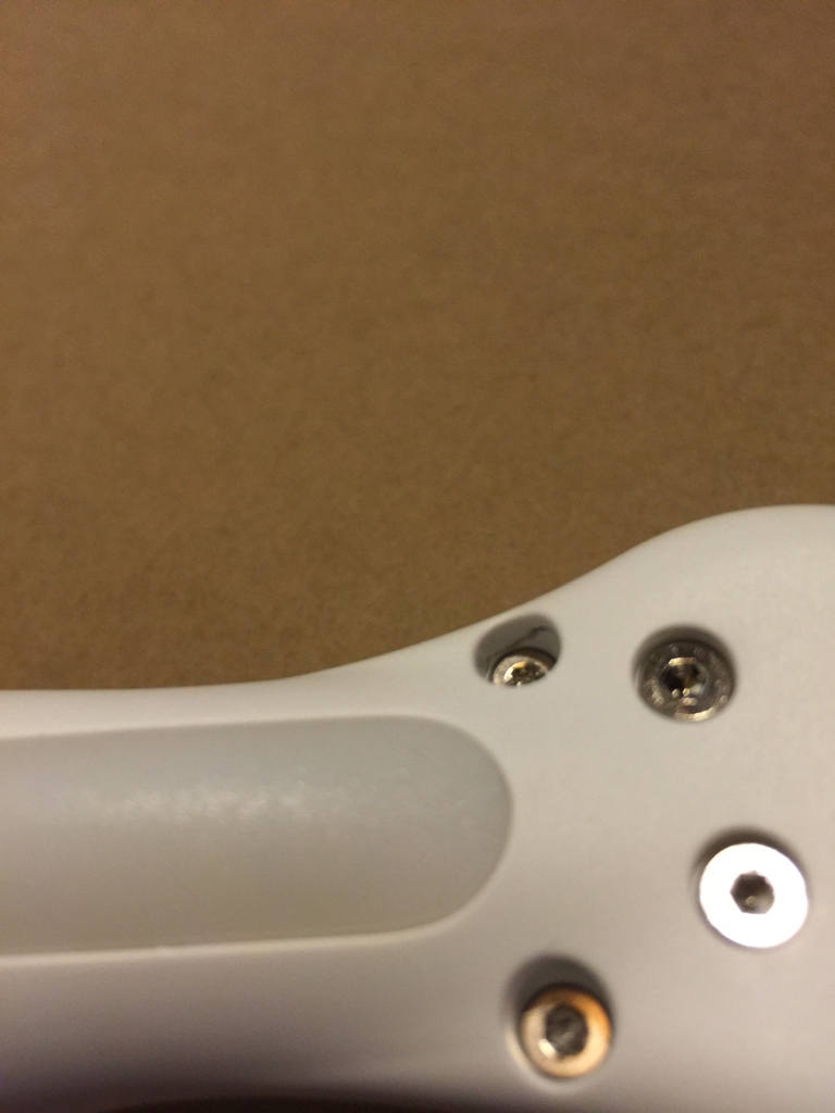

Here are my cracks. DJI wants me to send it in for repair. He said I would probably have to pay for it. I am trying to get them Amazon or HeliDirect to just refund me. Gonna check out the 3DR Solo if I can get a refund. Such an obvious defect that will eventually just get worse until it falls out of the sky. I am not willing to glue a $1200 product.
