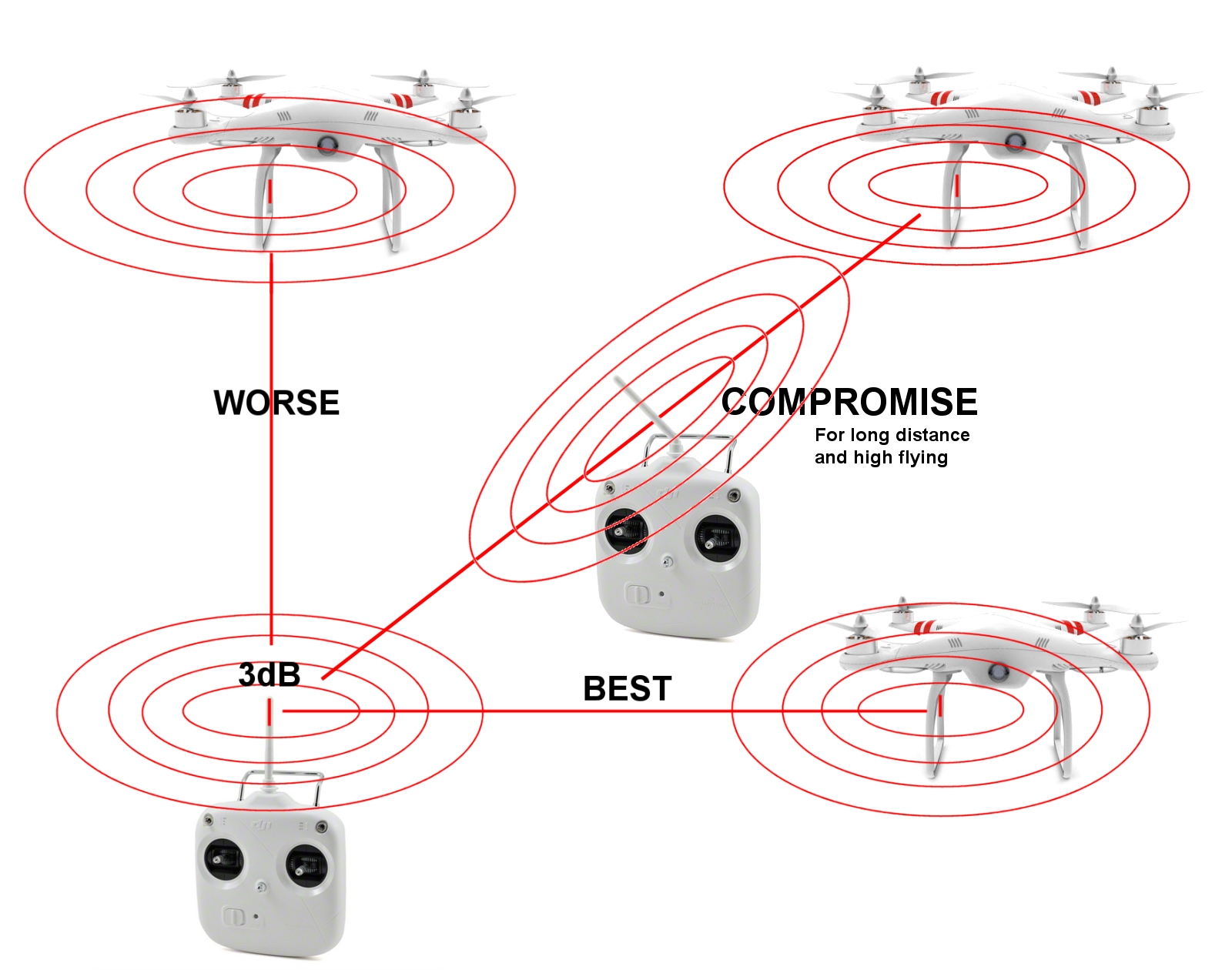

Here's an idea about orientation. Directly above the transmitter is a dead zone, if the antenna is pointed upwards. If all this fails, just try another phone/table, just to eliminate that.

Here's an idea about orientation. Directly above the transmitter is a dead zone, if the antenna is pointed upwards. If all this fails, just try another phone/table, just to eliminate that.View attachment 99865
