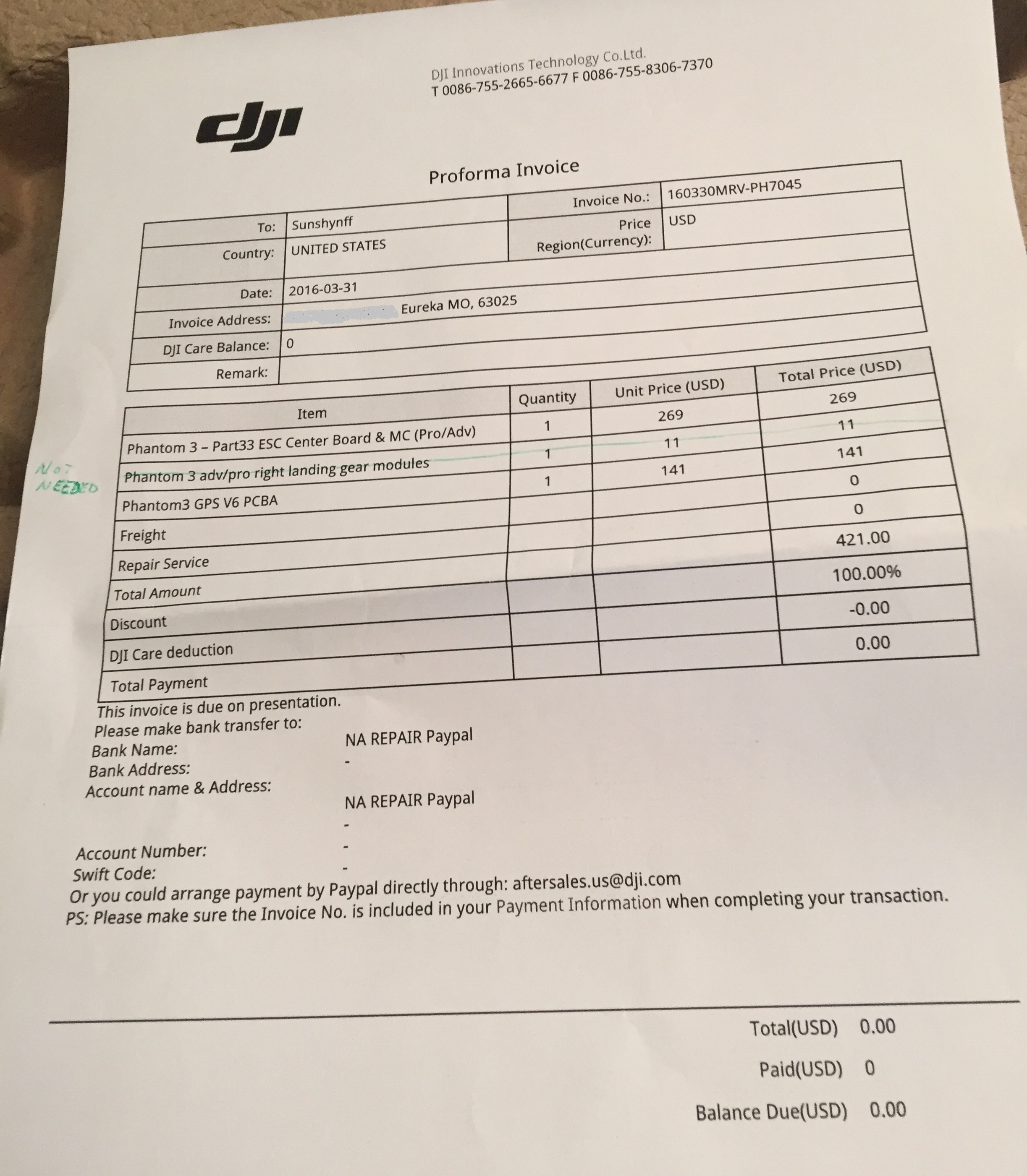

Well, I finally got my P3P back from DJI, it flies just fine now, here is what they fixed....
