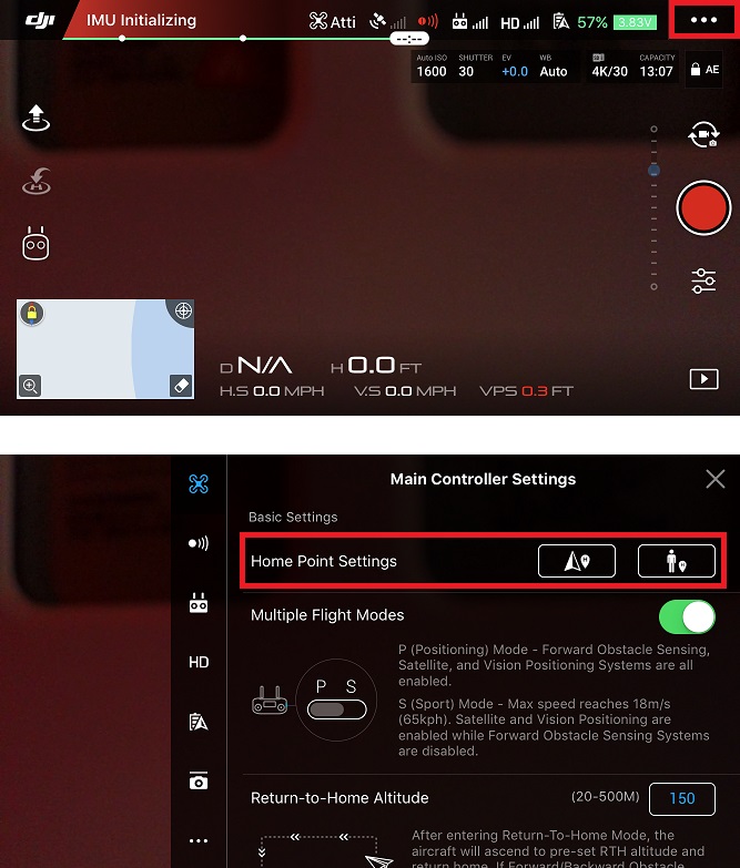

I would like to fly around while on a boat and the drone come to the boats current location - not the takeoff position. I think I saw a way to do it a long time ago.
After taking off, you'll need to reset the home point to the location where you'd like the Phantom to land. To do that, you need to do one of the following:
1) Fly over top of the location where you'd like the Phantom to land and reset the home point to the Phantom's current location. Then, carry on with your flight until you're ready to use RTH. This of course would only be an option if the boat is stopped and at the location where you'd like the Phantom to land when resetting the home point.
2) If you're using a mobile device that contains a GPS receiver, you can reset the home point to your mobile device's current location at any time during the flight.
Note: Before attempting this, do a test with your mobile device (when not over water) to ensure this works. DJI GO is unable to reset the home point on some devices (like iPhones).

You can reset the home point in the following section of DJI GO. Click the button on the right to set the home point to the mobile device's current location.
Hi @msinger,
I've noticed a lot of pilots (no matter if they run DJI Go 3 or 4 App) have the identical issue as mine, namely they cannot re-set the home point according to the new RC GPS position. Trying to proceed with it in the "Home Point Settings" menu, the system retuns with these 2 warnings: "Mobile Device GPS Signal Weak. Its location cannot be acquired" followed by "Home Point not recorded". (the tablet has no issues when running other apps that need GPS coordinates)

I tried to reset home point recently on a boat and using the crystal sky. I got the same error. It was very annoying and caused a bit of a plan B. I could swear I had tested it from home. I thought maybe my Bimini was causing GPS interference.
