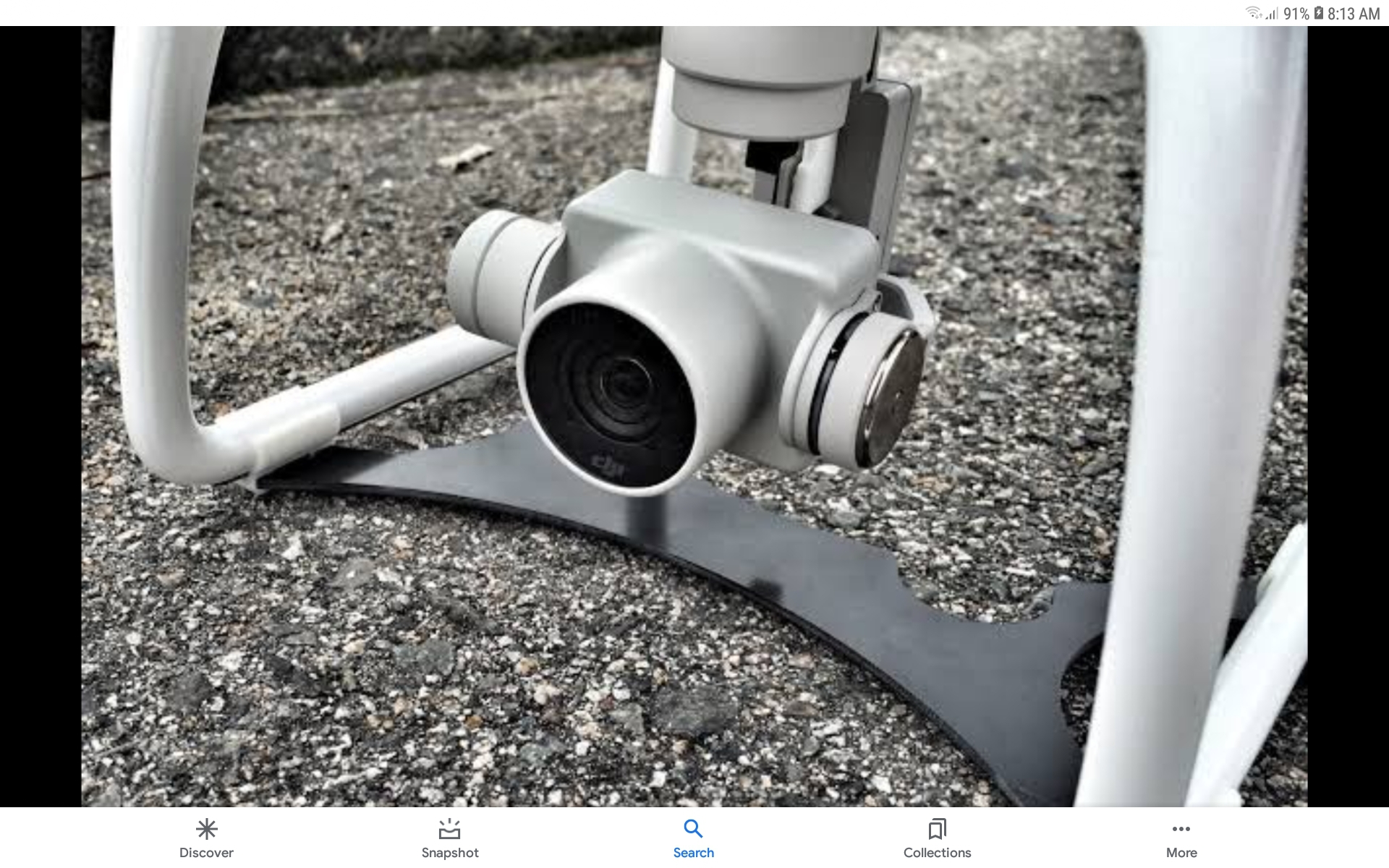

1) What is VPS
2)What is Gimbal Protector
I use the latest FW!!
Thank you to be so patient!!!
Yip welcome F-16
Gimble protector just a add on part that saves some damage if minor crashes ....VPS is the downward sensors,,mechanical sonar sends pulse to ground and back to help with the drone showing height and has monocular cams on either side of these little speakers,,helps with smart return home for accurate landings,they not work well over reflective surfaces ,,you can find heaps of info by downloading the online manual just with simple Google search,,its covers everything you need to know which normal booklet dont have....also check your RTH setting ,,it should stop at this determined height before rth fully engages
