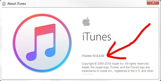

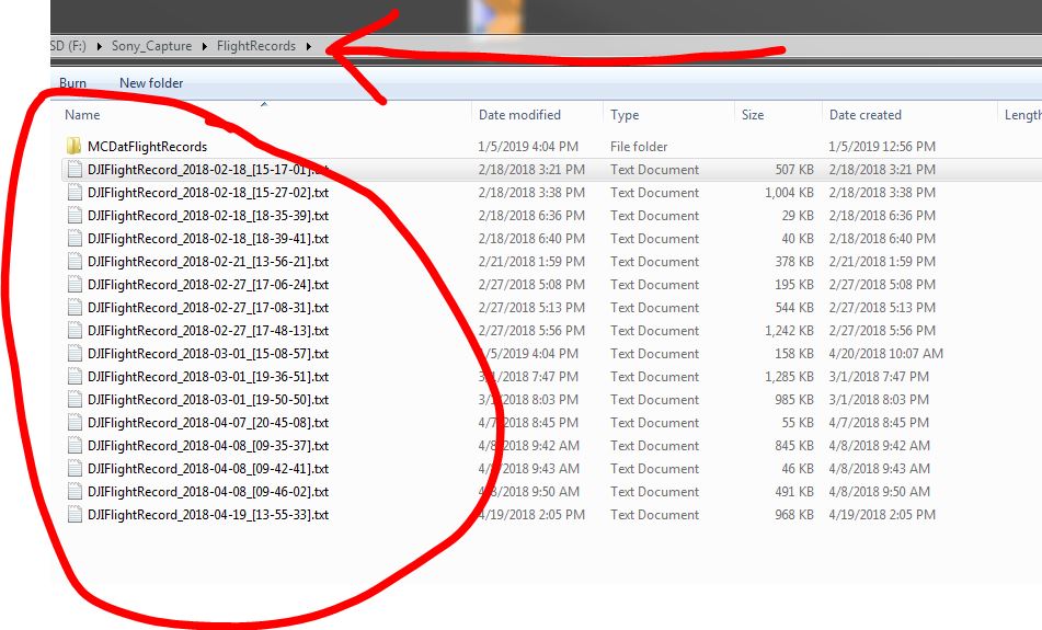

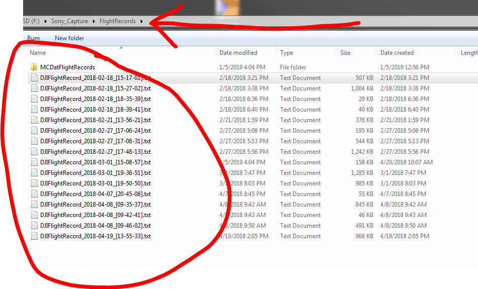

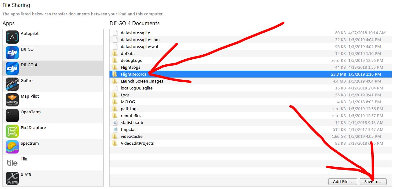

I still have the phone. How would I get the flight data needed for you to have a look, please?
EDIT: I had originally pointed to the "FlightLogs" directory/folder. This was incorrect. The correct files are in the "FlightRecords" directory/folder. I have updated the screen captures to reflect the corrected information.
Like I always tell my business partner; "Anyone who can hack past DJI and Apple shortcomings shall rule this industry." And rule, we do.
Upload the .txt files here:
DJI Flight Log Viewer | Phantom Help
NOTE: For MapPilot, the flight records are kept in the "SDK_Logs/FlightRecord" directory.
Before asking a bunch of questions, use your Google machine. All the information you need is in these photos.
Good luck!
D

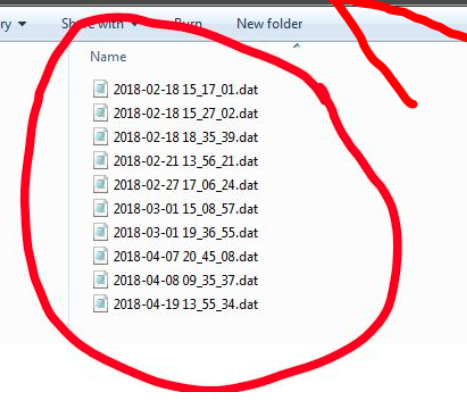

With one exception....these files are not the actual data files...you have to extract the FLYxxx.dat file from these.
Touché. Wrong folder. It's the "FlightRecords" folder. And they're not .dat files. They're .txt files. My mistake.
I don't understand this sentence. What do you mean by "these?"
I have edited my original post to include the correct information. Thanx for the heads up.
