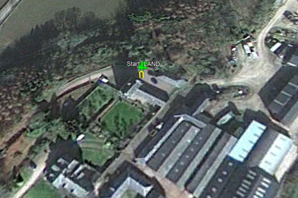

Anyway, see what you think about the data.

Not according to the GPS data....You were within 10ft ( Roughly ) Of your take off point. That is well within tolerance. You seem to expect more, but that is not always the case. There is nothing wrong with the landing spot, per this data. IMO....

Precision "Landing" requires accurate GPS AND Accurate VPS. You can not count on the VPS being 100% accurate...If there is anything at all that interferes with the VPS from the takeoff point, ( In reference to the terrain )then there is your difference.

Not applicable in this case. The aircraft was 268ft from the Home Point when RTH was initiated.
