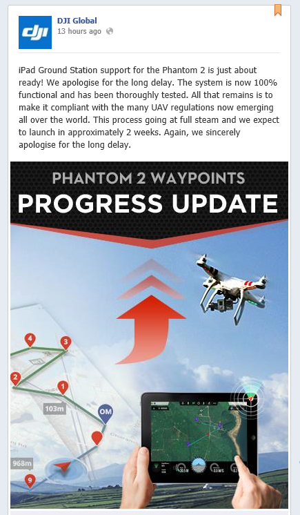

Well, look at this... only posting here cause everybody that owns a PV2 will seeeeeee.
and then.....
I think DJI means you will have to add bluetooth to the phantom 2 OR have a phantom 2 vision for ground station to work.
Ground Station capabilities and my rotorpixel gimbal getting here all within the next couple of weeks! I'm freaking out man!!!
seems like the novelty of autonomous flight will wear off fairly quickly. heck, i dont even have the guts to test the RTH feature because the thought of turning off the controller scares me to death..lol. at some point i will test it, but not anytime soon.
Not a novelty when used for business purposes. Using waypoints for aerial photography or videography will come in handy on most circumstances I can imagine.
tizzl10 I do agree with you to some extent. I'd like to play with it on the Vision more as a "cool toy" than anything else, and I personally wouldn't dream of pushing it beyond line of sight (assuming that's even possible with the Vision waypoints when they arrive). However I know lots of people probably will, and they won't have checked out the route they picked for obstacles, and they will either fly far too low or (even more worrying) far too high without being able to keep a lookout. My worry is that ground station/waypoints entering the hobby end of the range is going to cause a lot more aircraft crashes due to collisions with "stuff", and possibly more "newsworthy" incidents where the things collided with are power lines, or phone lines, or people's roofs or worse...
I agree.
Since all it allows you to do is fly from A to B to C ... without any sort of programmable camera/gimbal control - it's pretty much useless in my world.
Plus, as has been alluded to previously - I'm sure that there will be a fair number of people who won't consider obstacles in the flight path. I'm wondering if AMA's insurance will cover autonomous flight in a (most likely) unauthorized area...

I agree.
there is a cheap heil on the market for about £50 that users way points. my self its not something I would do, be it a heil or phantom I like to know that am in control not some app, not for me at all
