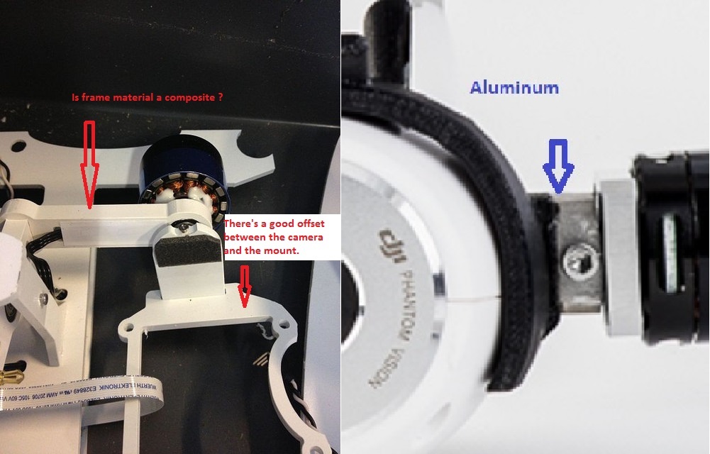

It looks to me like Dronexpert has mitigated the problem by minimizing the amount of metal directly in front of the antenna. They also use some kind of composite for the frame which may be invisible to RF radiation. The Rotorpixel gimbal has aluminum right in front of the antenna which would block transmisionsSee my post at http://www.phantompilots.com/viewtopic.php?f=7&t=6508&p=67560#p67560
for more thoughts on the blocked antenna. I purchased the gimbal (order 439) believing that I would have to move the blocked antenna from behind the motor.
