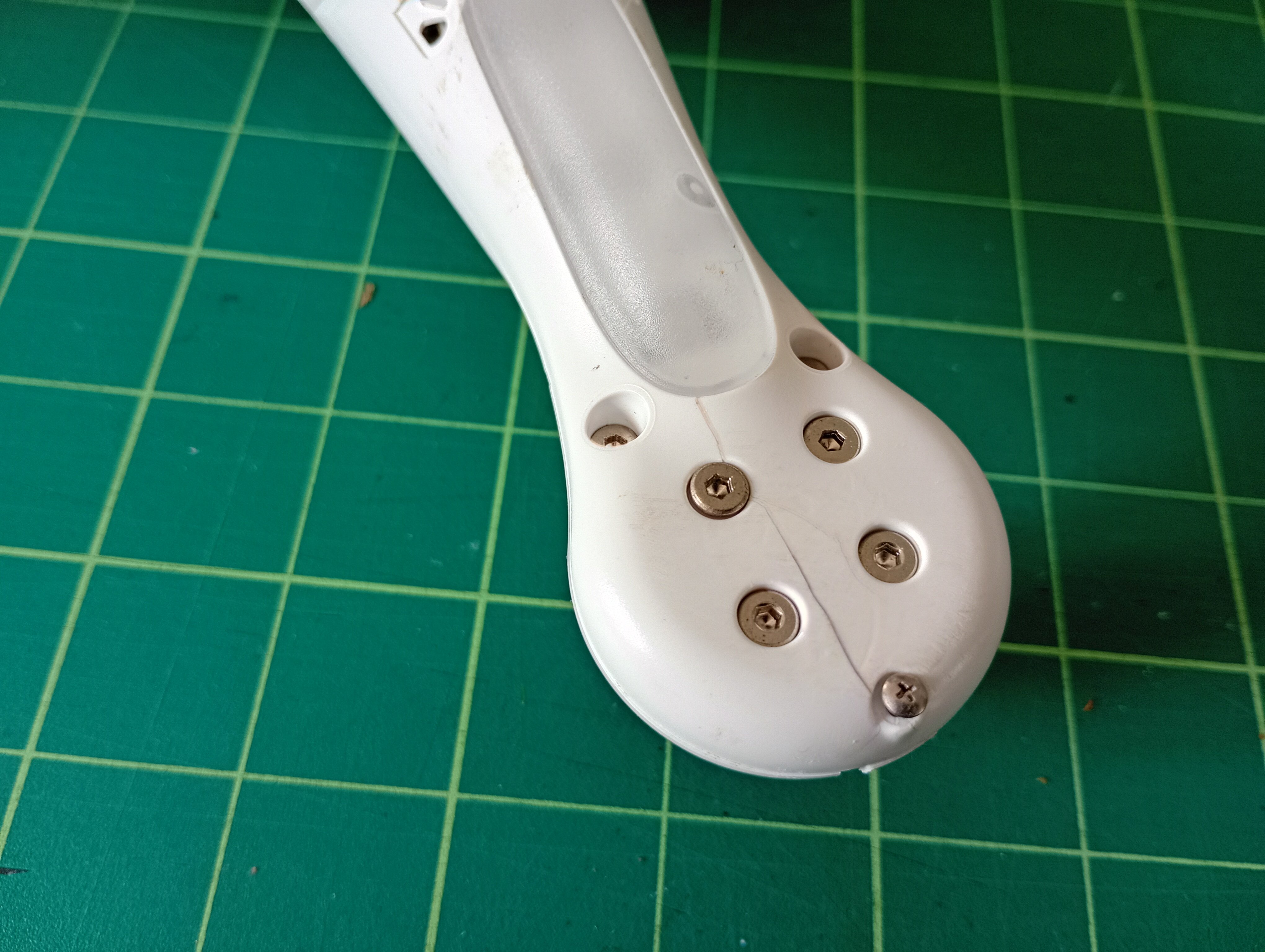

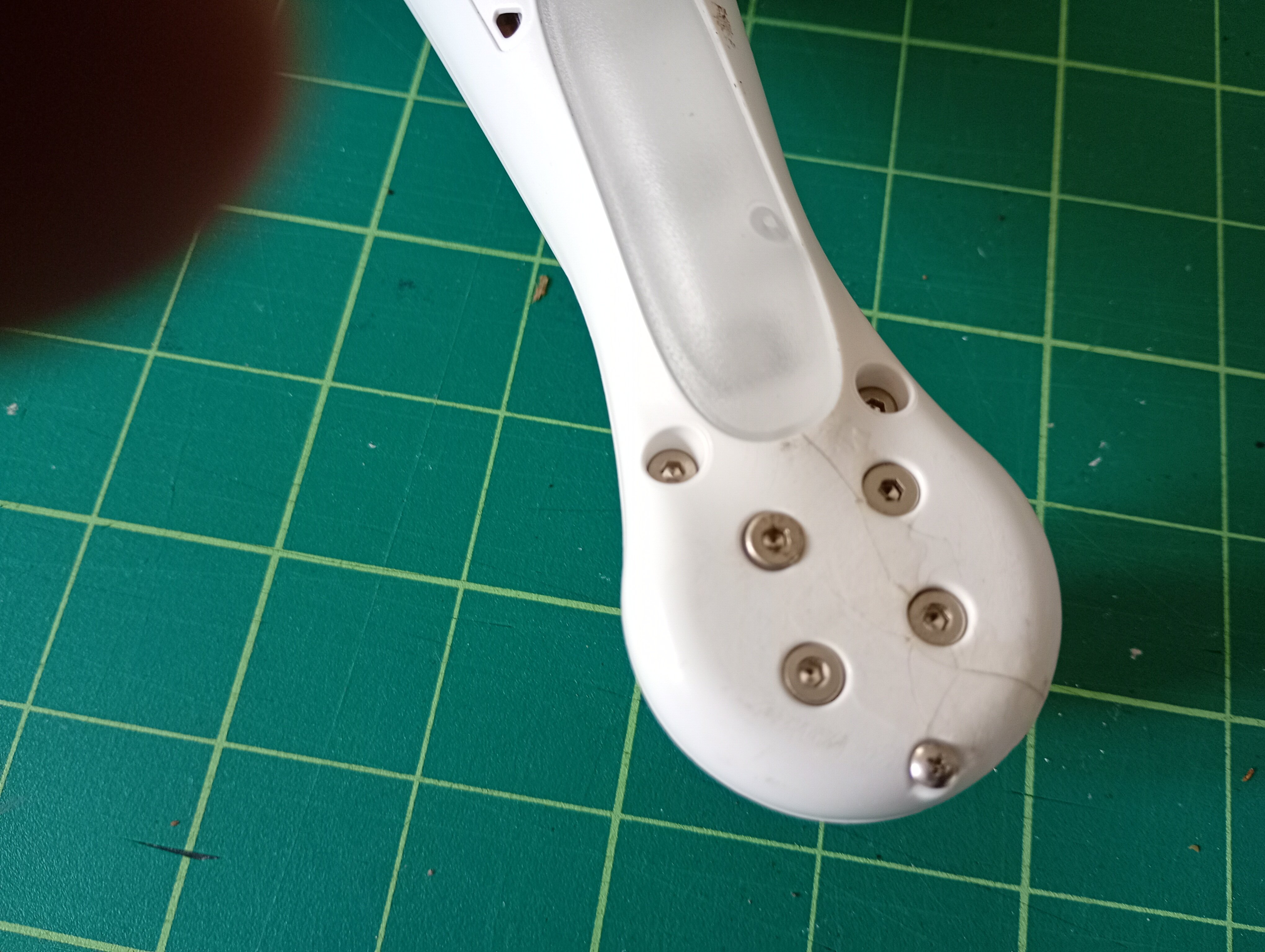

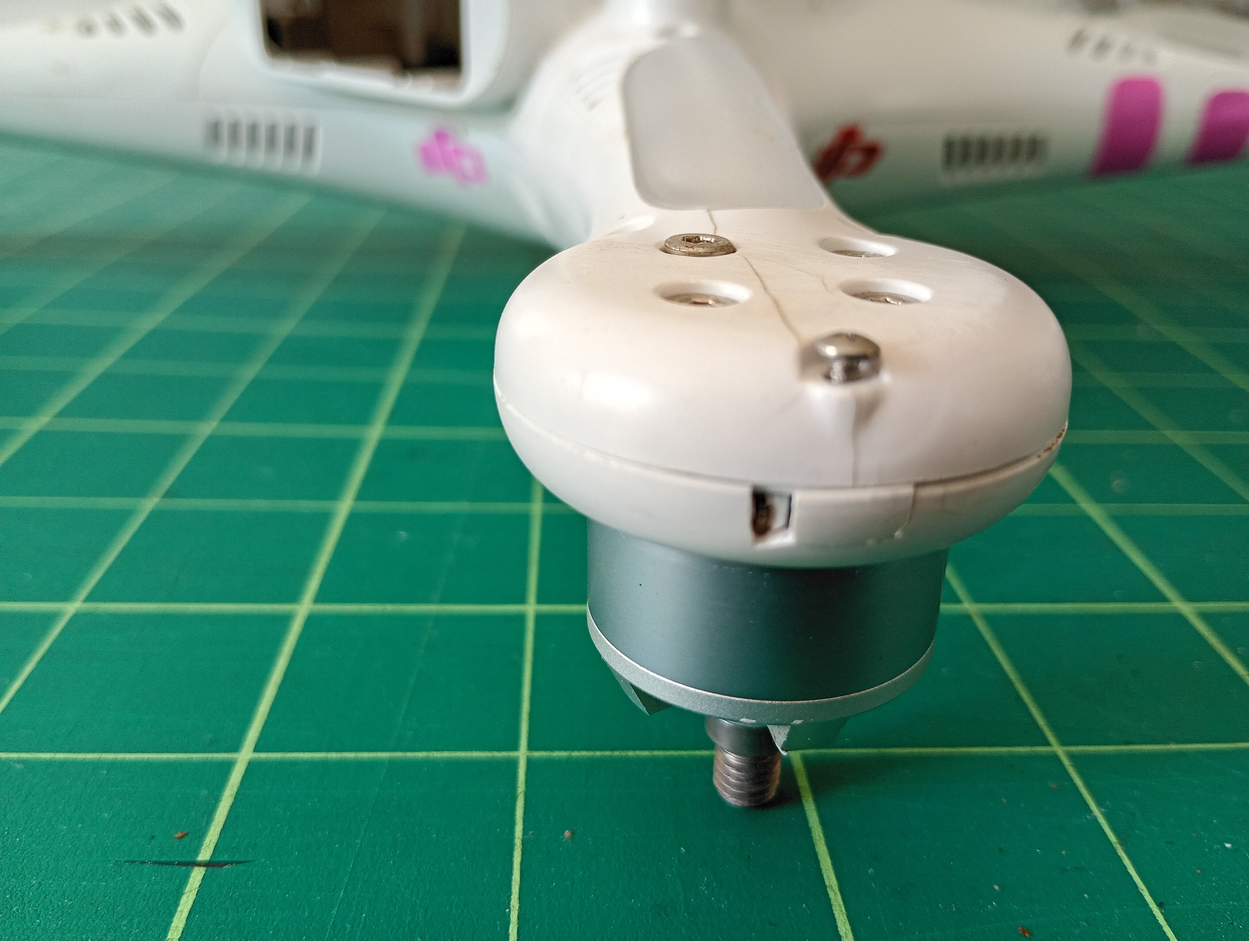

does anyone know if the top shell is the same from the phantom 2 to the vision plus? ive bought a vision and the ends are cracked
exactly the same the tricky part is getting the camera wiring through the hole, if you are in the uk i have a shell in good condition

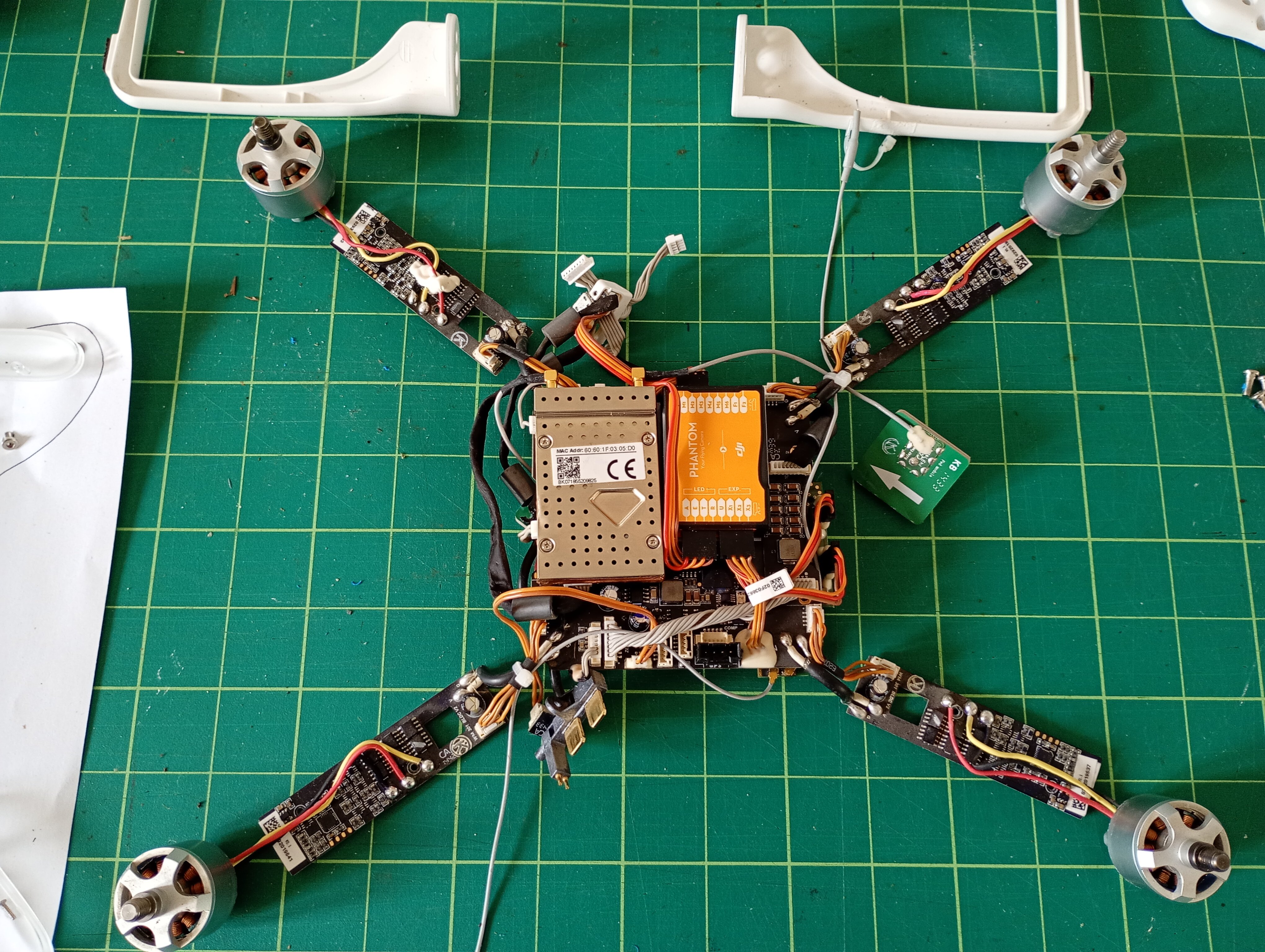

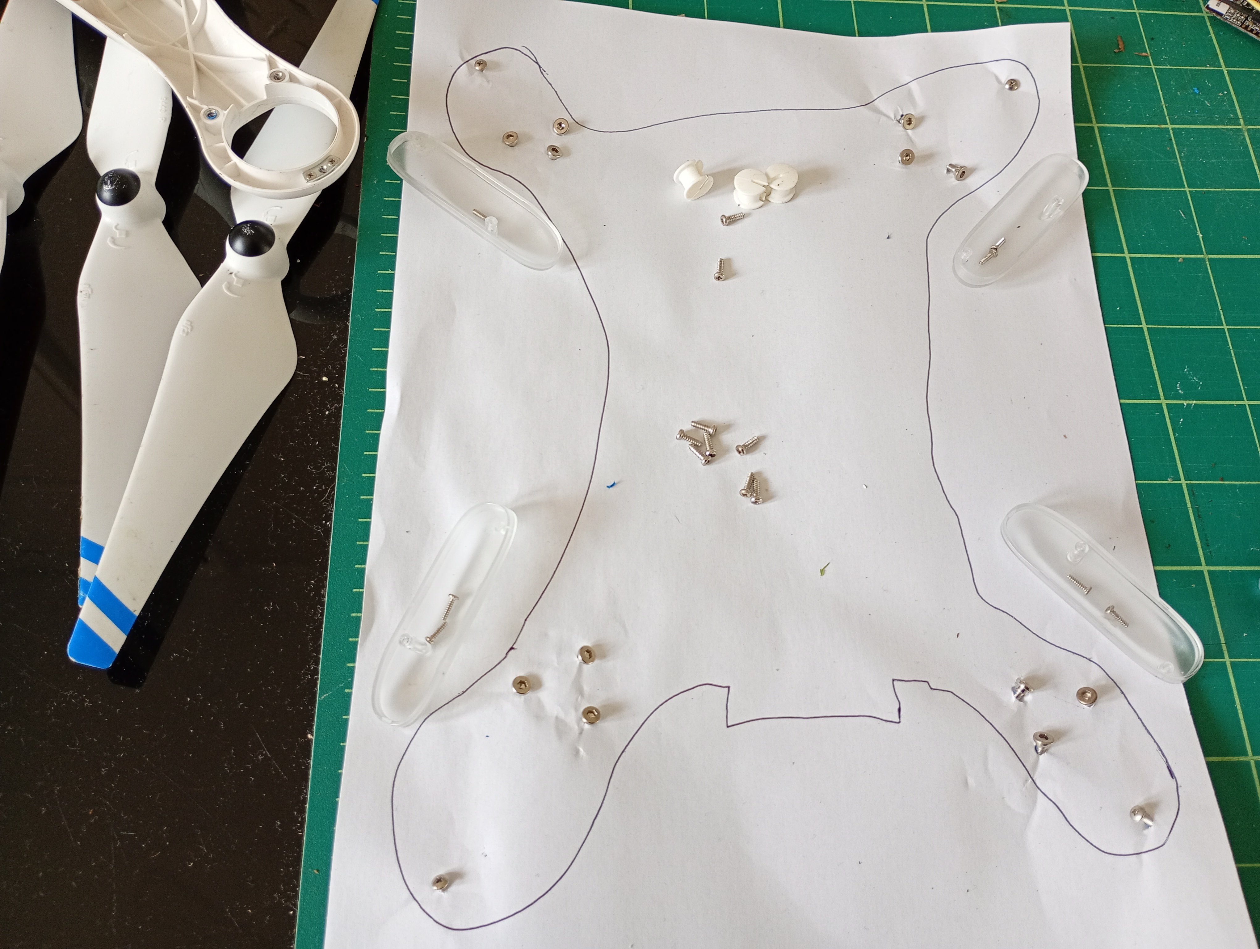

i did what you said buddy, it went smooth, span it up on the side with no blades the top is defo toast, the bits from the lugs fell out as i opened, looks like the last owner was super glue happy, ive just charged ready to have a test tomorrow, if it goes good, ill get a top shell, when it come the gimbal rubbers were toast so i've replaced them, and it powers up ok, any chance you will know a tablet or phone model i can get that will work the dji vision app(i have the apk saved ready) or do you know of a alternative

camera wires weren't bad pal, i put a dab of heat glue to keep them where i wanted why mounting the usb, im crewe cheshire, i need to give it a test first and make sure it works, but yep id be interested, is it a full shell or top? i assume no cracks and good to go? and what price buddy

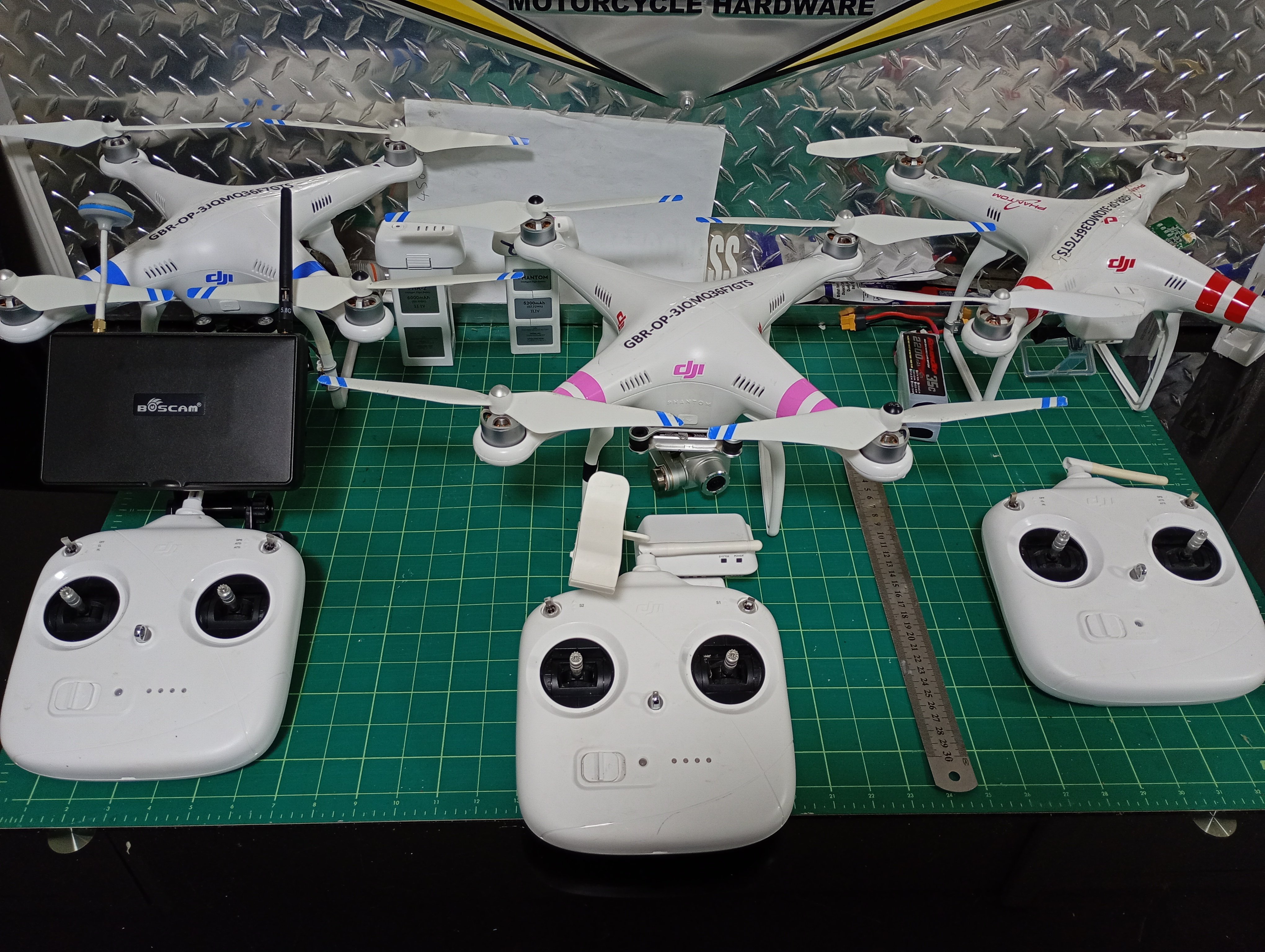

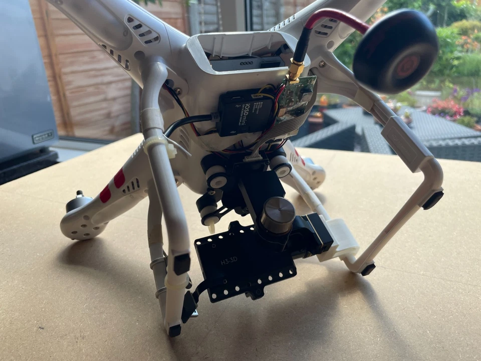

ive took it out and 1 of the motors is toast, real slow and jerky motion so ive just bought another p2 for spares as goin by what you guys are saying, and a bit of reading, im prolly better with a go pro and gimble like my other p2, am i right? if so would i have to get a 2.4 trans as dont the vision run on the 5.8 network? the one i just got has a zenmuse h3-3d gimbal, dji osd, boscam 5.8 transmitter spiro net antenna, it is suppose to be mint with not a mark and pretty much as new, has a bricked battery and was less than £70 delivered, but now i'm in a bind, i have a p1, i love it, i have a p2 with the same as above but has a 2w transmitter with the boscam fpv monitor, its great, now i would eventually get the phole range, so do i just go with the p2 and use the vision for spares? look for another working vision? or is it worth the hassle reshelling and new motors to find i cant connect the original software? i know you guys have been through the motions so any advice is genuinely appreciated
yes a 2.4ghz tx is needed if using 5.8ghz fpv gear, i have the vision app available as an android apk file if needed
first let me say crash1sttime, ive watched loads of your youtube videos, gota say you have a top collection of phantoms and i've learned loads from them, i did download the apk for the android but ive tried 3 or 4 phones now and carnt get any of them to work, then i posted on here and after what captainmilehigh said above, i understand a little more now, ive bought a what i was told a non working drone for the shell, its turned up today and its like brand new, nowt a mark on anything, put a battery it and it fired up and works great, so im gonna keep it as it is and reshell and motor the p2vision and hope i can get it working properly, thanks for the help guys

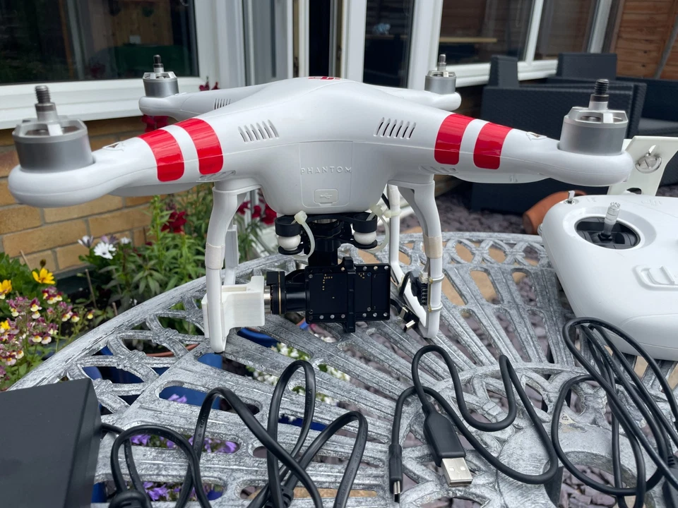

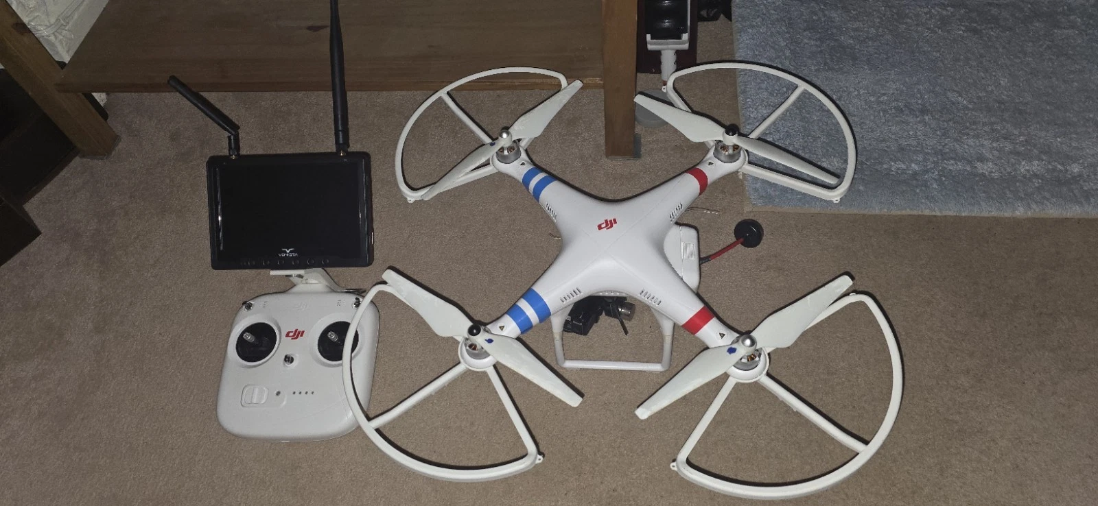

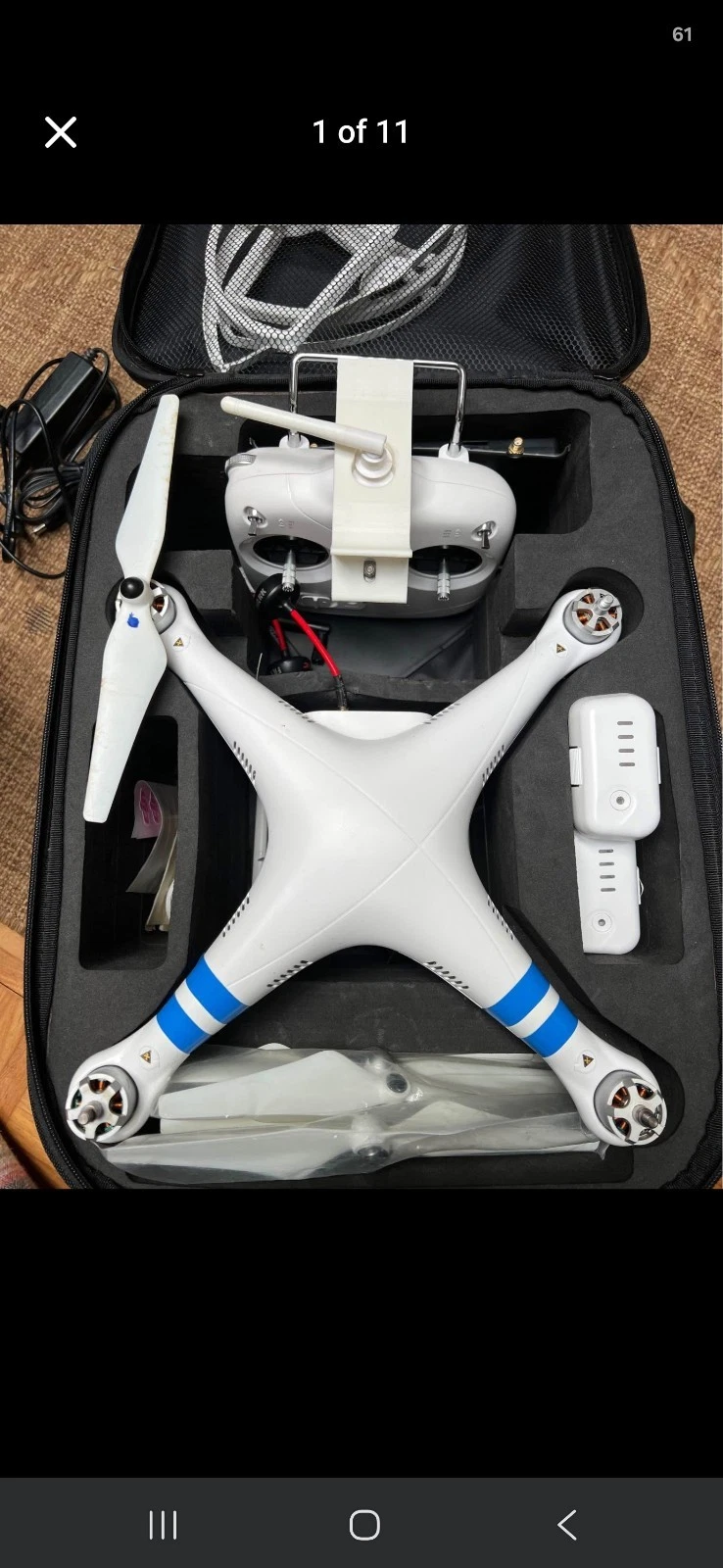

could you great guys help this total newbie with another question, my old man seen my p2 and we spoke a little on the vision, which i really want to get done, well he decided early hours today, to buy one and i'm confused? first can you id it as a vision? it comes with a fpv and monitor, like crashtime said above, there different from the p2 frequency wise, how would i find out when it arrives if its got 2.4 trans, only thing that makes me think its a vision, is he said he will include a lenovo tablet and 2 range extenders so he doesn't have to use mobile phone?

That picture shows a p2 with zenmuse gimbal, so its a 2.4ghz controller. the only way to differentiate based on remote is
NPVT581/PVT581 is 5.8ghz
NDJ6/dj6 is 2.4ghz
If it was ever a vision or vision plus then the controller will be 5.8ghz and the camera was 2.4ghz, you can adapt the old vision to use a zenmuse gimbal as long as you dont try to use the gopro wifi as it was 5.8ghz and would interfere with the controller this was a setup that many used when the silver camera on the vision plus failed, as it was a working alternative, in fact with the vision plus you can use a zenmuse gimbal with a gopro and the Vision app to get video feed and full telemetry data from the quad, you had to manually stop start recording though which was a downside
only way to be certain is to get the quad and open it up
