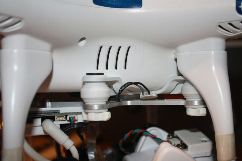

Geert said:
This is how it looks here.
Mine is also not a "snug fit" like in the video.
The frame can go up and down a little bit.
Interesting... My thumb screws also have only two wings as opposed to the four that I see in your pics and on Simon's vid. Now that I know your "four wing" screws are working the same as mine, I feel better about it. :D
I'm going to contact Simon to see if I can figure out what I'm missing here... :shock:
Geert... I really appreciate your taking the time to send me those photos and set me on the right track..
-slinger
The 5 wings on the thumbscrews are the old style, the new ones have only 4.
I still have the old ones too but not using them of course, just keeping them as a spare.
Geert./.
Geert:
I guess you could say mine have four, though two are kind of stubby... :D
Here's how mine look. Pretty much like yours...
