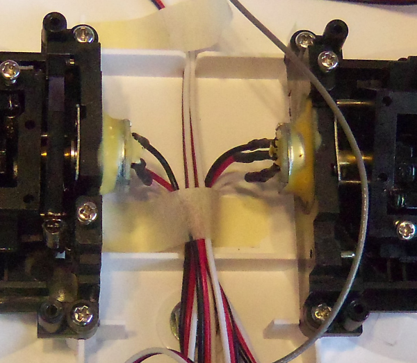

My SR6 controller works like yours Caupwhiting I believe that is normal for them
I just placed an order for the part. The photo shows that the part is missing on the right.
