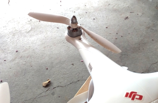

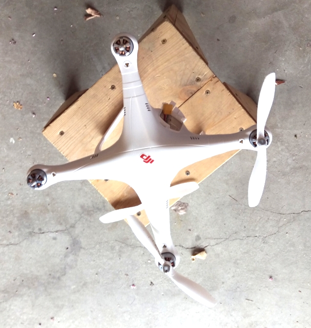

Alright, today was the day to try and fly it. Powered on the controller and when the light was solid red. Oops almost forgot, and pushing both switches up, I installed the battery. Let the drone go through its warm-ups until it blinked 1 green then a series of green. Started the drone and took off. I hovered for a second or two then one propeller flew off and it came down on the driveway. I did not find the prop that came off. All in all I consider this to be a successful first flight. Need to make sure the props are tighter than just arthritic finger tight, LOL! Thanks to everyone who helped me get this thing in the air. I'm going to need more propellers.

Be sure to put them on the right motor clockwise and counterclockwise there marked..
Glad for your first flight, try to get out where you can't crash into anything for learning
to fly and give it throttle quick, they tip over if you take off to slow! Good luck keep us
in the loop!?
