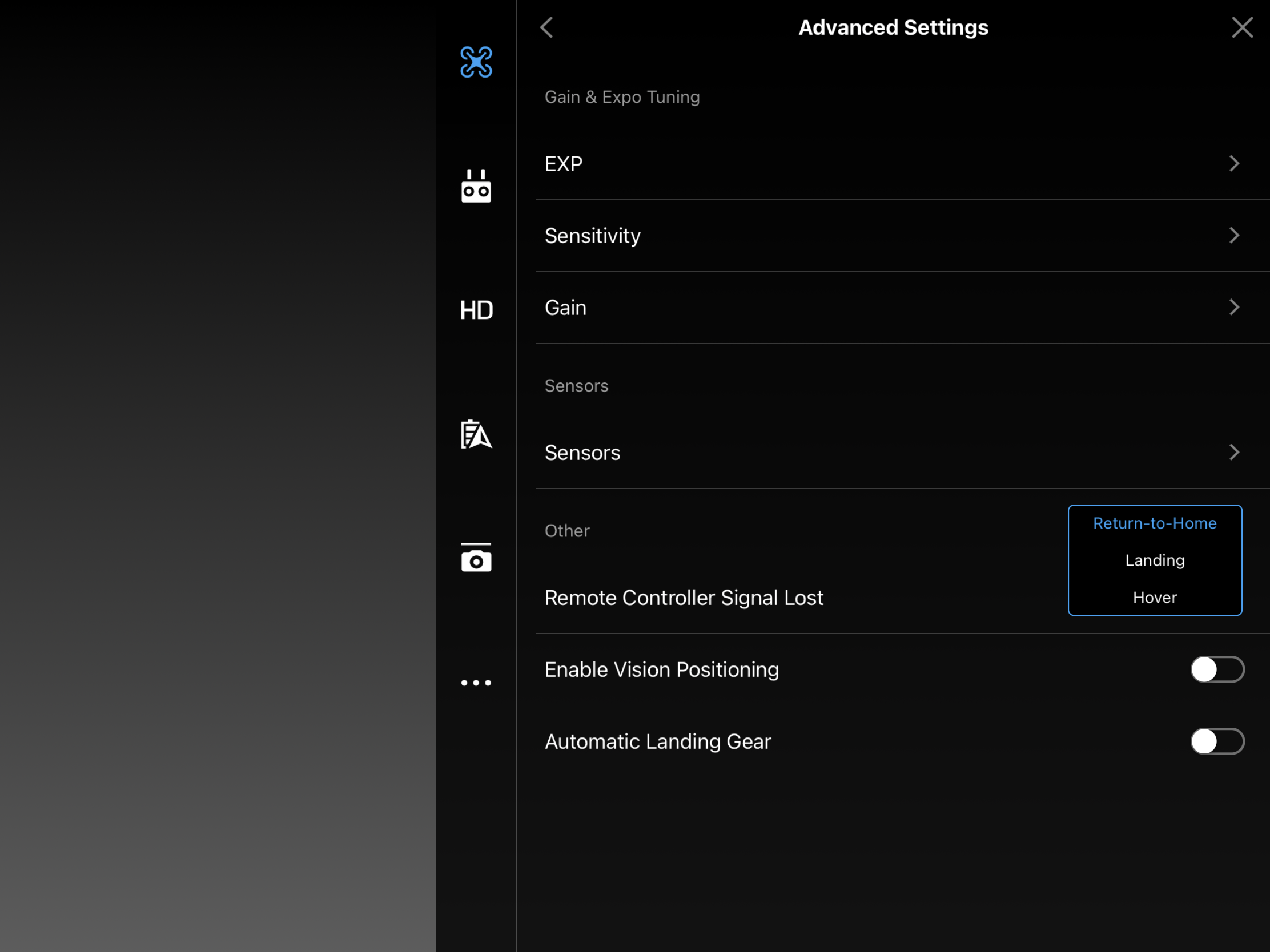

Look here.
Yip under advanced settings,,,,rth,,hover,,landing,,,yours must be on hover

My guess would be you have it set to “hover”.
Change to “return to home”.
Pull up a chair and your favorite liquid in a glass and go through the app settings. They can be hard to remember where they all hide.
I still do a bit of searching myself.
Beat me to it,sorry for the repeat

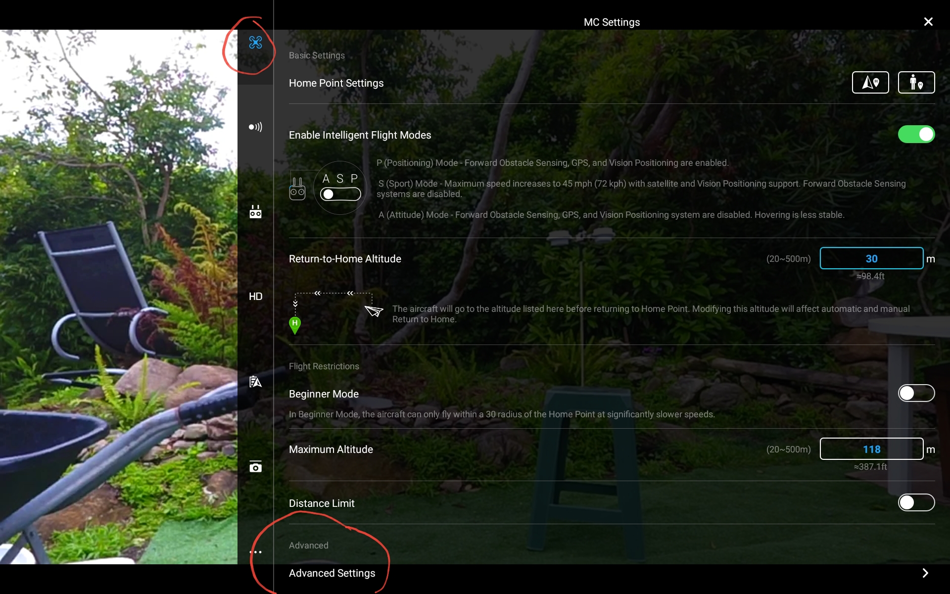

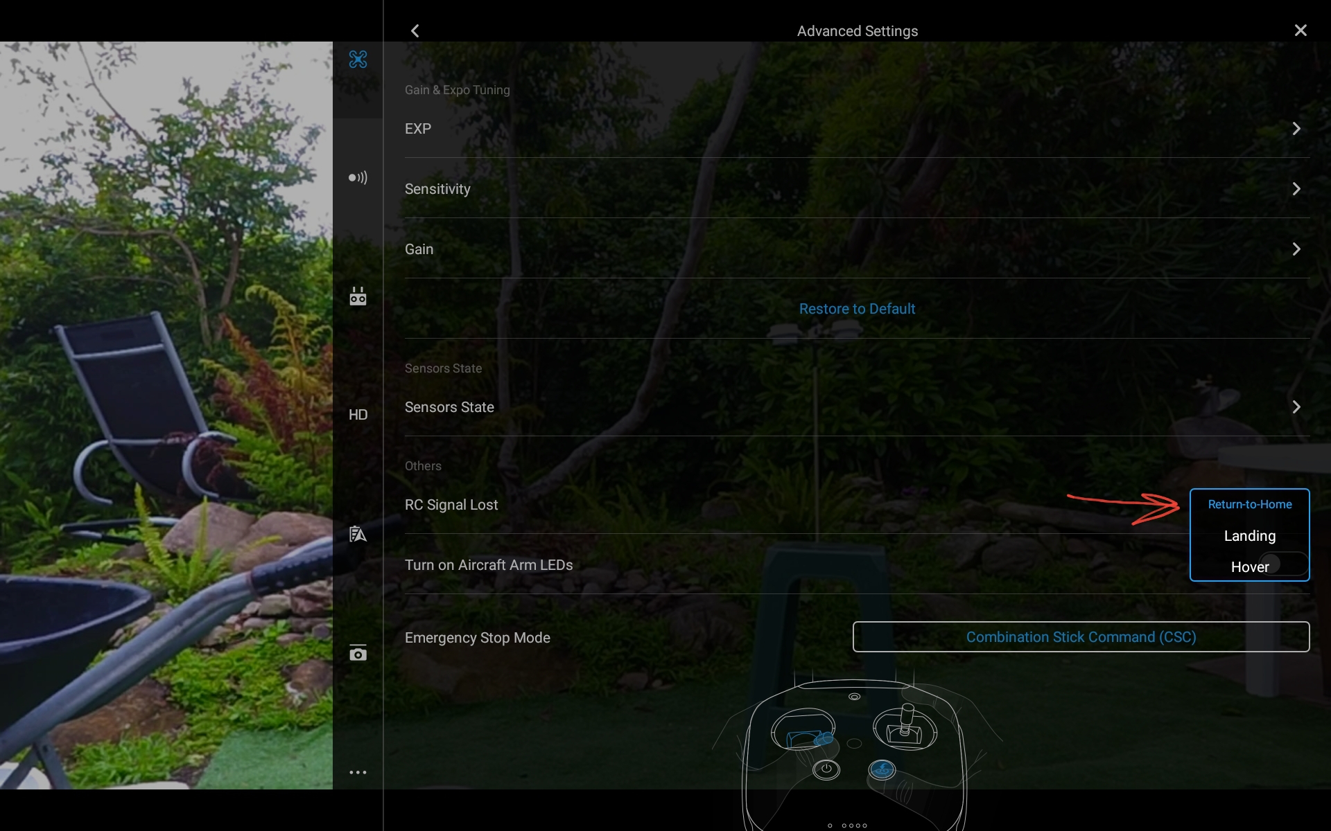

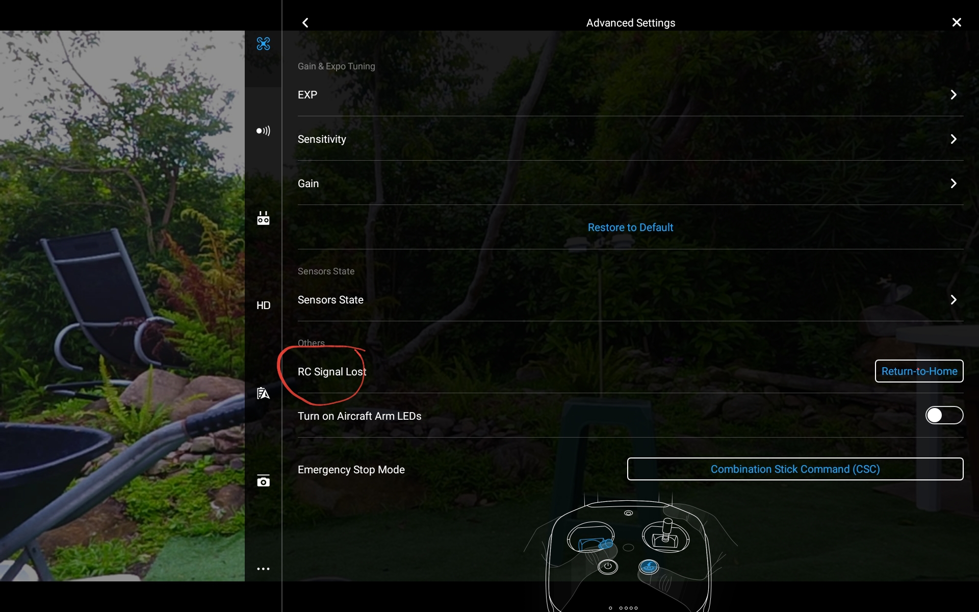

So where is this setting,this is only place in my settings where it mentions these options,,I know of 3 sorts of rth,smart rth,loss of signal rth,and manual press on button,,is that right ??if closer than 20mtrs rth will just land or hover ,,correct, even in my home point settings,it say aircraft return to take off point,,,is there more settings ??where ,
[correct, even in my home point settings,it say aircraft return to take off point,,,is there more settings ??where ,
[/QUOTE
Adv settings, signal lost, (return-to-home). Tap to select other choices rth, hover, land
