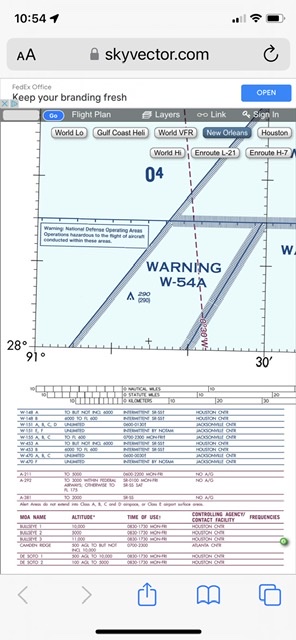

@DoomMeister Once again thanks for your help. This brings me back full circle to my original question. The sectional chart for A-292 has a caution of high volume of aircraft from surface to 17,500'.
Aloft has an effective time frame and a level of Low Altitude Only. What does Low Altitude Only mean since A-292 is SFC to 17500'? Can I fly a UAS in A-292 during the Alert area effective times?
If I did not have Aloft where on the sectional chart or any FAA publication would I get the information that R-xxxx areas are no UAS fly and A-xxx is permissible?

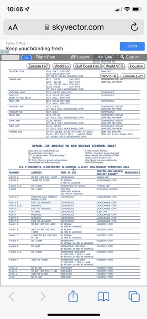

Refer to Chapter 15 of FAA-H-8083-25B. The information it states can be found on the back of the chart is now in the margins on the front due to keeping digital and paper versions consistent.
Another difference is it states that in Alert areas both pilots are equally responsible for see and avoid. That is for crewed aircraft. UAS pilots must always see and avoid crewed aircraft.
Contact with the listed Control Agency must be by phone as contact by radio is only permitted from/to crewed aircraft.
You can get airport data here https://www.faa.gov/air_traffic/flight_info/aeronav/digital_products/dafd/search/ that will have contact data for the airport. Enter the 3 letter code like JAX for Jacksonville Intl. and then select the small pdf at the far right in the resulting search.
These are the tables found in the margins on the sectionals that describe the SUA areas on the chart.

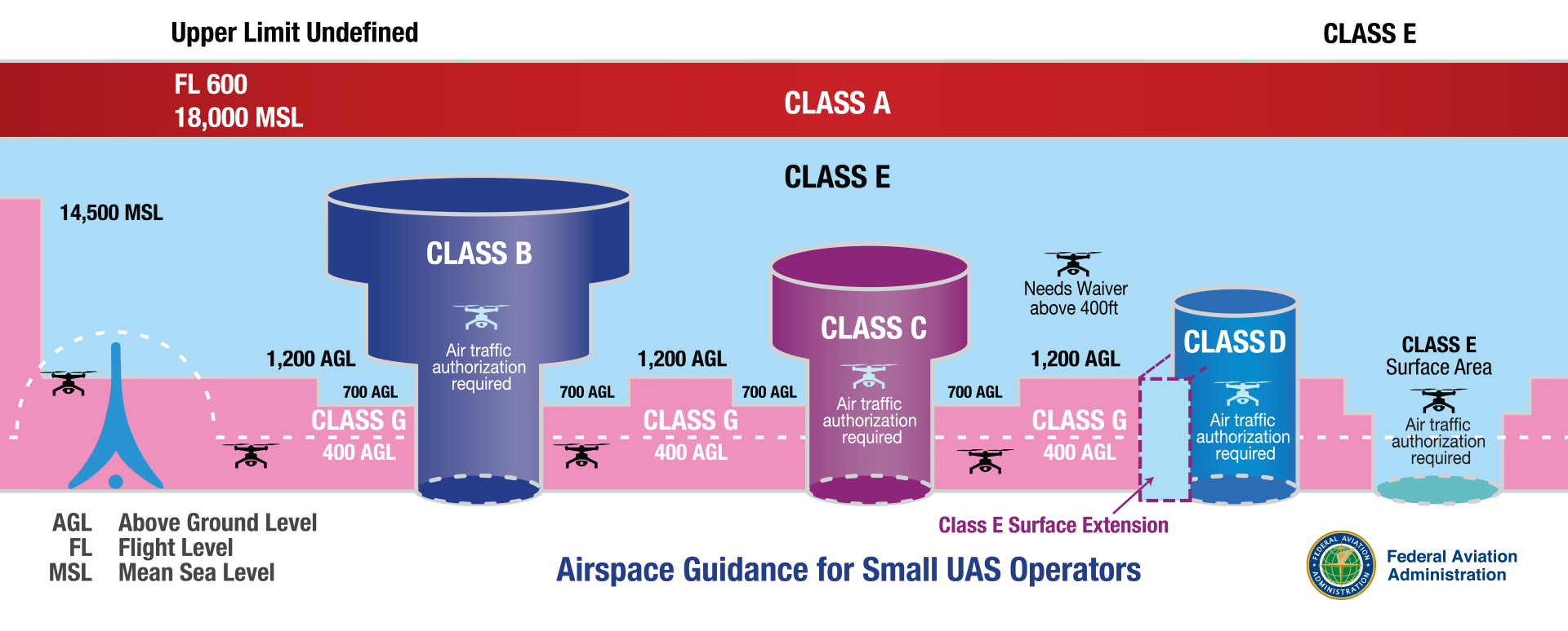

This is a great reference slide the FAA did fairly recently.
That is a good graphic for §107 certified pilots. The issue with recreational pilots are they must stay within 400’ AGL even when obstacles are present. They are not allowed the 400’ over within 400’ of an obstacle as allowed in §107.51(b) as shown in the graphic for the obstacle on the left side.
It is a surface extension to the Class D airspace and clearance is not required. The 400’ AGL line should have penetrated it up to the Class D. If you use the link for the Class E I posted you would find it to be type E4 which doesn’t require authorization.
