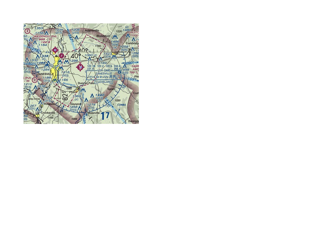

Uh, no. Confusion in only that not many people have never heard of "lateral boundaries". Pilots included. There is no 107 rule about flying only in uncontrolled (Class G) airspace. You won't find that word ("uncontrolled") in any of the rules. What you will find in 107.41 is:
"No person may operate a small unmanned aircraft in Class B, Class C, or Class D airspace or within the lateral boundaries of the surface area of Class E airspace designated for an airport unless that person has prior authorization from Air Traffic Control (ATC)."
Take a look at the sectional pic I'm including
The dashed magenta line show the surface Class E airport area for the Zanesville airport in Ohio. The area is inside the normal 1200 / 700 AGL transition area around the airport.
To re-iterate, there is no rule about flying in normal Class E. It's just that in 99.9% of the cases the bottom of Class E is higher than the normal 400 AGL limit. When you are within 400' (laterally) of a structure (and in Class G) you may go up to 400' above the structure, even if that would put you into Class E.
View attachment 93243 The dashed magenta line show the surface Class E airport area for the Zanesville airport in Ohio. The area is inside the normal 1200 / 700 AGL transition area around the airport.
I agree - but you misunderstood my point. The reference to lateral boundaries caused confusion because it has led many people to think that they may not fly under 700 ft transition Class E. You may be correct that they chose that wording quite deliberately to permit flying in non-surface Class E (e.g. around a structure), but the confusion, as evidenced by multiple posts on these forums, was real. Hence the (correct) statement that flying in Class G never requires authorization is simpler to understand.
