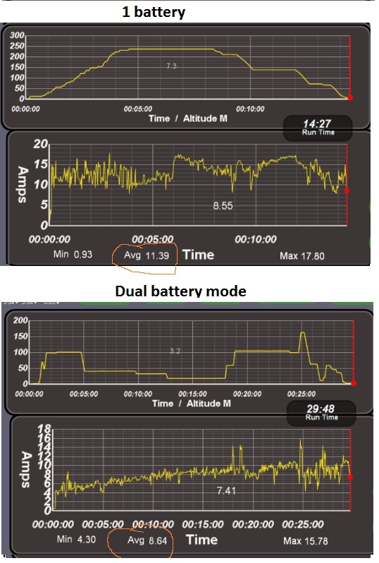

Below picture of datconverted log of a single battery. Flight that lasted 14minutes. Average amp draw 11.39 from motor start to motor stop.
And a dual battery mod.2x 2400 mAh. Flight lasted 29minutes. Average amp draw 8.64 from motor start to motor stop as logged in the Dat and converted with Datconverter.
The two additional batteries are connected at the outputs of the stock battery's + and - terminals (so in the stock battery). Clearly this shows that current is being measured before the connection of the 2 additional batteries (as in reality amp draw should be higher with a dual battery mod) . So current sensor must be in the stock battery and not in the aircraft.
You mean higher because of the added weight? It should not be that much higher going to the motors. If I understand you correctly the two additional batteries are in parallel with the stock battery, so unless the current sensor is in between the stock cells it should be the same. If was in between the stock cells it should be about half...also the flight profile looks pretty different....but you could be right. I noticed in the .txt files I have been studying that current is available in the center. and not smart battery heading....which leads me to think it is not from the smart battery....but again could be wrong...
Can you send me links to the .dat files? I am curious how the remaining capacity looks for the dual battery mode. I expect it to follow current integration with period corrections because the voltage doesn't drop....
