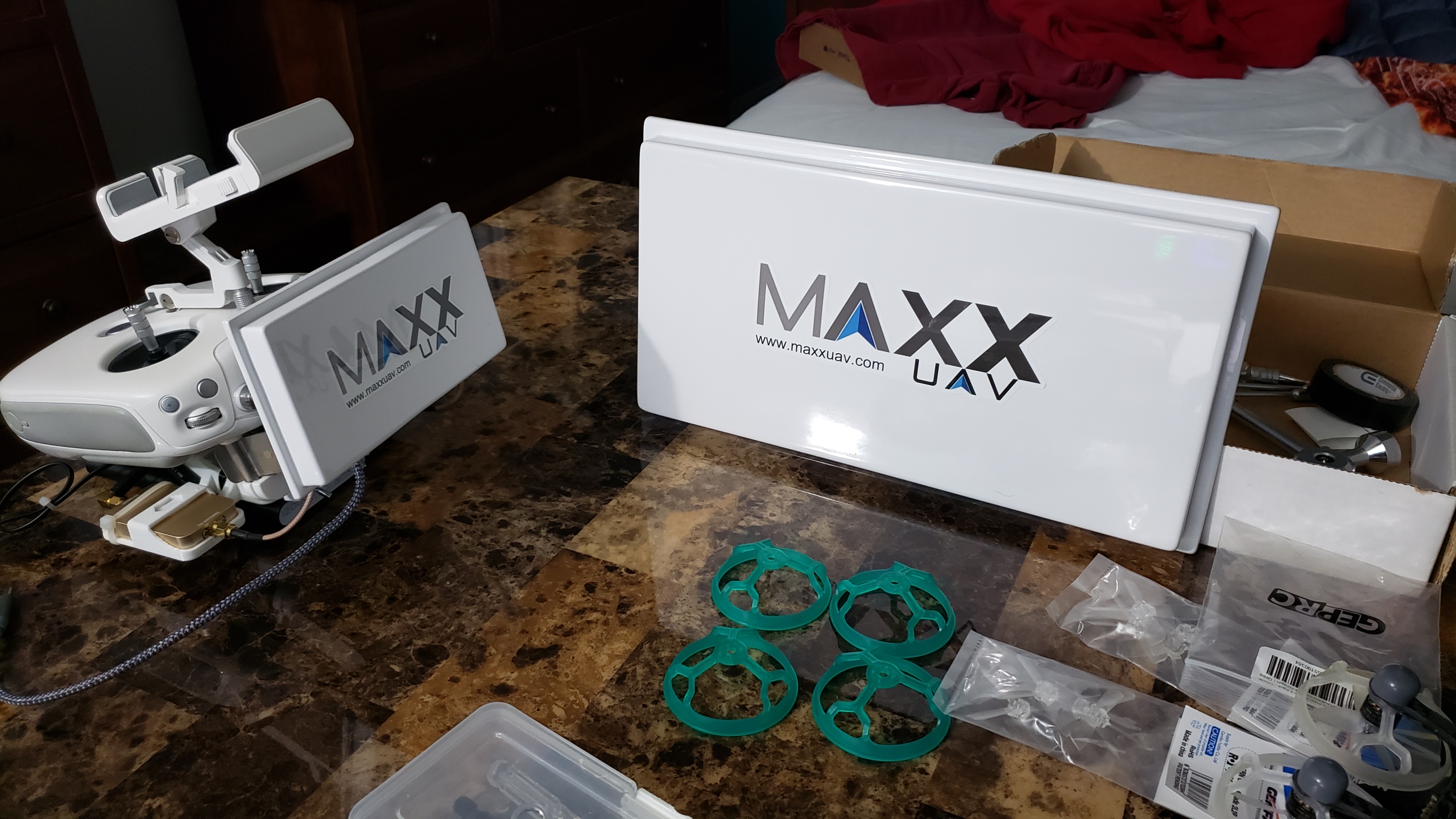

Hello Everybody! I am having an issue with my amplified panel on my P3Pro. The antenna kit was purchased from Maxxuav. For years I have had no issues, but now both amps cut out about 30 seconds after turning them on. The little indicator lamps on the amps go out. The battery seems to be OK as I have charged my cell phone with no issues. I bought new battery anyhow, and the amps still cutout. I tired both amps one at a time to see if it might be one bad amp... both amps cut out when hooked up separately. Any ideas what may be causing the amps shutting down ? I checked the wiring and it seems ok. End of amps which say "Radio" goes to the transmitter. End which says "Antenna" goes to the panel antenna.
Edit: I tried both panels. The huge one and the smaller panel. Same outcome with either antenna.

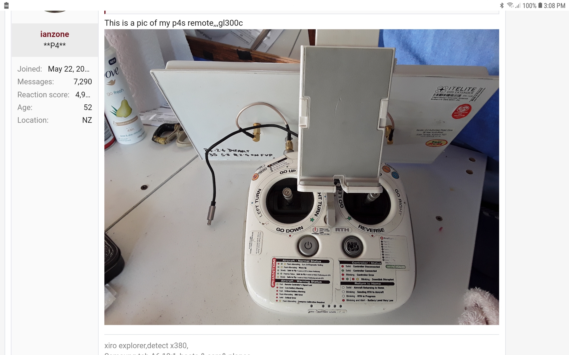

Yeh sounds like they need to be checked or tested,,here's pic if my old remote
Same panel and it was one of the best upgrades I done,,never flew to far but signal and transmission was just outstanding as to why I never bothered with the amps,,remote was heavy with the tablet,
