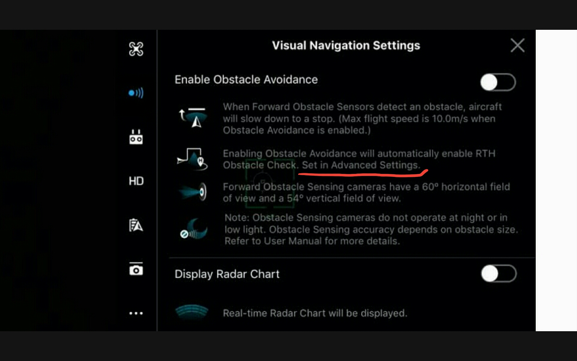

Could have look here under advanced settings where I under line it,,,hope damage not to bad,,that sux,,hope this can help you....if OA was it will not avoid ,if extremely bright sun and it was on it might not see it,,,,
