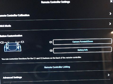

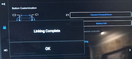

I flew a short mission tonight and when I returned home, my controller has a solid red LED and 4 whites. I know the battery is charged but the red is solid when power on. I know from pages 41-43 in the manual the RC is not connected to the aircraft. I have tried C1, C2, Record buttons with the right wheel but nothing changes. I have tried linking from the RC and it shows Linking complete but not to the aircraft. I have tried both Crystal Sky and my ipad. I am not sure what to do next.

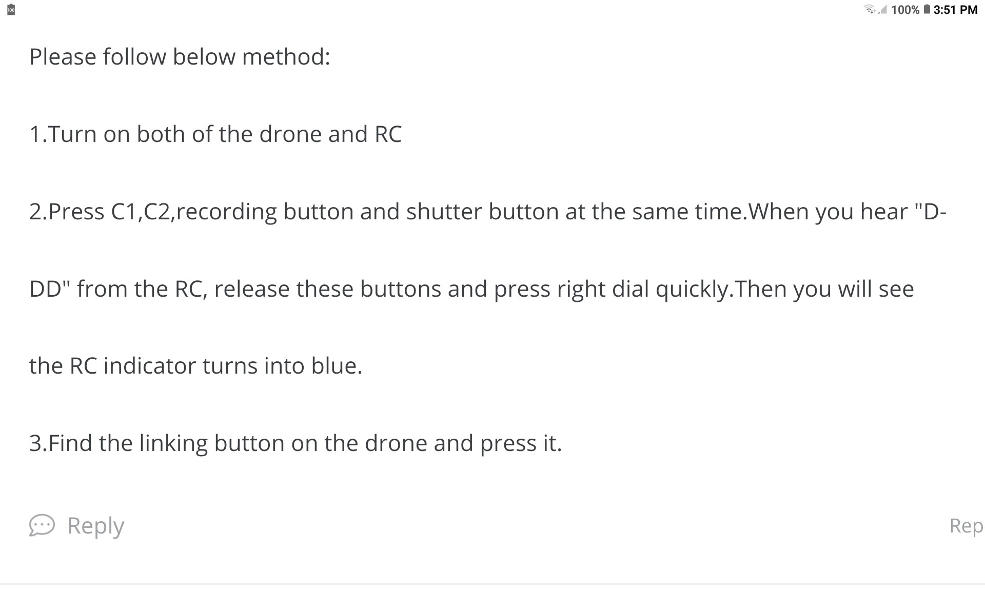

What colour is drone link light red or green,,,you method is close but cam wheel button aswell
thanks for your response.
Drone link light is red.
I did the buttons and got the D, DD beep, pressed the right dial quickly and let go, but no blue led on the RC.
When I do all 4 buttons, I get no beeps, only when I do C1, C2 and record, then I get the D, DD. But still no blue. ☹️
