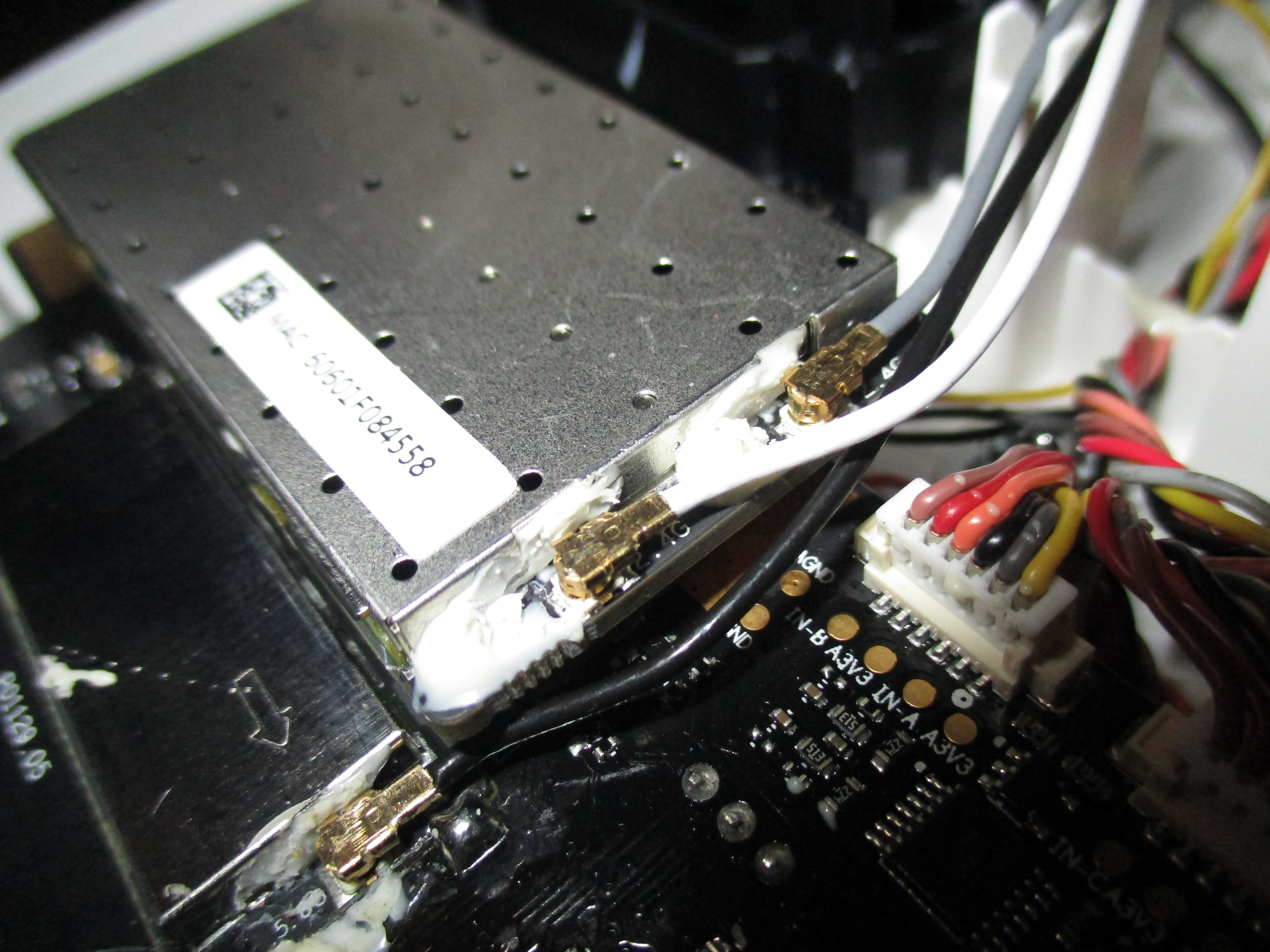

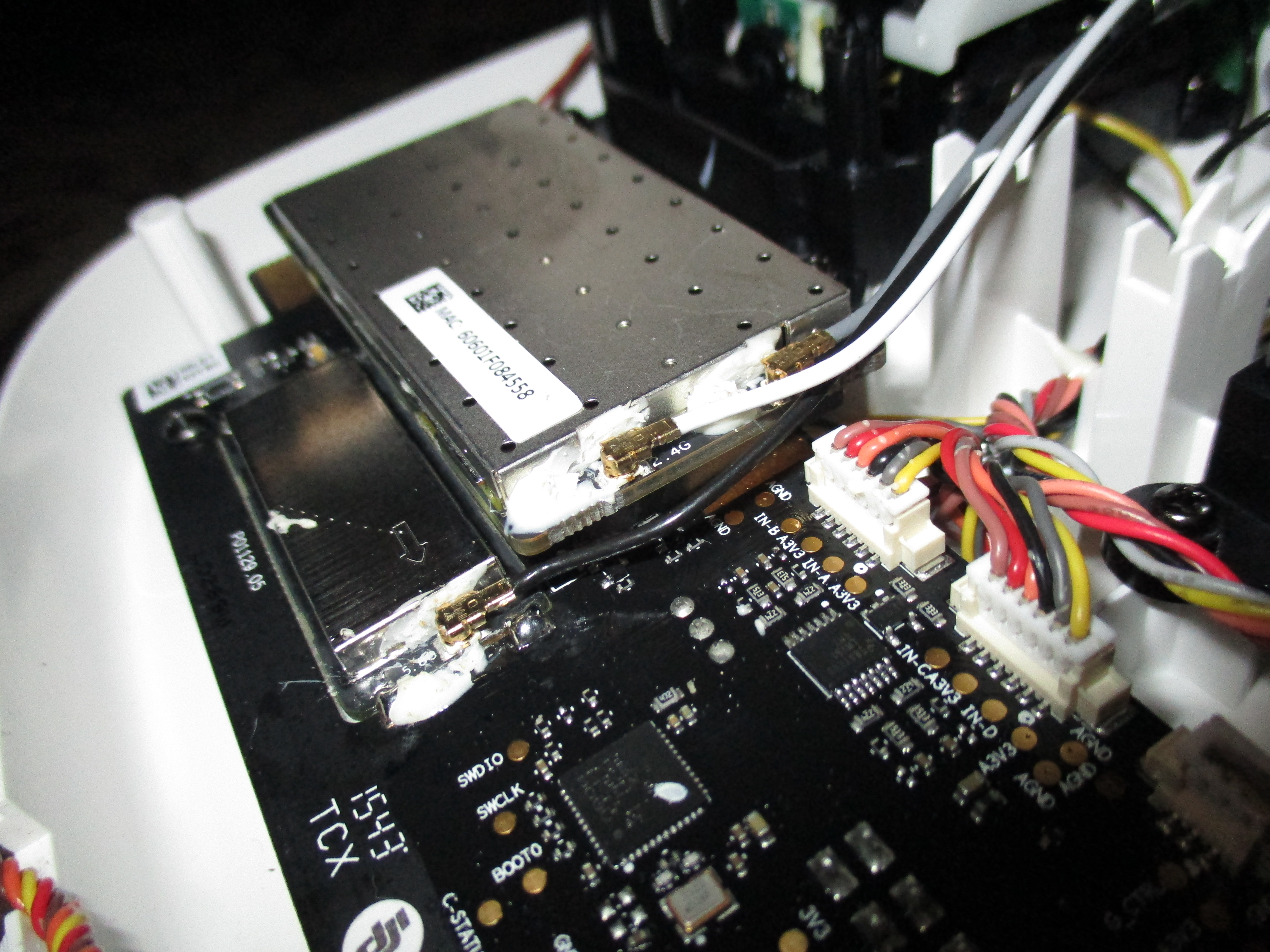

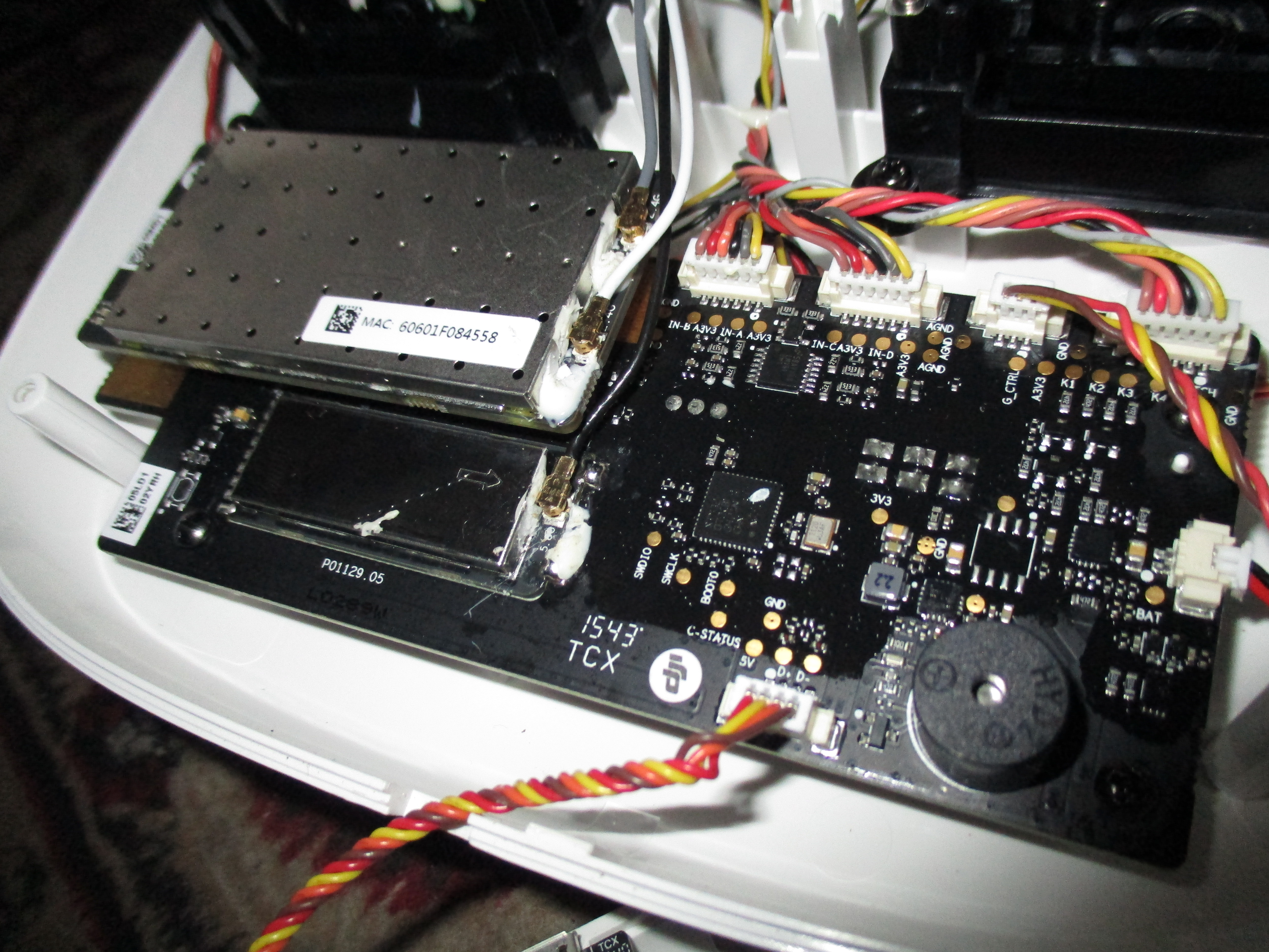

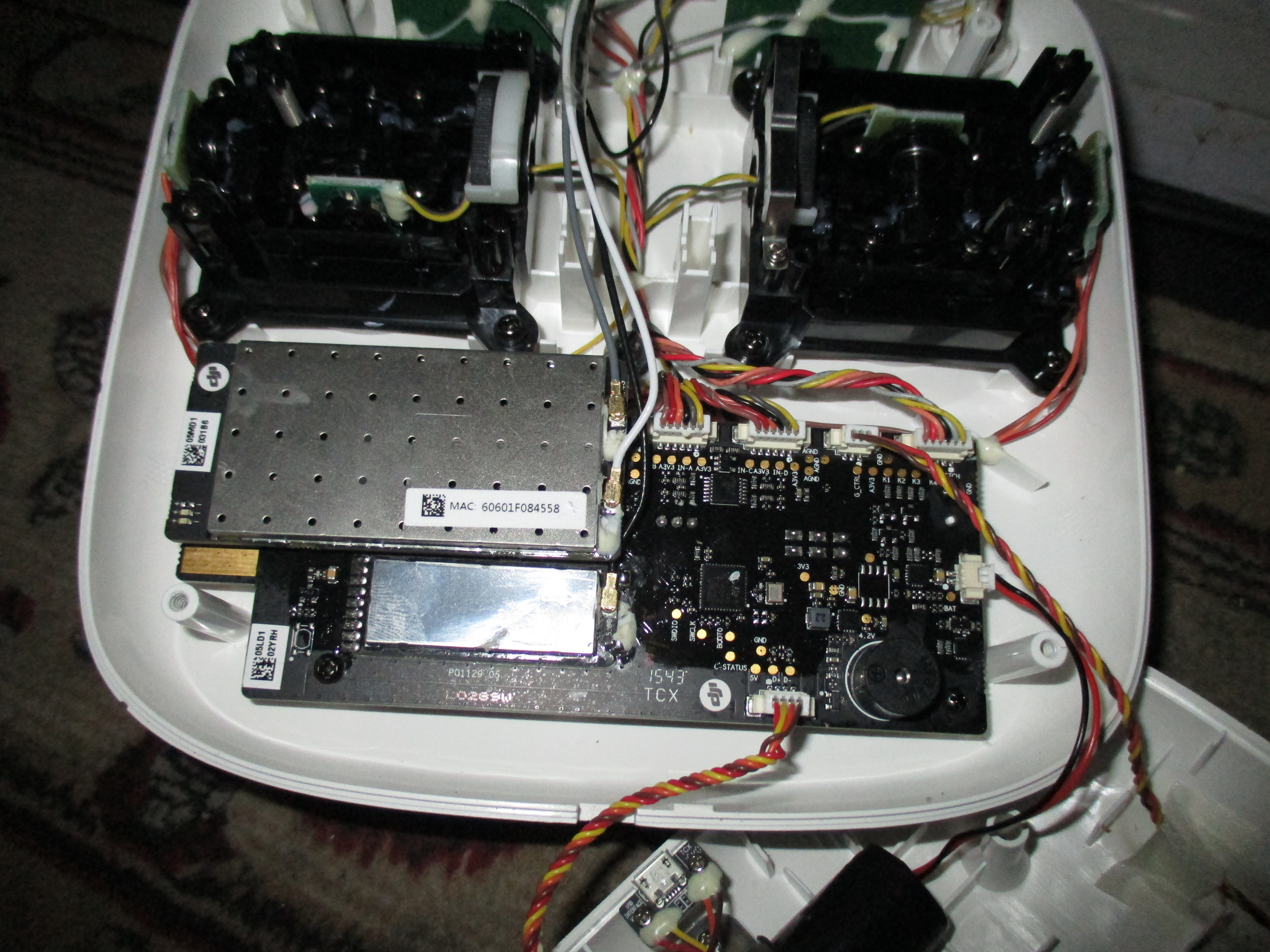

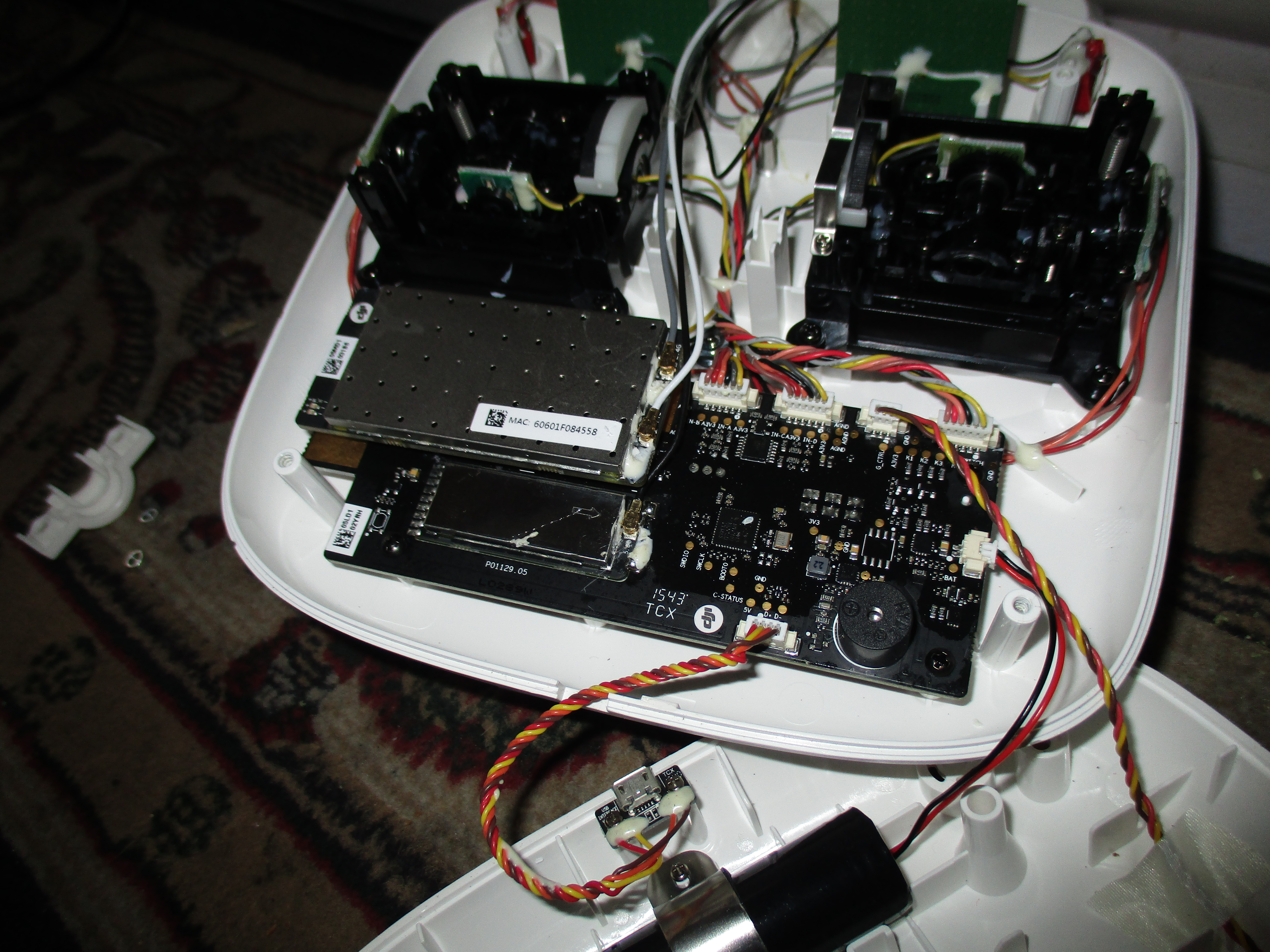

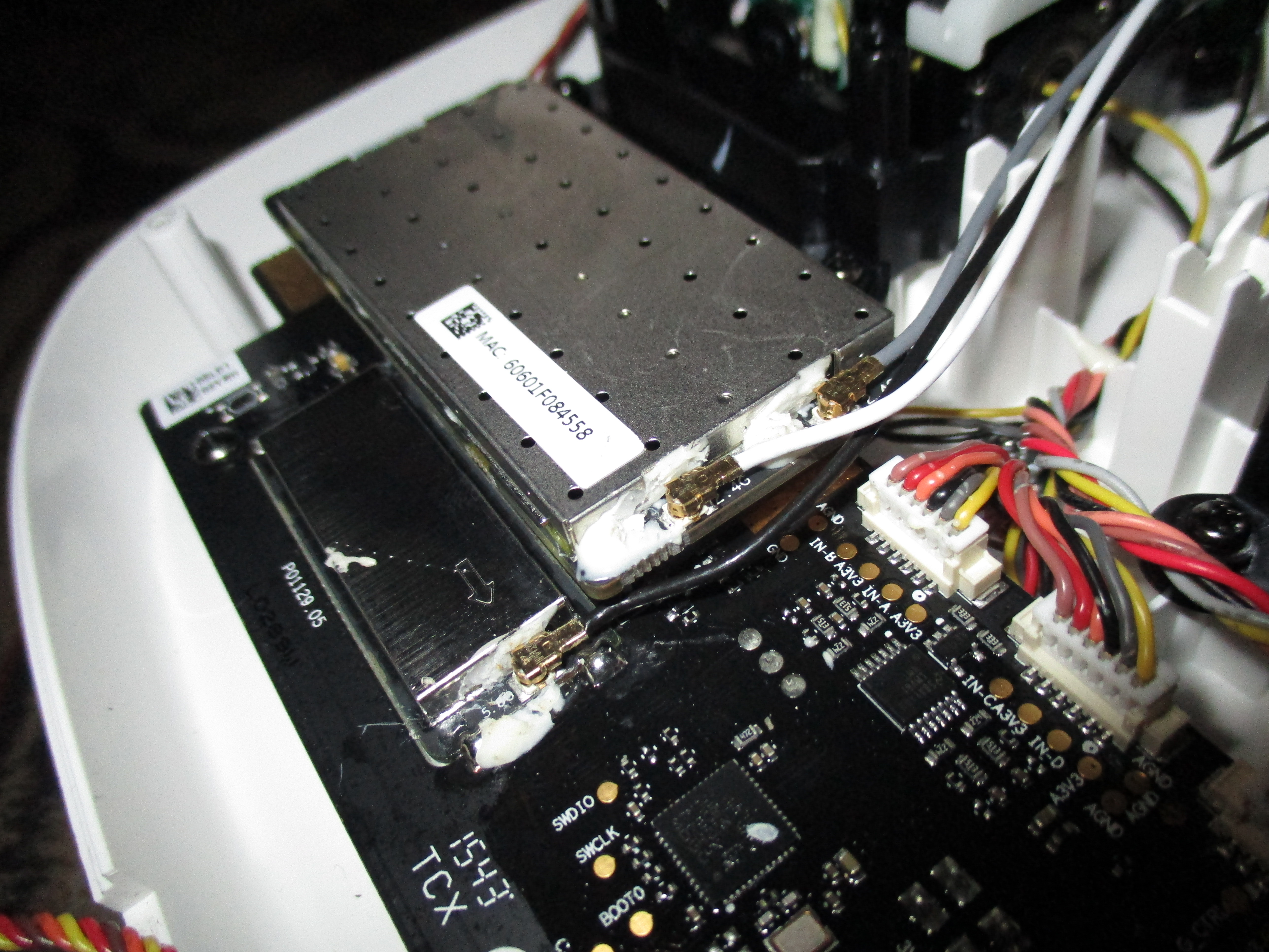

I think something is wrong with your remote control. And that can be the connection to the antenna. Re-open the remote control and check your connections. Often a connection error occurs at the connection to the printed circuit board.
Check all connections again and (if possible) take a photo of it (so you can also give us a look through this forum).
Reactions: Turboshed
I have opened my transmitter but everything looks ok, the antenna connections look ok.

pics as requested.
pics as requested.
Thank you for your photos. I think your antenna is not correctly connected. My advise to you is disconnect the connections again, clean the connections well (but always carefully) and reconnect them.Use a little of connection spray on the wire (not on the board). Then apply an insulation over the connection (using a glue pistol, for example). It is intended that the inner pins fall into each other.

When I fitted the ARG to mine the connectiors fell off the printed circuit board and left me with no range the only fix I found was to buy a second Hand transmitor from eBay as spares seem to be impossible to come by
