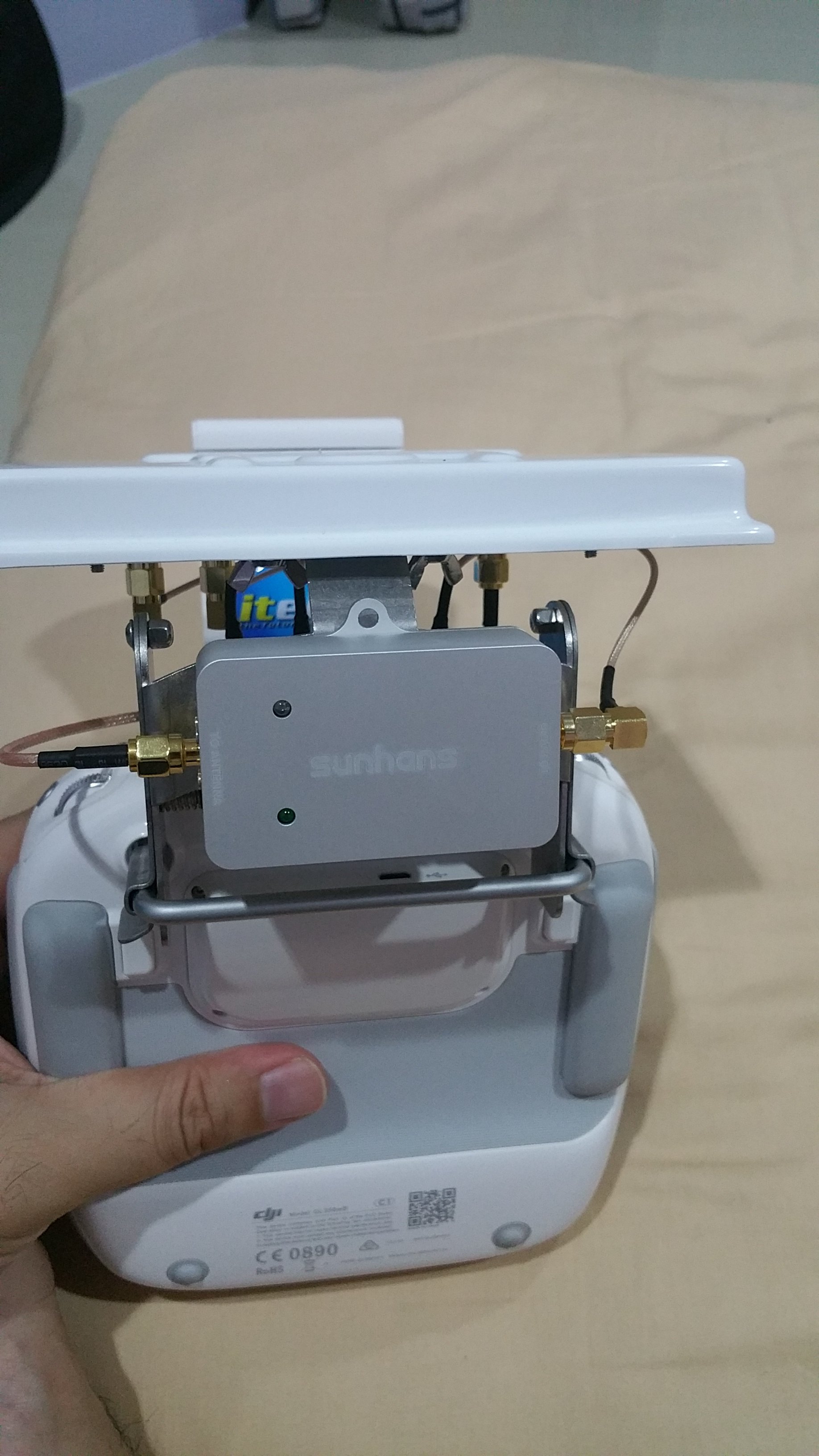

ok, so if i want to use usb with powerbank, then i need to solder the cable to the otherside, where it's write 5v? and wich th epositive and the ground? same like 6-16v? soírry for my unknowledge... :)
This is the way I connected it for the test purposes, I hope this will help to clarify it, finally I have removed the whole transistor board as it is useless if you use 5v power
Ok, now clear... But maybe i will need help when it's arrive.... :) Thx a lot!
Is the connector in amp sma or rp-sma and f or m?

I just wondering, i need to solder my powerbank to 5v output, beacause its an output, right? Or not? i don't know, i just asking it :). So if i solder there, i dont need the oppsite cables (6v)? i can leave it empty?
Which usb do you use on power bank? 2.1 A or just the 1A?

For the absolutly clear can you share some photo every angle from your rc? Thanks a lot!
Sorry for a bad video quality, hope you get the idea. I will test it deeply tomorrow.
