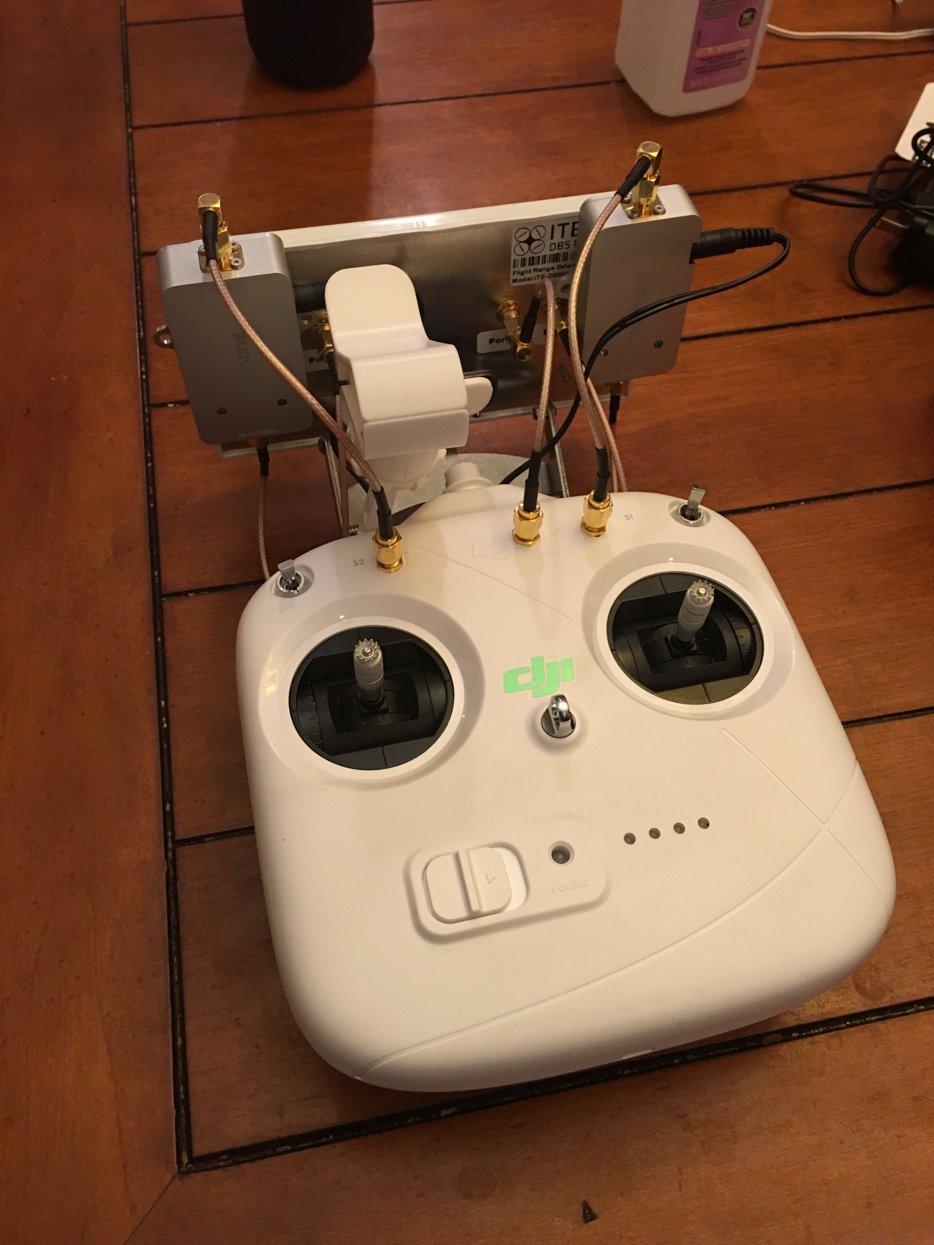

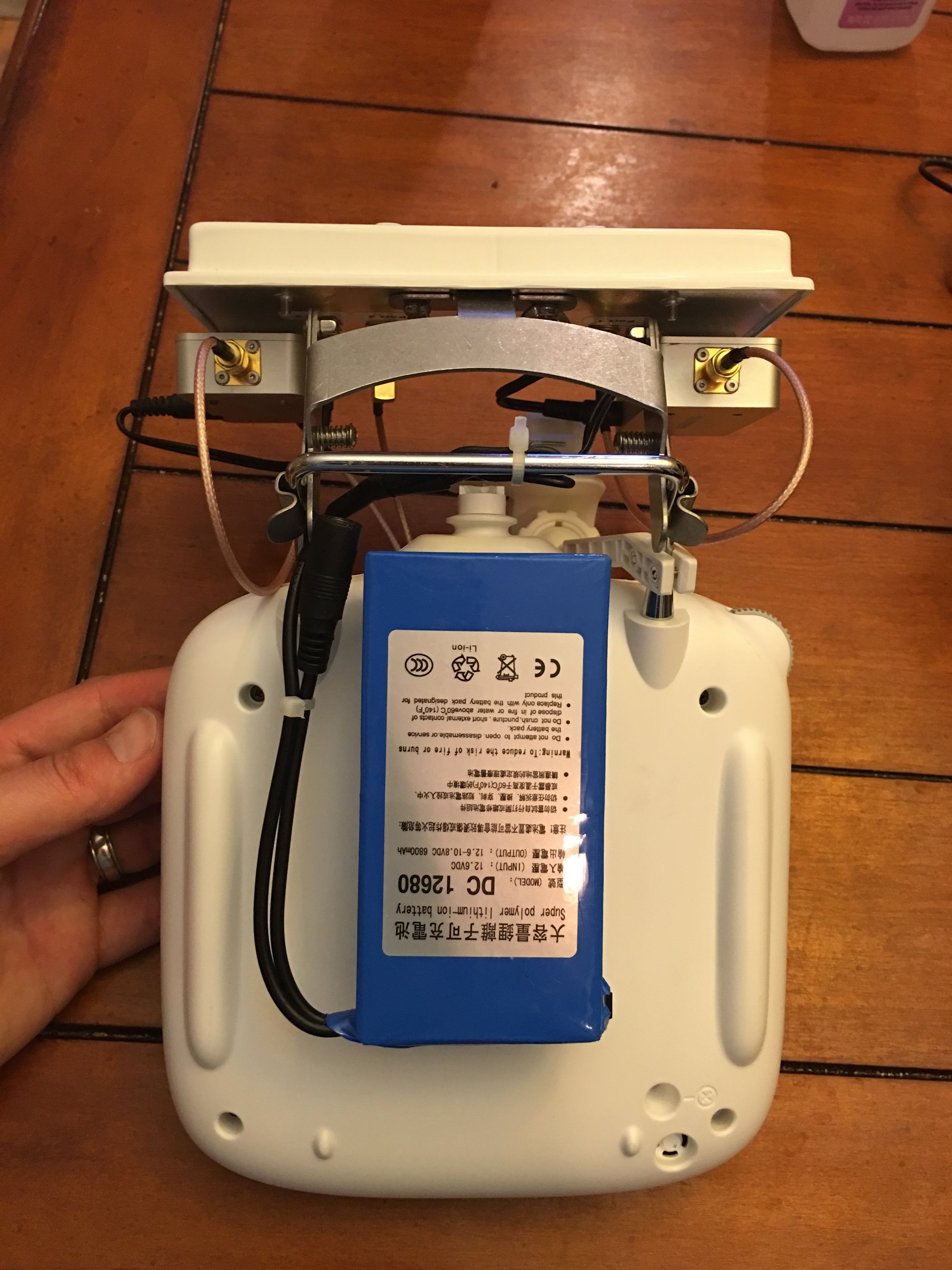

View attachment 61376 View attachment 61377

Thanks for the pictures! Really am considering getting 2 amps as well... Did they come with the necessary cables? Or did you have to buy extra ones (between amp/dbs)?
Not sure how I'd power them... how do you check the remaining voltage of the lipo? If you go below a certain voltage, won't that damage the lipo?
Yes the Sunhans amps came with the wire needed to hook into the controller and DBS. All good there.
It also had the wall adapters which I needed to cut off the plugs; then I spliced the two plugs together and into the power line from the lipo. Soldered it up, used shrink wrap to secure, and good to go.
For the lipo voltage, it's one of my complaints with the battery. It does not have the typical lipo matching cable where I can plug in a checker. And the battery itself has no built in meter.
I've toyed with the idea of soldering in a voltmeter and mounting on controller.
I've also considered getting a different battery pack that shows power level.
The good thing about the 6800mah pack is that after a flight or two it barely uses any juice. I charge it every 1-2 flights to keep it topped off. I've read that the charger is a red light when charging; but it's always green but a little redish when I plug in. It's weird, but seems to work.
If I do keep this battery, I may just put in a deans style plug so I can charge with my RC lipo charger. That will show voltage and keep charging within safe limits. I think the battery itself had a cutoff built in so it won't over discharge.
