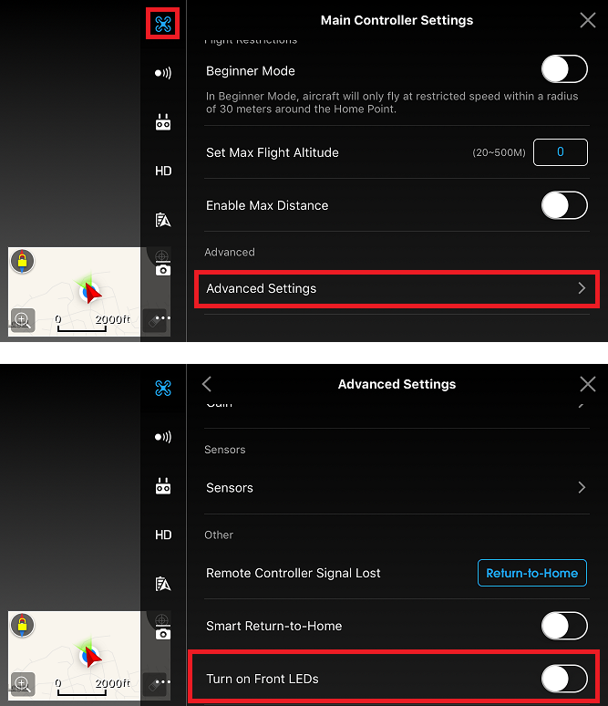

You can only turn off both of the front lights. You'll find that setting in the following section of DJI GO:
Can drone lights be individually turned off and on during night flights?
