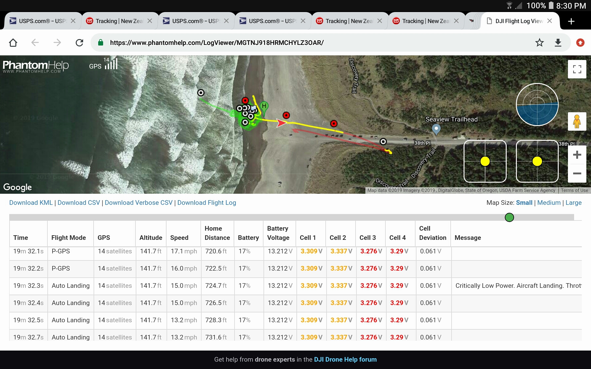

Hey guys. I was hoping you guys could give this flight log a look and tell me what you think. At the end of the flight I was watching the drone and missed the on screen motor overloaded messages. I didn't realize something was wrong until the lights started flashing red signifying a landing. I feel stupid looking at the flight log watching the voltages drop, but I couldn't get it landed in time because I had to do a hand catch because it was over sand. The drone completely lost power, dropped, and now two main motors and all of the gimbal motors are full of sand and unable to move. I charged the battery to 100% just 30 minutes before flying and nothing stood out from the 100s of flights I've had before this one.
Anyway here's the log. Is the anything I did wrong besides missing the motor overloaded warnings/not landing soon enough?

Um,,Yeh that sux,,,I can't work these out proper,,just looking was your smart return home on ?what was your critical battery alert set at,it definitely auto landing from not having power to get back

Critical low voltage is anything less than 3.3 volts per cell, and the drone will want to land when you get to that level because if you push it beyond that, it probably won't be able to land and will fall from the sky.
You hit that at 19:26.8 with the drone 500 feet away and pushed the very sick battery by forcing it to climb (which drained it even more).
That caused the warning: Motor Overloaded. Aircraft will decelerate to ensure safety.
In a flying machine you need to take the fuel gauge more seriously than you do in your car.
20% = zero.
Yes, no issue at all. It is completely pilot error.
